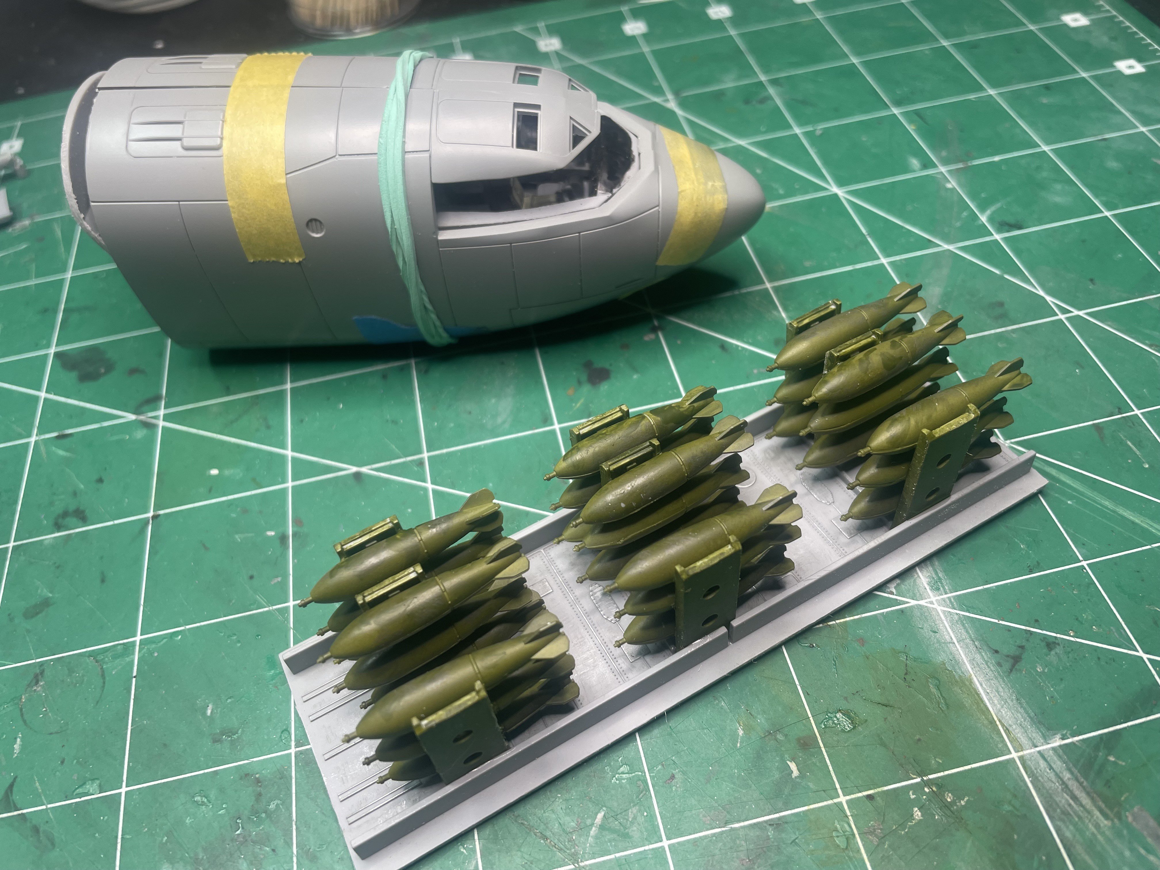

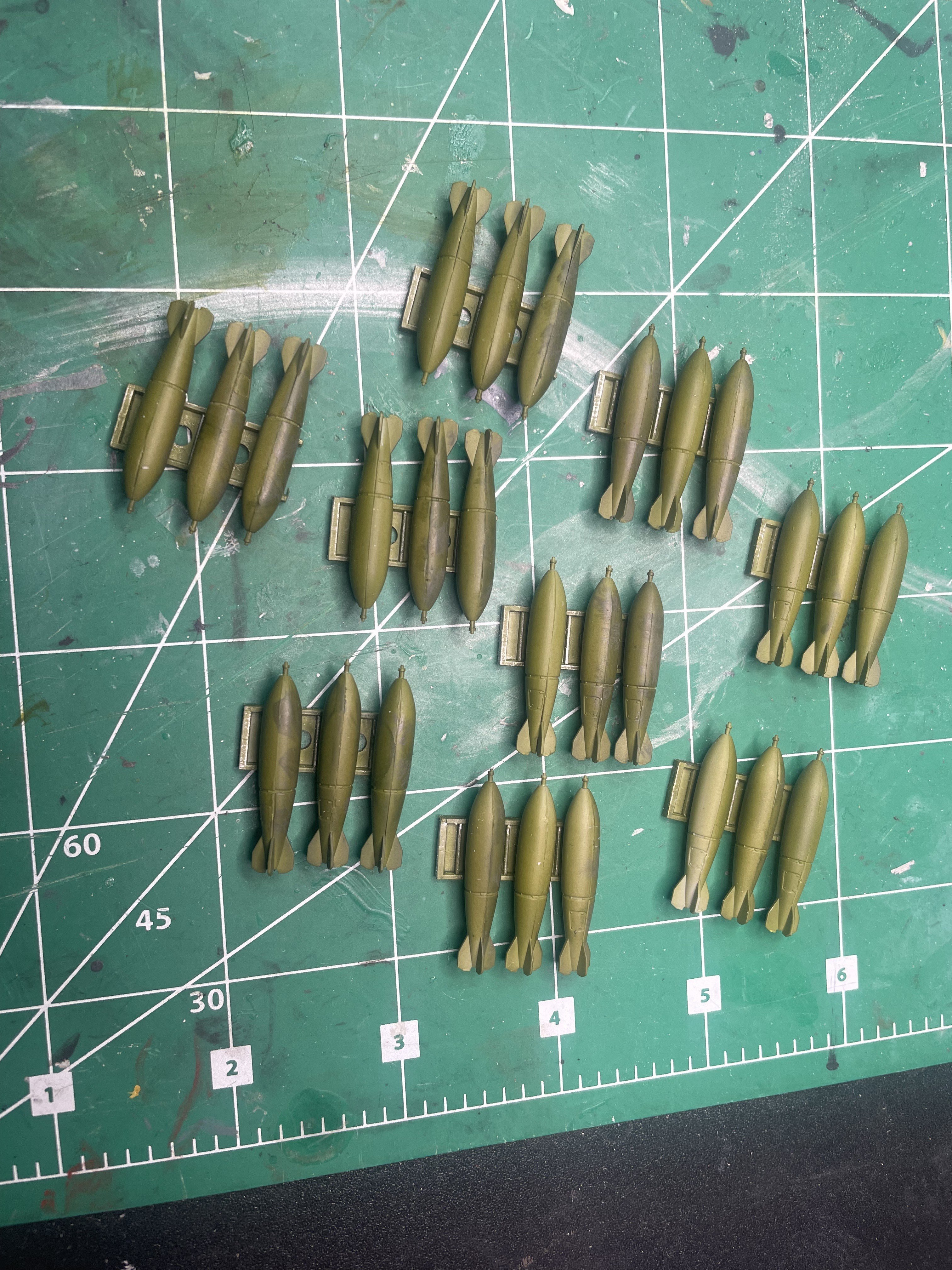

I'm still a bit unsure about not displaying the landing gear, but for now, made progress on the bomb bay.  Why the Italeri shows nothing here is beyond me, but at least this kit has the complete bomb set up.  Again, not the same bombs shown on the box.
First step was to get the bombs onto the racks.  Easy, right?  There is nothing to show where the bombs should be attached to the racks.  And the bombs themselves rest against the side rails - there is not even a pad for them to be attached to the rail. I kind of guessed where the bombs would be relative to the rack.   I used medium CA and hope none of these come loose because if they do, OMG what a PITA that will be to reattach!
Here are the racks installed in the tray.  There was nothing in the instructions to remind you that three of the racks need the bombs to be pointed in the other direction. (the row at the side of the rack towards the bottom of the picture).
and with the bulkheads attached.  This assembly fits perfectly into the main fuselage.  However, the curve of the fuselage means that next to nothing other than the bombs will be seen.  Hence, and you can't see it, but the light weathering I did in the bomb bay is moot.

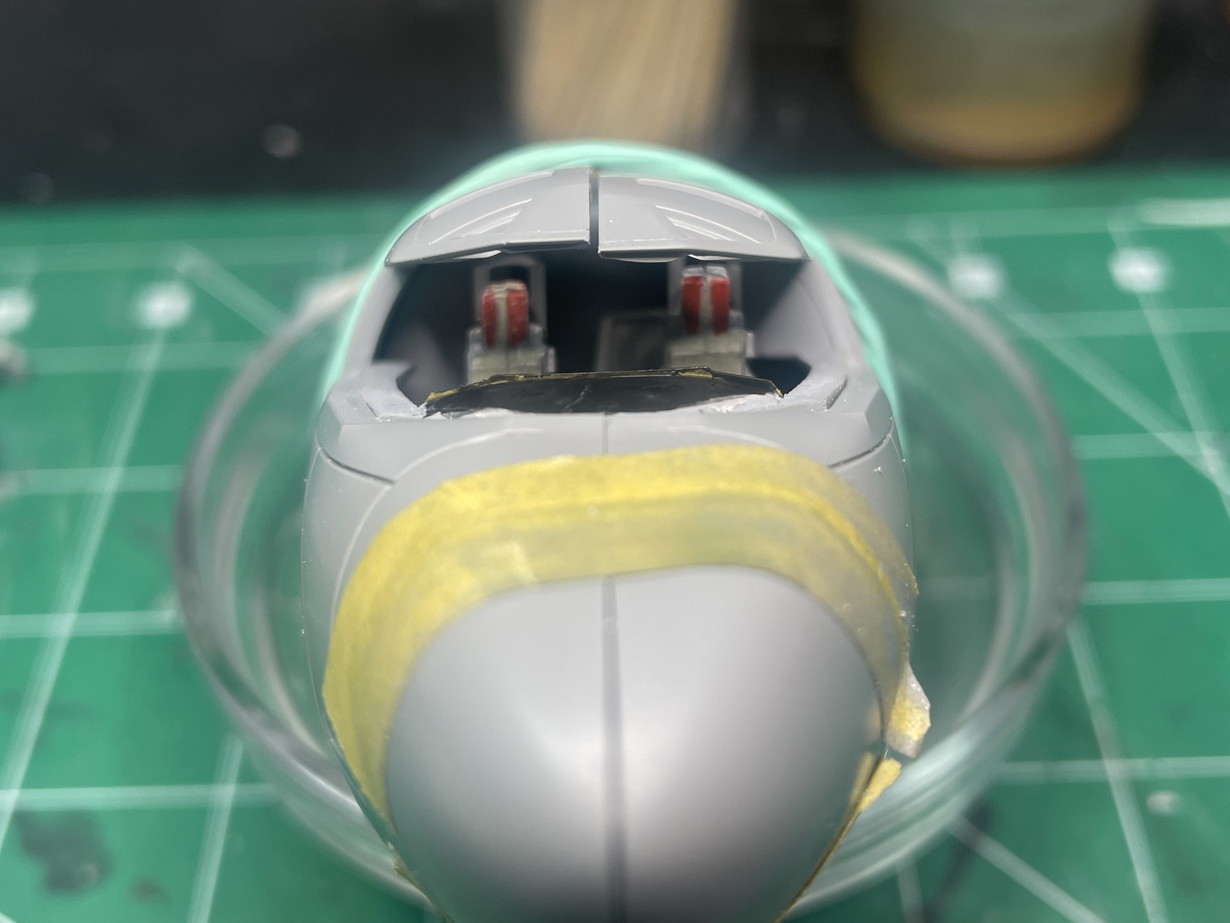

Here is the nose part showing just how much can be seen through the front windscreen - just wait till I add the clear parts!!  I did, subsequently, glue these halves together.  Major seam work ahead but I did get the parts to mostly align...

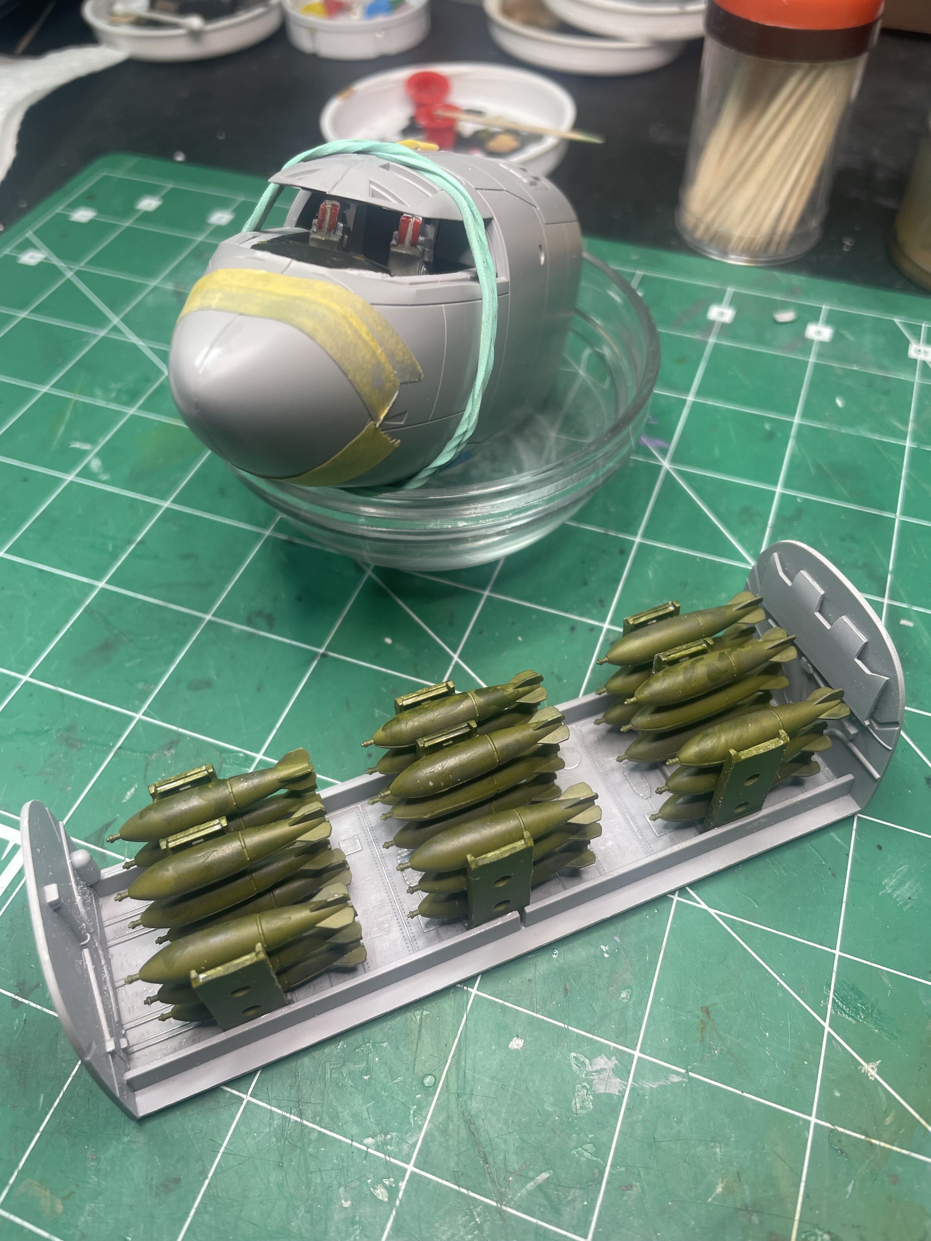

I keep running into annoying fit issues, this time in the bomb bay.  There are two pieces that extend the length of the bay, but both pieces are a few mm too long and interfere with where the bomb bay bulkheads fit into the grooves in the fuselage halves:
IMG_6040.thumb.jpeg.d408b0aa945b3f8265c6f67bc0ff96f6.jpegIMG_6039.thumb.jpeg.97f9974bed4c29747675de1797421a94.jpeg
It is an incredibly easy fix - simply snip off a bit on the ends, but reminds me of the Special Hobby P-39 fit issues. Should not happen.
Anyway, here is the bomb bay dry fitted.  I have some touch-up to do on some of the bombs.  Ham-fisted the painting...

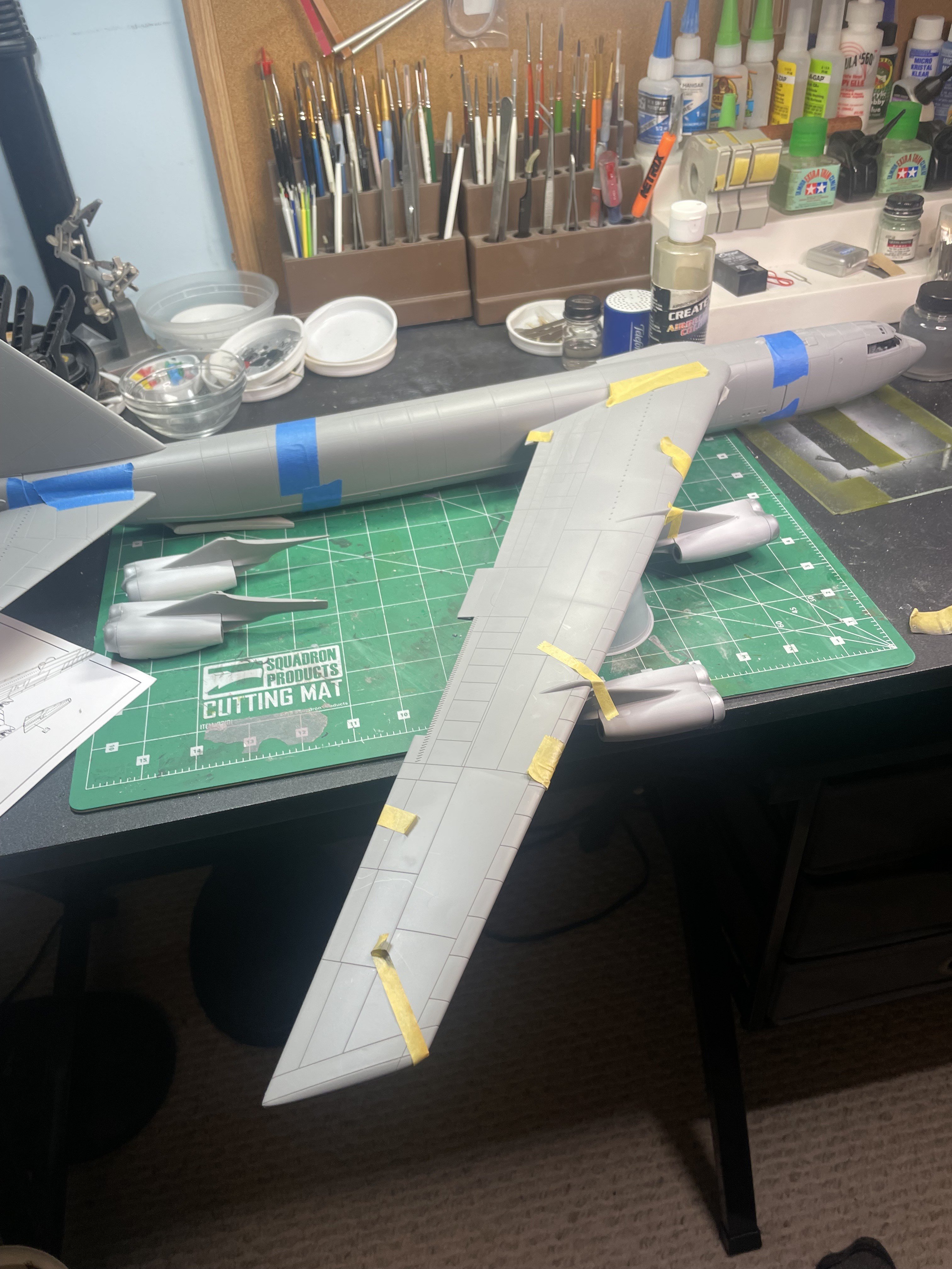

Making progress on the wing after getting the engine nacelles together and figuring out which of the engine pylons go with which nacelles.  According to the instructions, there are two different configurations.  For the life of me, I can't tell the difference with the exception of the join between the nacelles and the pylons is slightly different between the inner and out engines.
Back to my oft-repeated refrain... a lack of location capability is a liability here.  Believe it or not, this is the only pin to join the pylon to the wing;
The big challenge is then making sure the engines are facing in the right direction.  Here is my first attempt at a mock-up:
IMG_6084.thumb.jpeg.c50f8fd41de20fb58f44c7ebd5a61b5b.jpegIMG_6082.thumb.jpeg.f08377bc50c72ee438e81338b571301f.jpeg
Right now using the fuselage/wing join line as the guide.  Also, as you can see, playing with attaching the Italeri pylon and the Hound Dog missile to the wing.  Might work!  I did some sanding to try and match the wing profile - and if it works, I'll use some screws from inside the wing to secure the missile pylon to the wing.  Have to see about sliding it forward to level out the missile.

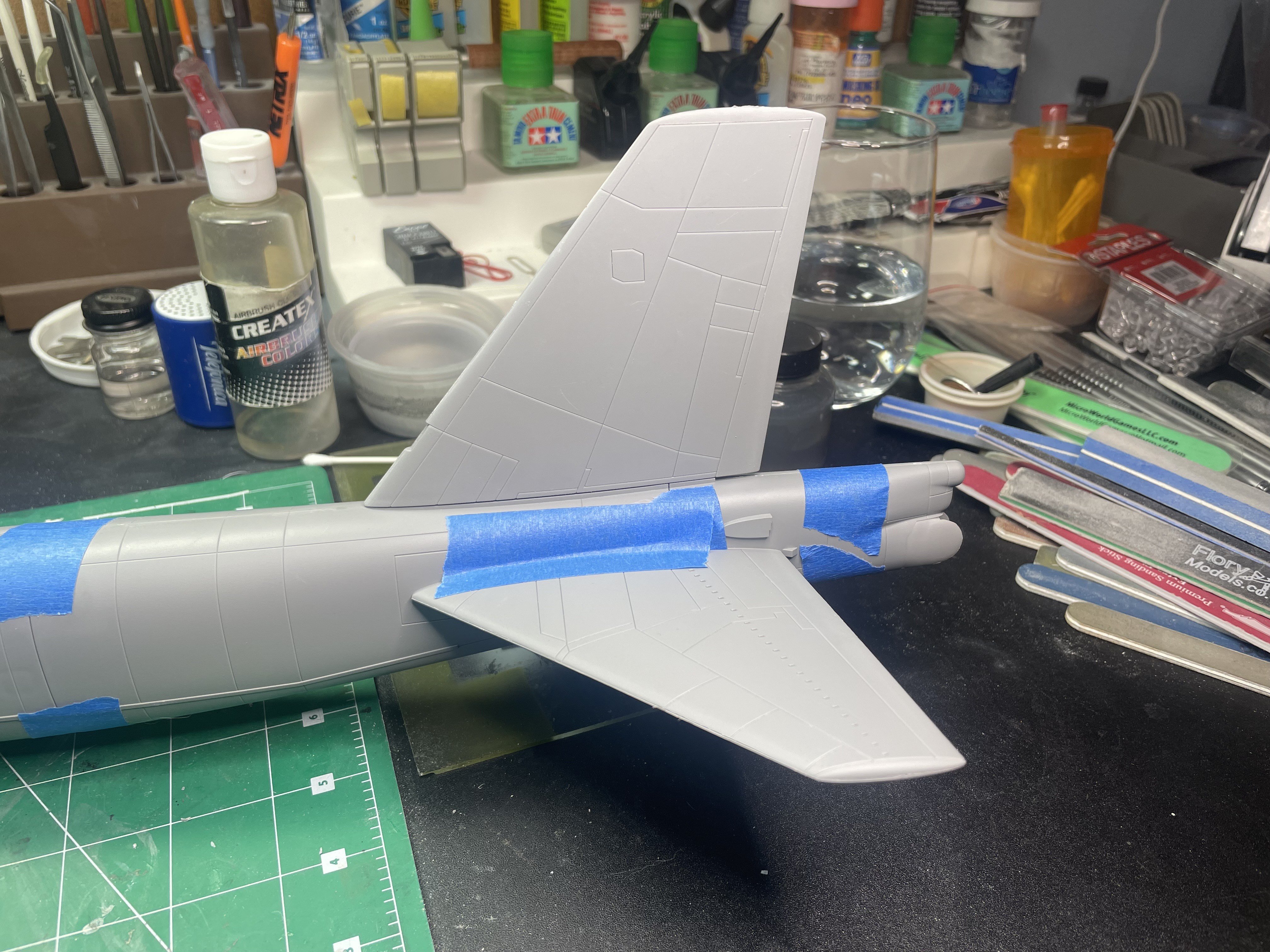

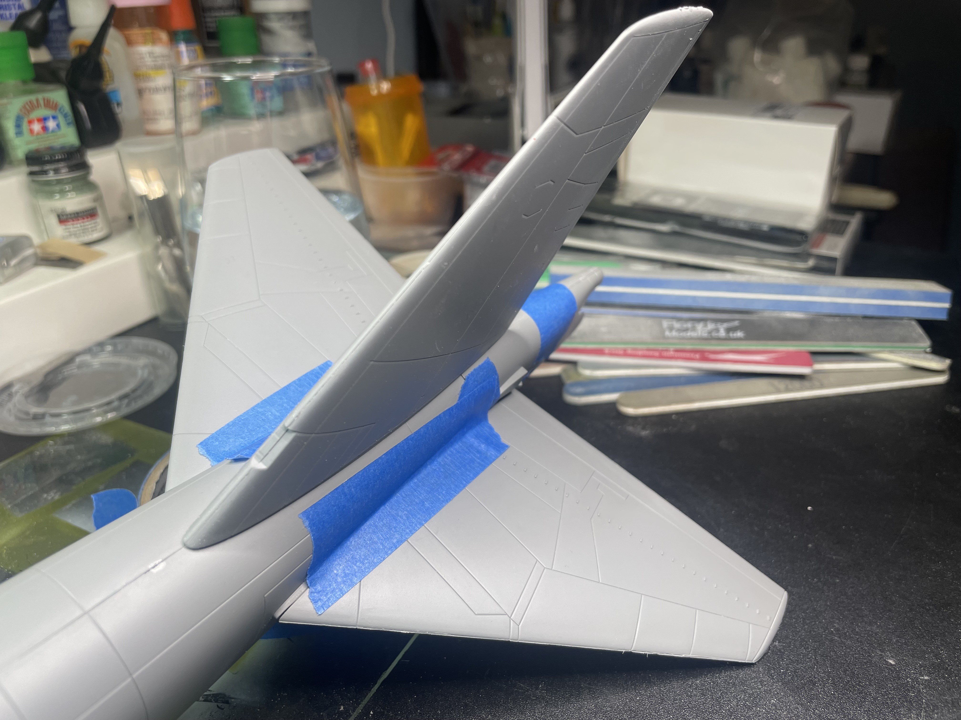

And another anomaly in the instructions.  The stabilizers and tail pieces are Parts E1-E6 as shown below.  Pretty standard.  Them MC decided to reuse E1, E2 and E3 to identify the left, right and tail pieces.
They do that a lot so it is something to watch for.

The fuselage is in four pieces, which makes for a much smaller box than the Italeri kit, but also now have three places where a tight fit will be needed to make the plane look right.  Speaking of the fuselage - the lack of pins to properly align the halves is a big challenge.  I'm literally going inch by inch with the Extra Thin trying to keep the two halves aligned.  Thinking back, I probably could/should have put in some long sprue pieces under the joins to help align the fuselage pieces.  Why didn't I think of that sooner?
The alignment issue I hope does not come back to bite me when I get the engines attached.  They COULD have put another pin at the back of the pylon to positive align the engines correctly.

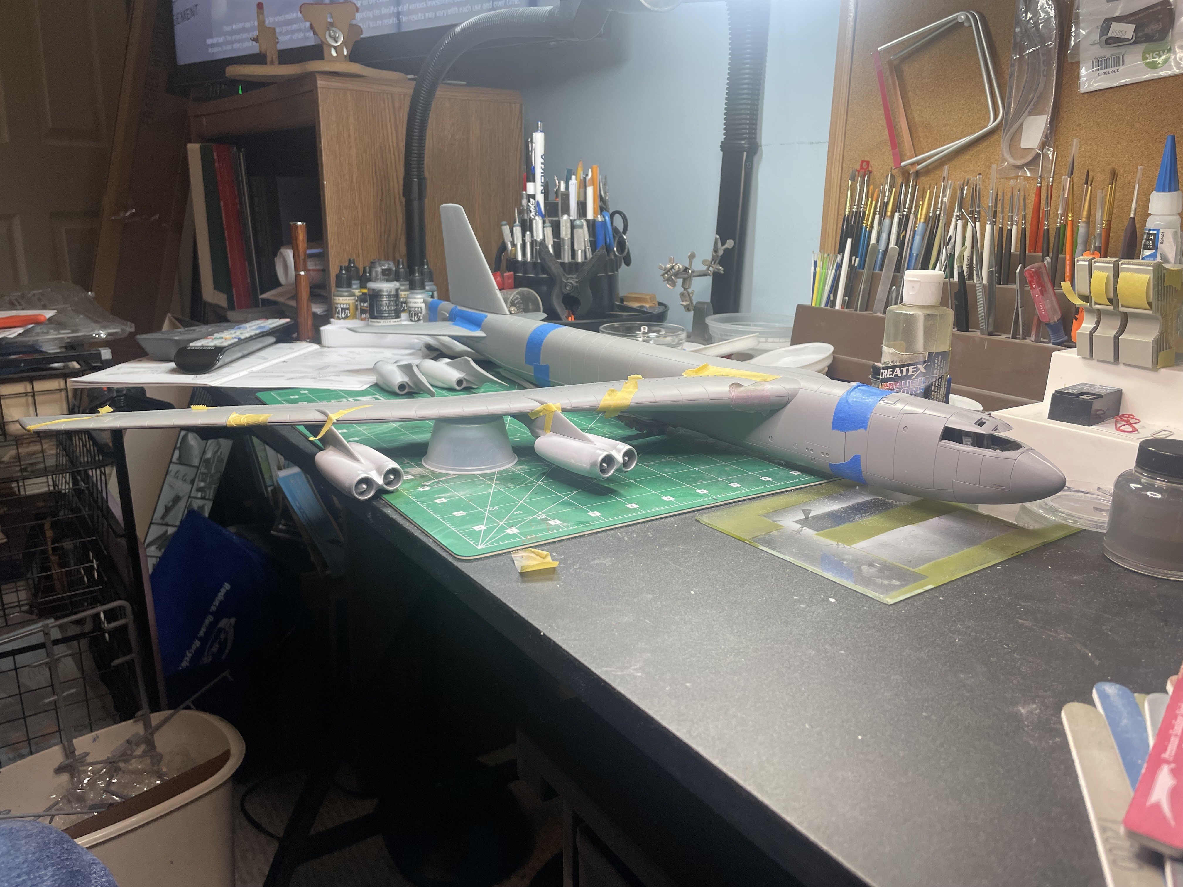

Dry fitting all the main pieces together to see what I am up against.  Size for one thing!!IMG_6141.thumb.jpeg.9f1eef2673a6b8bb83bfea665b5e51c0.jpeg
I think there is more styrene in the tail pieces than in most 1/72 aircraft kits.  The fits don't seem horrible (he says now...) but we will see when it comes time to really put it together.  First up is painting the engines and pylons which get camo colors, then painting the underside of the wings and fuselage, then the topside camo.  Mostly decided how to attach the Hound Dog missile and pylon which will take a bit of work using the Dremel tool to get the pylon to meet up with the underside of the wing.

If the fit of the wings to the fuselage isn't too bad, maybe paint the fuselage and wings  as separate parts. Then join them together and do any needed touch-ups on the joint.
10 hours ago, BlrwestSiR said:
Very carefully.:D
Carl,
That is pretty much what I am thinking, too.  Maybe even modify the camo scheme so that the fuselage join line is one color on each side.  I still have a fair bit of body and seam work, but I want to get started painting the engines and wings.  That's a whole 'nother project onto themselves...
