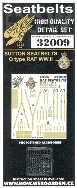

One-Oh-Four Posted June 24, 2015 Author Posted June 24, 2015 Foot? Foot? Oh you mean the bread rolls with cheese? Yeah, Dutchman..... On the penny...... Brought my own food..... As for the aftermarket, Jeroen, I'll be using: Fisher's long chord intakes: www.hyperscale.com The Eduard Interior Zoom set: Jeroen Peters http://forum.largescalemodeller.com/topic/3022-eduard-gloster-meteor-f4-interior-and-seat-belts/ Brassin wheels & mudflaps: Benjamin Summerfield http://forum.largescalemodeller.com/topic/3038-132-meteor-f4-wheels-for-hk-kit/ HGW Q-Type harness: And I have to scrounge a Hawker Hurricane seat from somewhere. My PCM Hurricanes have made themselves scarce as they don't seem to want to be violated.... In any case, I progressed with a set of ailerons (with "working" trim-tabs) and a rudder..... Photos of this breaking news will follow shortly...
