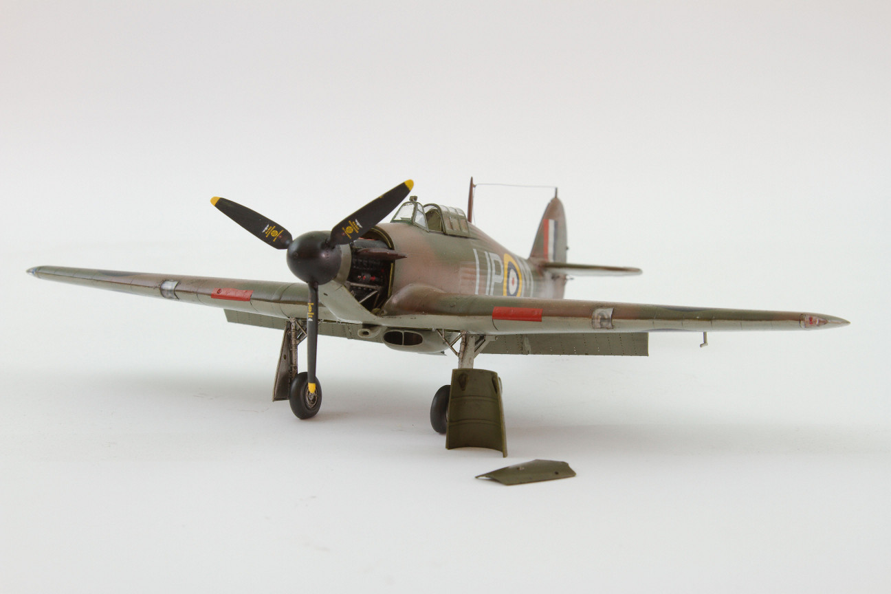

WillScarlet Posted November 7, 2013 Author Posted November 7, 2013 Doogs, why does the 35mm lens show sharper detail than the 60mm macro?
One-Oh-Four Posted November 27, 2013 Posted November 27, 2013 On 11/7/2013 at 9:52 PM, DoogsATX said: I'd be tempted to bring the lights down a bit (mine are about a foot lower than that). Other than that, neutral background, shoot in RAW etc and I think you'll be going places. The D7000 is a really nice camera - what lens are you shooting with? One thing I've found is that longer focal lengths tend to do this weird thing where they "compress" the kit so it feels smaller and less imposing. It's all about the picture angle and weird illusions the mind plays, but... This was shot with my D300s packing a 60mm macro: See original post for photo Same plane, same camera, 35mm lens: See original post for photo Ey Matt, sorry for the delay in my reaction! I've set up my "studio" in the attic. Rigged a backgound over an old desk, positioned the lights and voilá. When I bought this camera I also invested in a sturdy Manfrotto tripod. The one I had was really too light, so very susceptible for movement. A good tripod isn't cheap but should last a looooong time! As for lenses; I use my Nikkor 24-70 f/2.8 And for detail work I have a Sigma 105mm f/2.8 macro Cheers! Erik.
