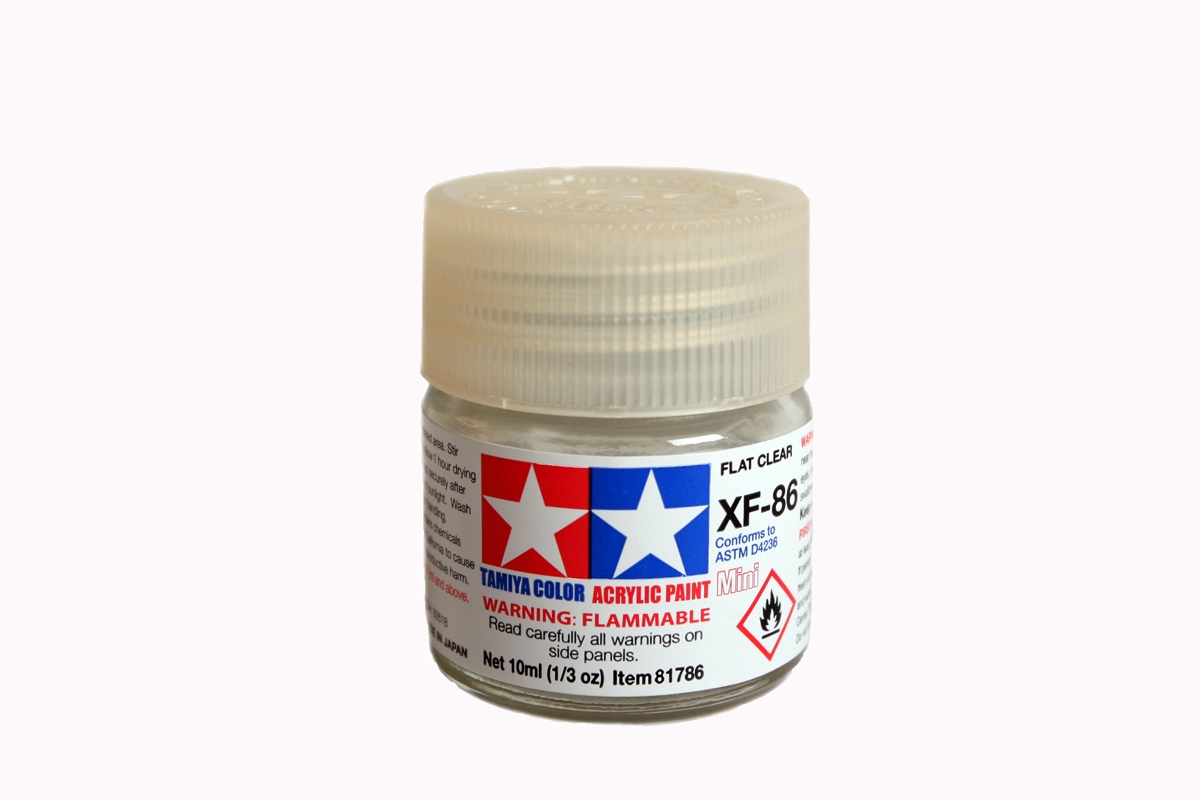

GazzaS Posted December 4, 2020 Posted December 4, 2020 1 hour ago, belugawhaleman said: Tamiya flat base No, No, No! This stuff will fog your model quickly! Ask me how I know. What you want for a satin coat is Tamiya X22: And Tamiya XF-86: Good Luck! 1 2
belugawhaleman Posted December 4, 2020 Author Posted December 4, 2020 I used to mix a little Flat base with the clear gloss to make a semi gloss it was a little tricky but it worked. I just don't remember the exact amounts I used. I tried the tamiya spray can clear flat by decanting it and using it in my airbrush but in places it frosted. I used my Iwata eclipse gravity fed airbrush with .35 mm nozzle. later I resprayed with a wetter coat with my Paasche h #3 nozzle and this improved things a bit. I don't know. I'm going use a sheet of styrene painted with tamiya lacquer as a test piece until I get it right. thanks for your input. I'll keep you posted. improved 2
belugawhaleman Posted December 4, 2020 Author Posted December 4, 2020 31 minutes ago, GazzaS said: No, No, No! This stuff will fog your model quickly! Ask me how I know. What you want for a satin coat is Tamiya X22: And Tamiya XF-86: Good Luck! So you mix the flat clear with the gloss instead of using the flat base? That makes sense. I'll give that a try. thanks .I wonder if that will work with tamiya lacquer gloss and flat? 2
