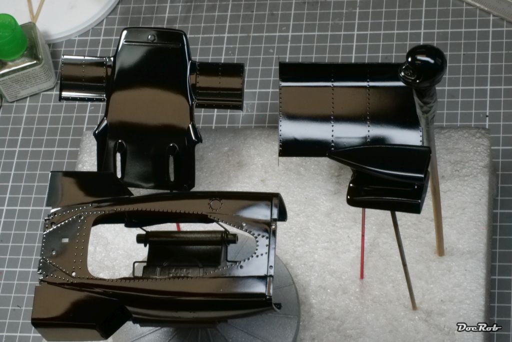

  12. Phew, the real powerhouse of the BT52b took some effort to get right. I can only estimate, how hot the turbo gets when run to full power with all the heat shielding. I should have aluminum wrapped all hoses and tubes, but installation was difficult enough, so I omitted it. The exhaust manifolds, turbo parts and exhausts were painted with AK Extreme Metal stainless steel and accentuated with black smoke of the same brand and finally touched up with Alclad jet exhaust for a reddish brown shine like on my reference pics. The black cover of the turbo is a clear vac part, which I painted translucent black. On the original it is made from carbon fiber, but I was too lazy to decal it, as it will be hidden very deep into the car. I had difficulties to get good color reads off the pictures from the original engine. The embossed aluminum foil needs to be cut and glued to the PE parts. It needs a bit of fine tuning, but it was not easy to get the foiled parts in place. Specially on the tiny cylindrical pot on top it was tedious, with the microscopic three rivets to be placed there. Cheers Rob

  15. I got some more steps completed. I finished the brakes and suspension, added a radiator, the tailwing post and some engine framing, along wiring and tubing. If you ever build this kit, be aware, that the nickel silver wires are pushed deep enough into the holes and don´t end flush, because a peg from part M74 and M75 in a later step will be fitted into the hole. I´ve overseen it and had to do some surgery. Finally the gearbox was glued and screwed to the engine block and now the rear section lacks only the turbo, the exhausts, some electronics and lastly the huge coolers. A spell of really ugly weather with storm and flooding rain acts as a building booster, always hoping, nothing flies away or goes submarine. Some mock up pictures with the monocoque loosely added: Cheers Rob
