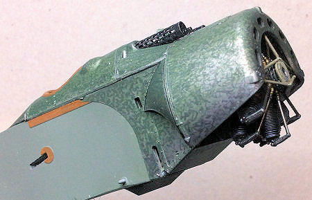

sandbagger Posted January 13, 2023 Author Posted January 13, 2023 Hi all, Engine and cowl assemblies fitted. Fuselage side fairings and underside deflector fitted. Now onto the fuselage weathering, Mike 5 1

sandbagger Posted January 15, 2023 Author Posted January 15, 2023 Hi all, Fuselage more of less complete now. 'Flory Models' Dart Dirt clay wash and 'Tamiya' Weathering Master Set A and C. 'AK Interactive' Kerosene wash used under the fuselage at the engine. Decals applied and sealed with 'Alclad' Light Sheen (ALC311). Now it's onto painting and pre-rigging before building continues, Mike 5 1

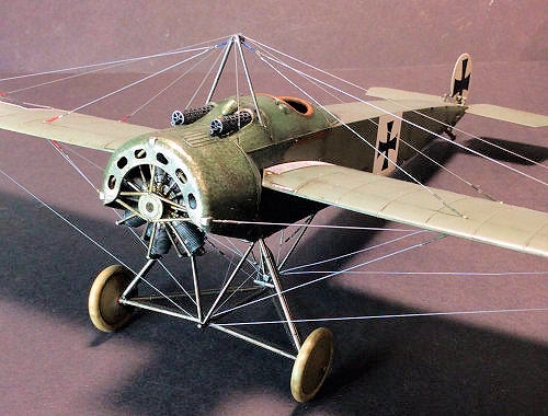

sandbagger Posted January 17, 2023 Author Posted January 17, 2023 Hi all, The support pylon in front of the cockpit is moulded to scale. This makes the pylon weak and liable to distortion or breaking if subjected to stress. In addition, despite the good key supports in the fuselage for the wings, the weight of the wings does impart a downward leverage (anhedral). Therefore, as with my E.1 model, I chose to replace the pylon and its cable pulley. The cable pulley was cut from three 2.5 mm diameter and two 1.75 mm diameter discs of 0.2 mm thick plastic card. The pylon was made from 1.0 mm and 0.6 mm Brass tube with 0.4 mm diameter Brass rod, on which are two 'Gaspatch' 1:32nd scale Type C turnbuckles. The parts were soft soldered together and the cable pulley secured onto the 0.5 mm rod. A holes of 0.2 mm diameter was drilled through the flattened front tube to allow rigging lines to be attached, Mike 3

sandbagger Posted January 21, 2023 Author Posted January 21, 2023 Hi all, Getting close to the finish now, Rigging completed using 0.08 and 0.12 mm diameter mono-filament with 0.4 and 0.5 mm diameter blackened Brass tubes. 'Gaspatch' 1:48th/1:32nd and 'Proper Plane' 1:32nd scale turnbuckles. Just the gun sights, windscreen, foot steps and propeller to fit. Also the display case and figure, Mike 4 2
