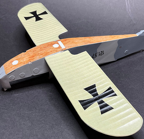

Hi all,
Here's some progress shots of the kit parts after priming.
I won't go into details of what needed to be straightened, deleted, added or modified.
Suffice to say it's taken a while to get to this stage.
Everything done and why will be detailed in my PDF build log on completion,
Mike

Hi all,
When the engine and the 3D printed side access panels were test fitted, I found the following:
The bottom edges of the engine side panels were bowed and did not align with the fuselage.
The top, rear edges of the side panels did not meet, leaving a large gap between them.
I removed the bow in the side panels using heat from a hair dryer to re-profile the panels.
The gap between the top, rear of the panels was filled with 1.0 mm thick plastic card then sanded to shape.
Mike

Hi all,
The two photographs of 121.57 I have and a colour profile show that this aircraft had the later ‘Balkenkreuz’, straight-armed cross markings.
The requirement to change to this type of marking was introduced during 1918, to replace the earlier ‘Eisernekrueze’ iron crosses.
However, not all aircraft markings had been changed before the Armistice.
The photographs of 121.57 with the ‘Balkenkreuz’ markings on were taken late in WW1 following a flying accident.
Earlier, aircraft would have had the ‘Cross Pattée’ (Iron Cross) markings as shown on 121.27, 121.36 and 121.55.
I chose to apply those markings rather than the later ‘Balkenkreuz’ markings.
It should be noted that the markings on the upper wing and rudder had white borders. The markings on the lower wings were black only, with no border.
The following decals were from my decal ‘spares’ collection from other built models:
Fuselage data plates.
Interplane strut serial numbers.
Rudder cable outlet surrounds (fuselage).
The following decals were sourced from online resources and the colour profile.
These were copied then prepared in ‘Paint Shop Pro’ software.
They were then printed on ‘MDP’ clear decal paper (laser decal paper), using my Canon LBP631Cw laser printer.
Laser printing means the decals do not require sealing before use, as would be the case if created on an inkjet printer.
Fuselage serial numbers.
Fuselage data legend.
‘Phönix’ company logo (rudder).
Mike
