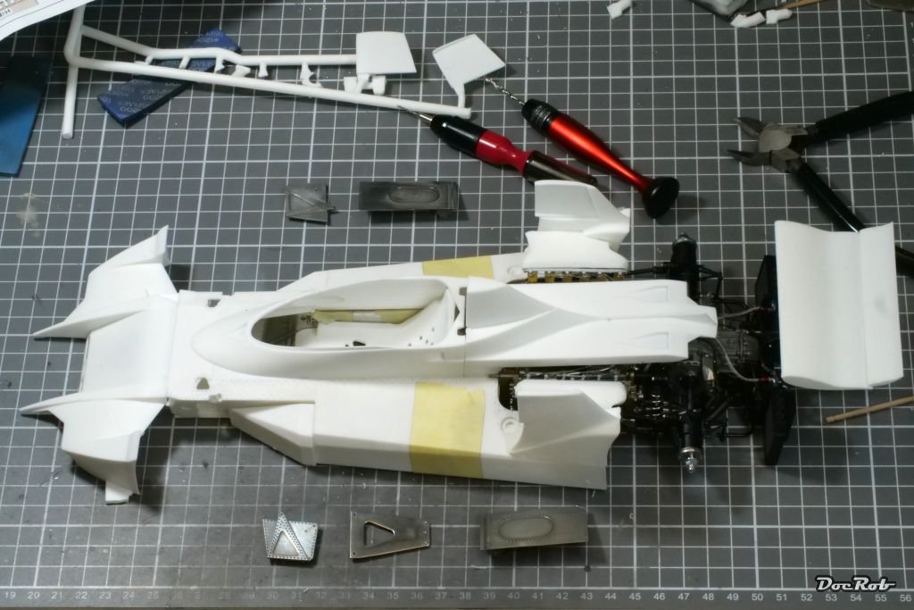

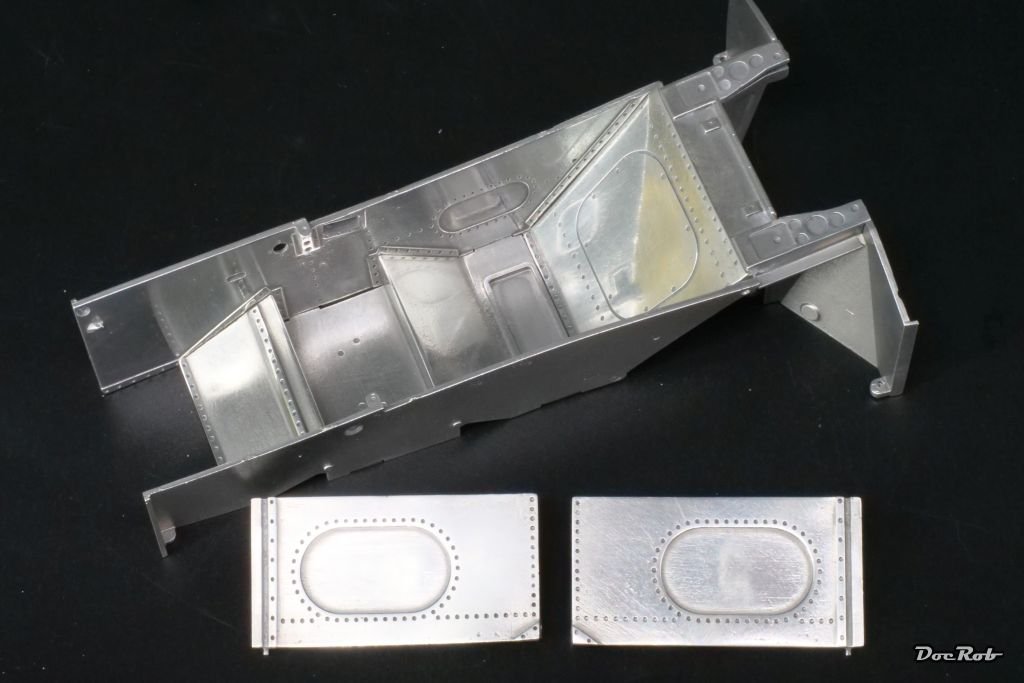

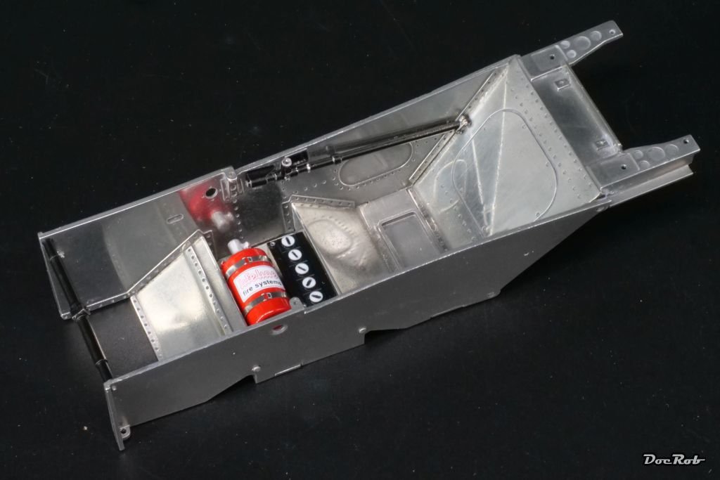

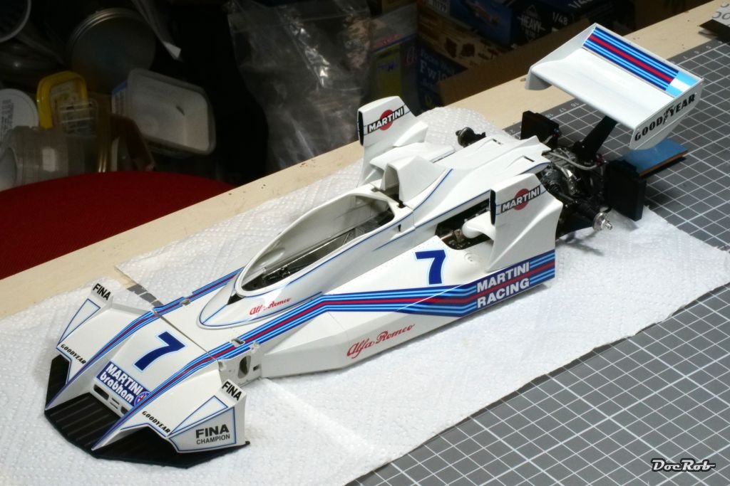

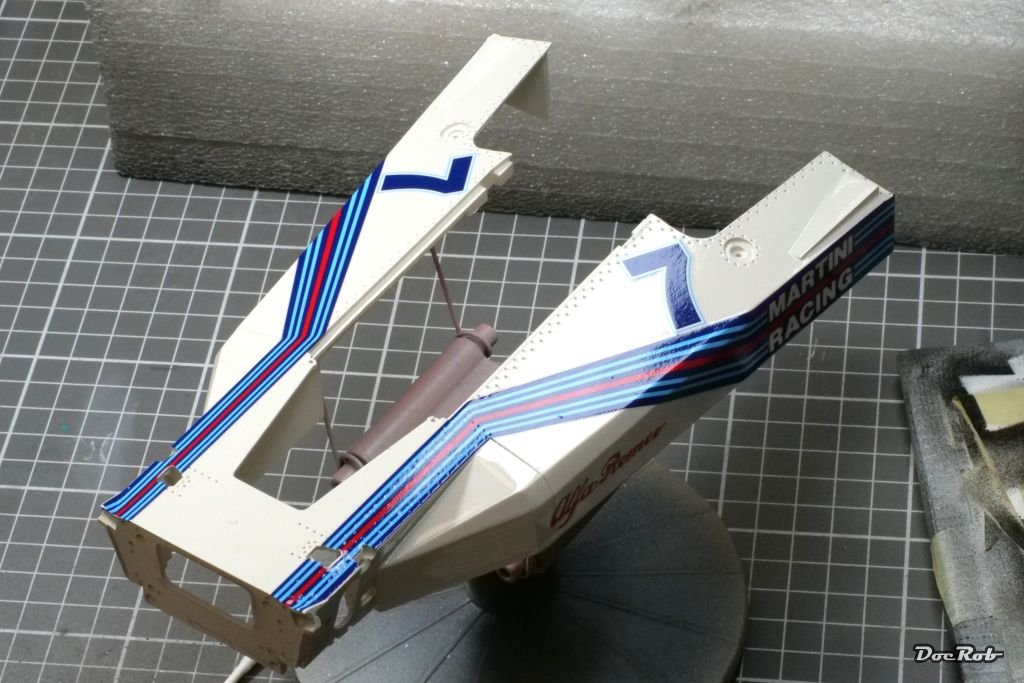

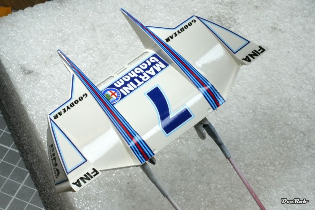

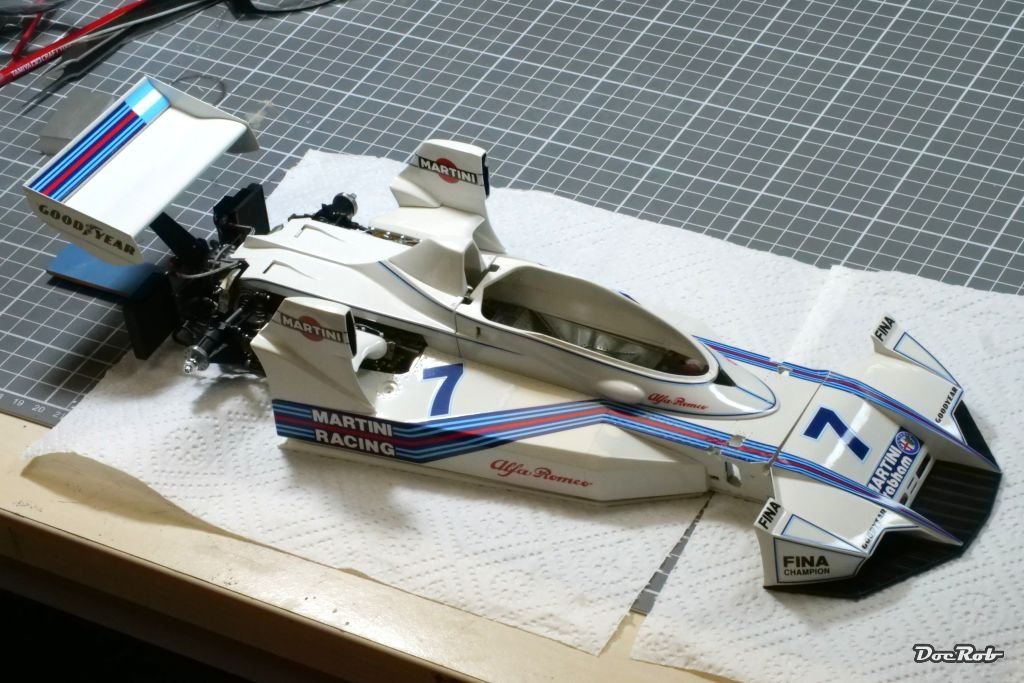

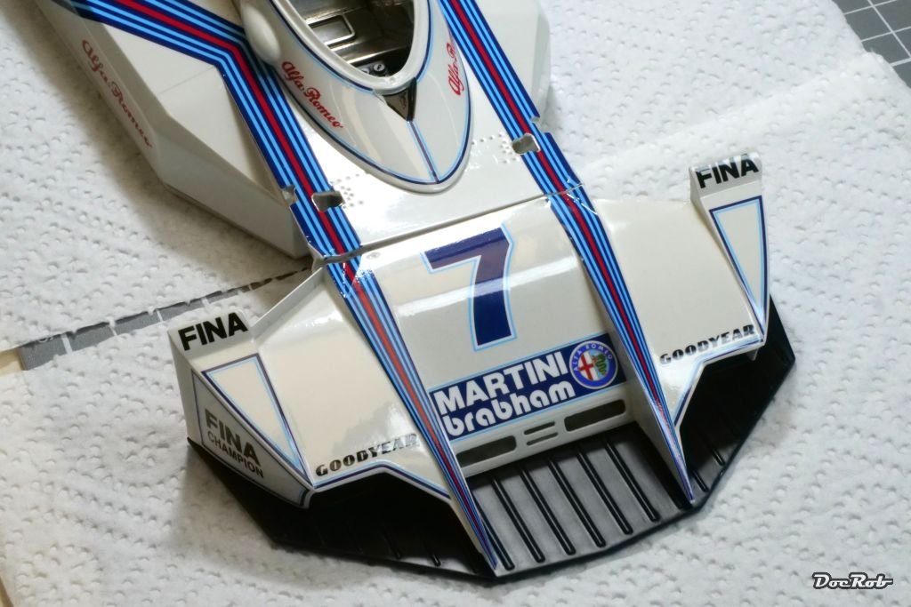

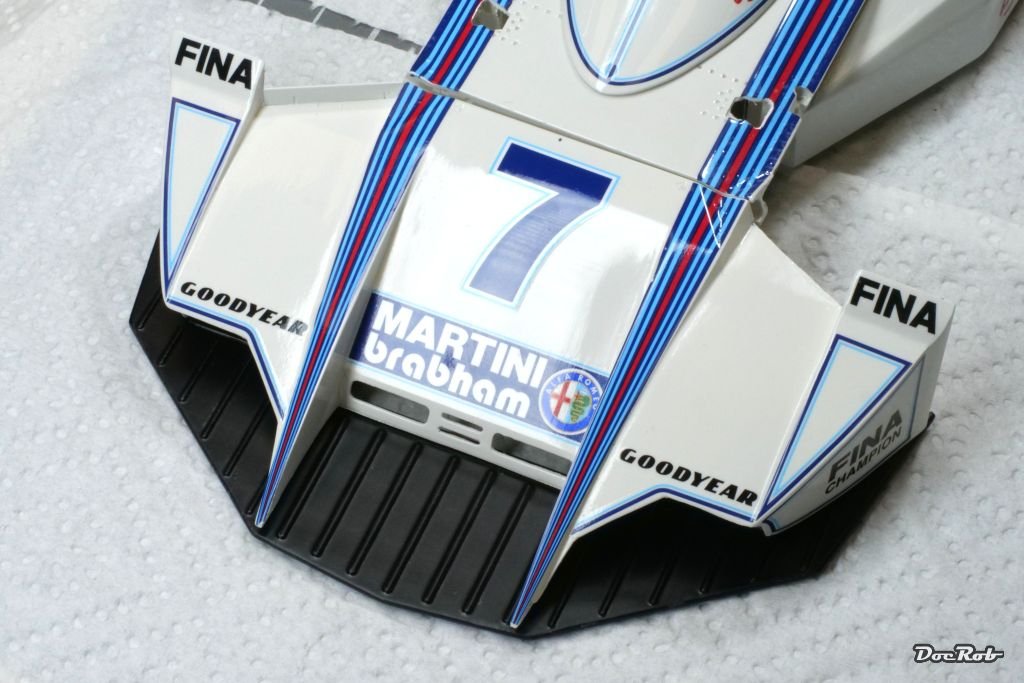

DocRob Posted 22 hours ago Author Posted 22 hours ago Yesterday was the day of mano negra, the black hand . Polishing white metal makes your fingers black with the metal residues, but despite the dirt, it is fun. I used sanding sponges of 1200 to 6000 grit, to get rid off the cast imperfections, then it was about polishing with a cotton swab and Autosol metal polishing paste with works really well. I like the shiny look a lot and it could pass for polished aluminum to my eye. Today, i test fitted for some hours, as now is the decisive step, where the tub has to fit into the body, along all the mating parts. Cheers Rob 5
Landlubber Mike Posted 21 hours ago Posted 21 hours ago Looks great Rob. I wouldn't have thought you could get that kind of result from polishing white metal. Very interesting. 1 1
DocRob Posted 16 hours ago Author Posted 16 hours ago 5 hours ago, Landlubber Mike said: Looks great Rob. I wouldn't have thought you could get that kind of result from polishing white metal. Very interesting. Thank you Mike, the white metal polishes really easy in fact. I did a lot of polishing with my Crocker motorcycle build as well. The only problem are slight superficial imperfections due to the casting process, which need to be removed first. This can be quite tedious, as it is not easy to sand the parts without losing detail and not all areas are reachable for proper sanding. I don´t know about other metal polishing pastes, but Autosol is a classic and it works perfect for me. Cheers Rob 1 1
belugawhaleman Posted 13 hours ago Posted 13 hours ago Looks great Rob😀 Do the polished white metal parts eventually tarnish again? 1
DocRob Posted 4 hours ago Author Posted 4 hours ago 9 hours ago, belugawhaleman said: Looks great Rob😀 Do the polished white metal parts eventually tarnish again? Thank you Paul, about tarnishing, I don´t know, but I guess, very little so. These kind of metals are not overly reactive. My Crocker motorcycle with many polished surfaces looks completely unchanged after about a year. Cheers Rob
