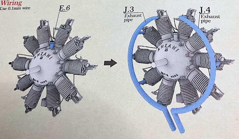

sandbagger Posted June 13, 2025 Author Posted June 13, 2025 Hi all, I had built and painted the engine and was about to add ignition leads to the spark plugs. However, at this stage of the engine build I found an apparent error in the molding of the front bank of engine cylinders. As can be seen in the following photograph, the spark plugs on both banks of cylinders face left. The kit instruction manual at step 67 shows the cylinders with plugs fitted at the left and the right. Further to that, Step 68 shows the engine with what appears to be two spark plugs fitted in each cylinder. Also, the Caudron G.3's in the RAF museum, Hendon, UK and and in the Brussels Museum, Belgium show two plugs per cylinder. As the engine halves J8, 9, 10 and 11 are keyed, they can only be fitted together one way. Therefore, the locations of the spark plug on the models engine are confusing. So, modification to the front cylinder spark plugs may be required, Lacking definitive information, I'll go for single, left facing spark plugs on all cylinders, Mike 4
sandbagger Posted June 14, 2025 Author Posted June 14, 2025 Hi all, I've had contact from Copper State Models and others and have found more reference photographs. The only references available are period photographs, museum engines and aircraft and the kit instruction manual. Period photographs show limited, if any, engine detail. As most know, museum displays can be misleading due to reworking and display requirements, so they are not always authentic. As examples, the Caudron G.3s in the RAF Museum in Hendon, UK and the Museum in Brussels, Belgium have two spark plugs fitted to each cylinder on their Anzani engines. However, photographs of Anzani engines clearly show the spark plugs fitted to the right side of the left cylinders and left side of the right cylinders. This configuration matches the illustrations in the kit instruction manual, but not on the completed model of the engine. Therefore, the completed model engine would appear to have four spark plugs located on the wrong side of their cylinders, being on two front cylinders and two rear cylinders. Those spark plugs are highlighted in the following photograph and are the ones that I will either reposition or replace, Mike 4
sandbagger Posted June 14, 2025 Author Posted June 14, 2025 Hi all, Rather than have some kit molded spark plugs and some replacement plugs, I chose to replace all plugs. That way there would be no mismatch of plugs. The kit plugs were cut away and replaced by Albion Alloy's 0.5 mm diameter Aluminium tube (MAT05). These will have copper wire ignition leads added, Mike 6 1

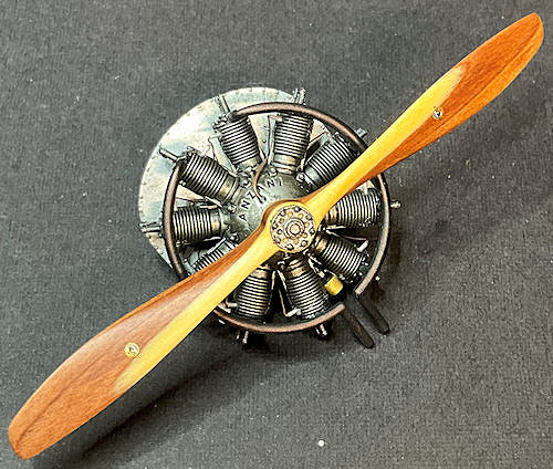

sandbagger Posted June 15, 2025 Author Posted June 15, 2025 Hi all, The basic engine is complete. I've replaced the spark plugs and added ignition leads. I've also added what I assume is an oil supply pipe to the engine crankcase. The carburettor fuel supply pipe and control rod can only be added after the cabin has been assembled, Mike 4 1
sandbagger Posted June 15, 2025 Author Posted June 15, 2025 Hi all, The propeller is completed. A Waring and Gillow wood laminated propeller from Proper Plane (WP-046). Kit decals used and hub plates painted with Mr. Color Super Iron 2. Now its onto rigging the Carlingue (cabin), Mike 4

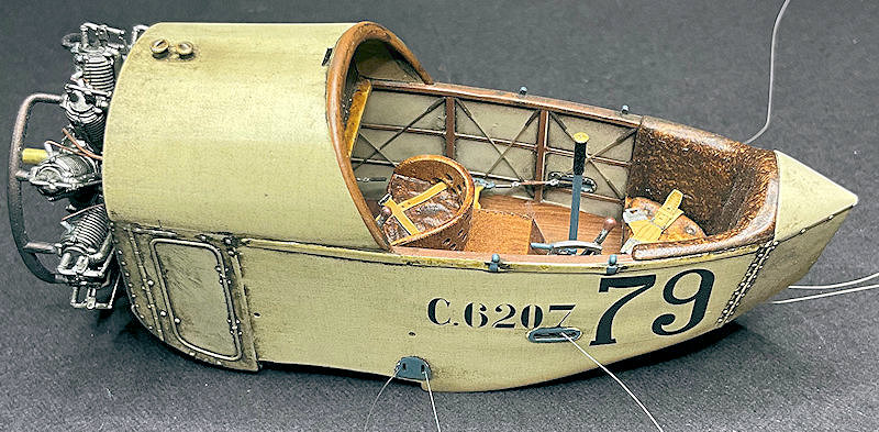

sandbagger Posted June 18, 2025 Author Posted June 18, 2025 Hi all, The Carlingue (cabin) is more or less complete. There's few thinks left to do such as tidying of seam joints and weather etc. One modification to do yet is for the carburettor fuel supply pipe and operating rod. These are at the bottom of the carburettor and are routed through the forward, underside panel. The illustrations in the kit instruction manual show a hole in the panel, but there is no hole in the actual kit panel. Also the kit has no parts to represent the fuel supply pipe or the control rod, Mike 4 1
sandbagger Posted June 19, 2025 Author Posted June 19, 2025 Hi all, The carburettor fuel supply pipe and control rod added. Both added using PlusModel 0.3 mm diameter lead wire. Rod painted with Mr. Color Stainless Steel (213). Pipe painted with Tamiya Clear Orange (X24), Mike 4
sandbagger Posted June 20, 2025 Author Posted June 20, 2025 Hi all, The cabin is finished now, apart from adding the windscreen. That will be added at the end of the build. Weathered with Flory Models Dark Dirt clay wash and Tamiya Weathering Masters. The propeller is test fitted only, Mike 6
sandbagger Posted June 21, 2025 Author Posted June 21, 2025 Hi all, Well, at 75 years of age I think I'm entitled to make a mistake every so often !! I was looking at the cabin last night and kept thinking there was something missing. Then I realized - the linen effect decals for the cabin. Hmmmmmm ? The cabin was finished with all of its rigging, paint, decals, sealing clear coat and weathering applied. I did think of leaving it but the wings and tail would have linen effect decals, so ------- I've stripped the exterior of the cabin back to the base coat and repainted the surfaces. Next up is to apply the 'Aviattic' Linen Weave effect decal (ATT32044), then the kit decals. Fortunately there are three sets of Belgium serial number decals in the kit. Then it'll be weathering and sealing coat. I'll be back, Mike 2 2
sandbagger Posted June 22, 2025 Author Posted June 22, 2025 Hi all, Cabin version number 2. This time with linen weave effect decal applied and alternative serial numbers, Mike 4
