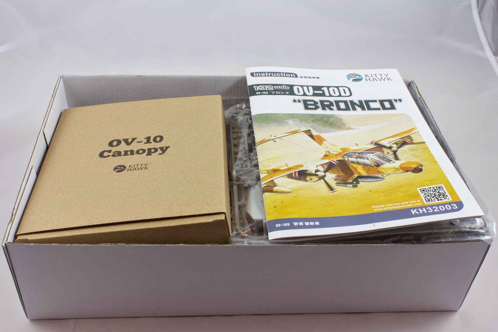

The box is big, not WnW Duellist big just big.  Its about 60cm wide, 20 deep and thickness of about 15cm.  Its also packed to the gunnels with plastic. There are 9 sprues of grey plastic that’s as good as any I have seen (including Tamiya) and 1 of clear.  A nice touch is that the clear sprue is housed in a special box of its own.
There is also a metal nose weight that seems quite heavy and a fret of small PE along with 2 sheets of decals.

I missed the Canopy parts.
They're ultra clear, look flawless and have some really nice riveting especially around the main front canopy parts.
With an aircraft like this, suck big windows It'd be a real letdown if they weren't so good, so I'm really happy they are so good.
I will get some better ones tomorrow as well as a few macro shots of the main sprues.
