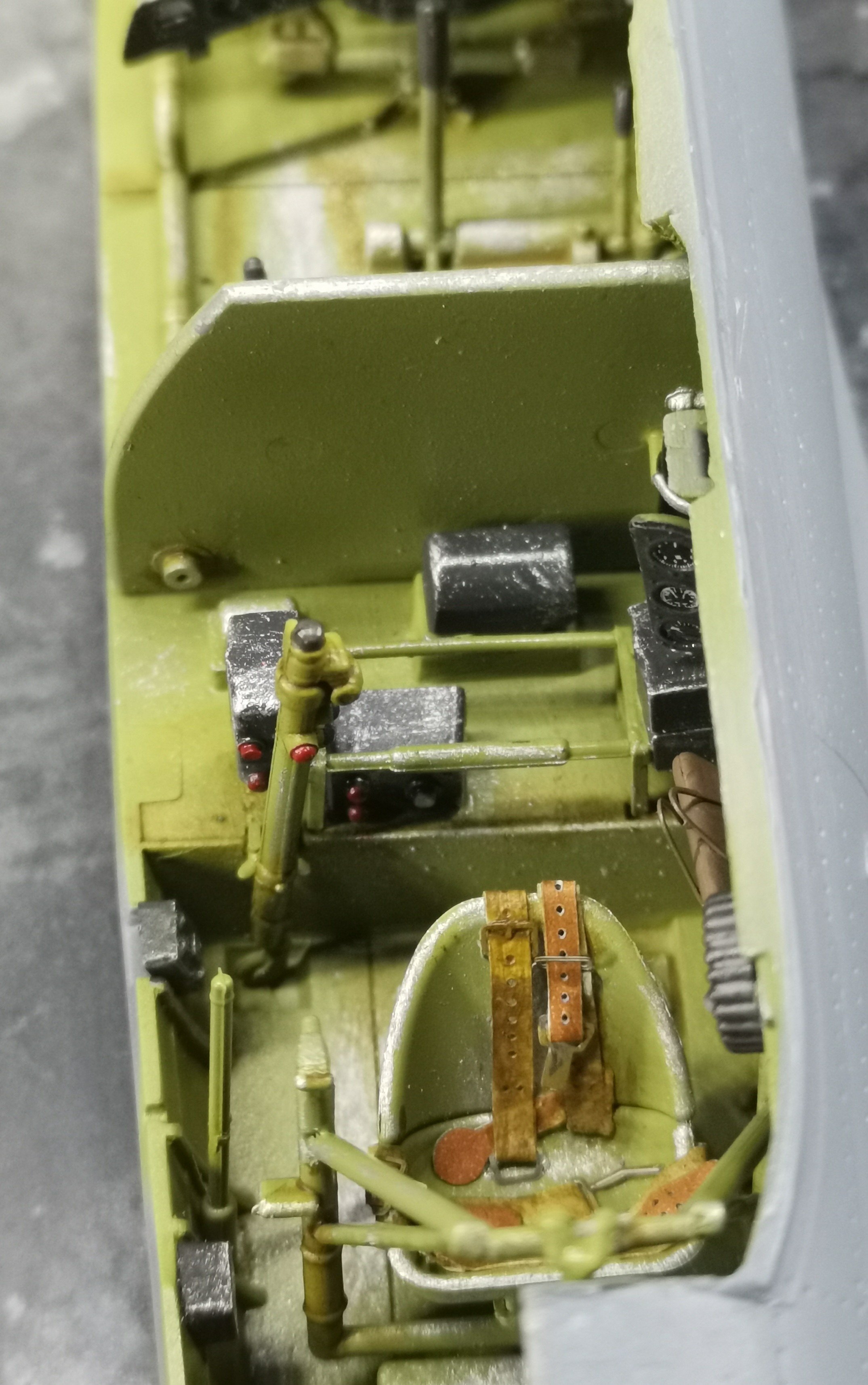

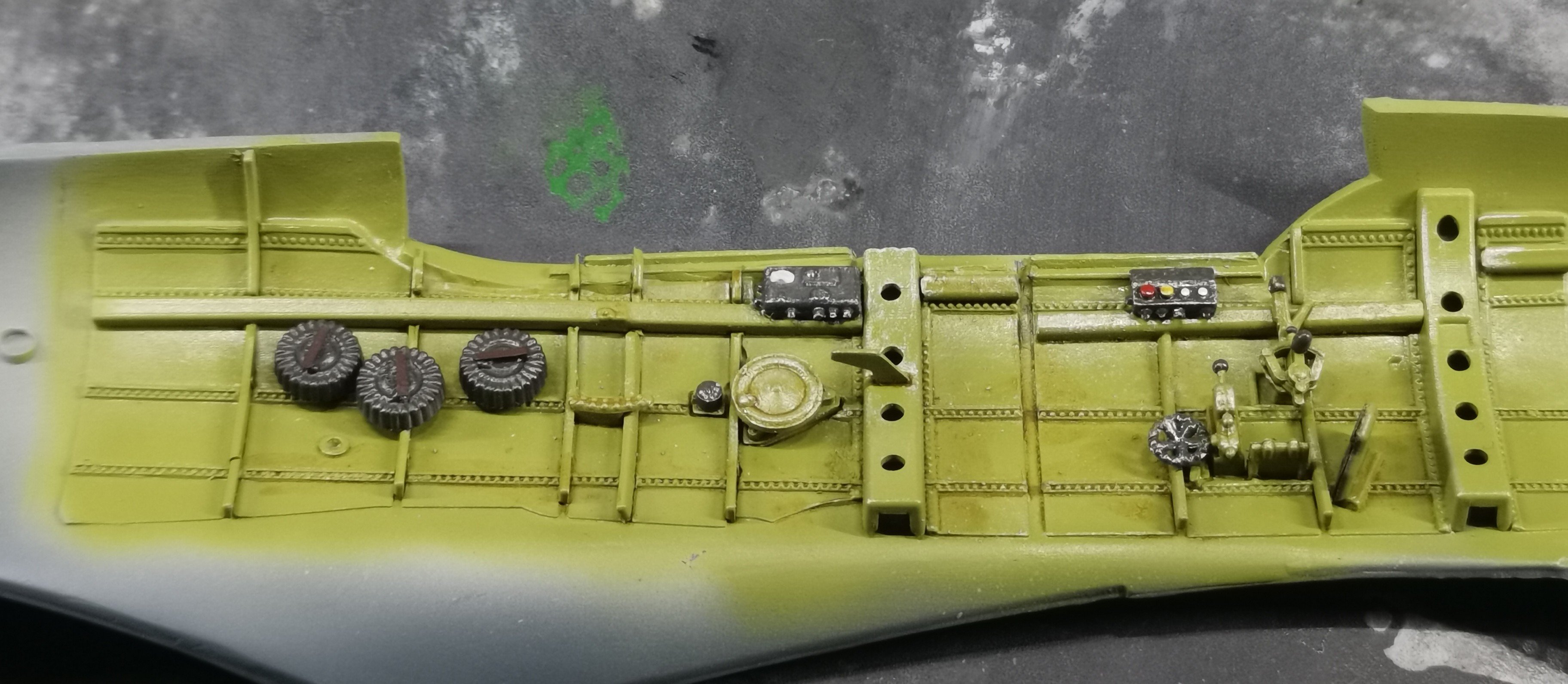

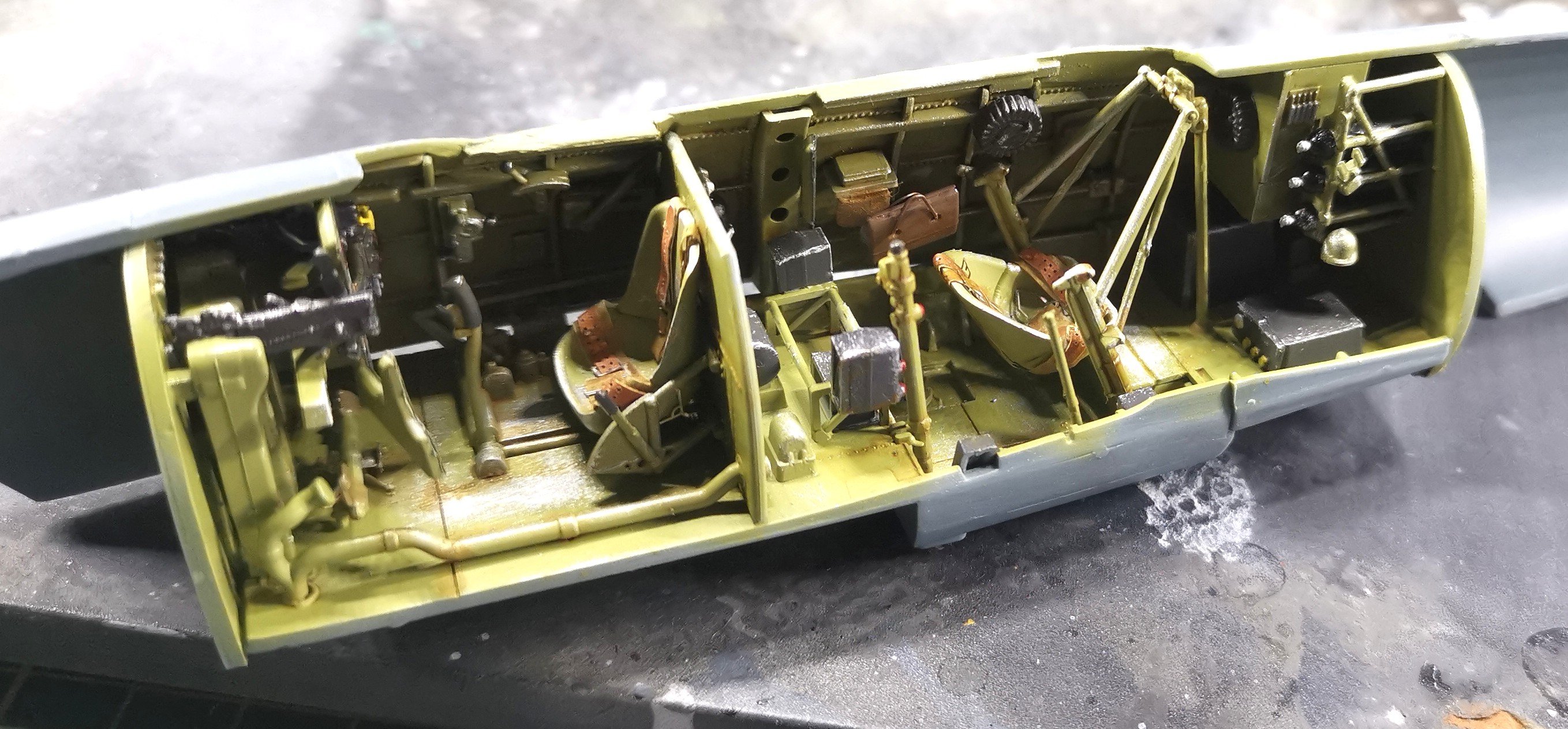

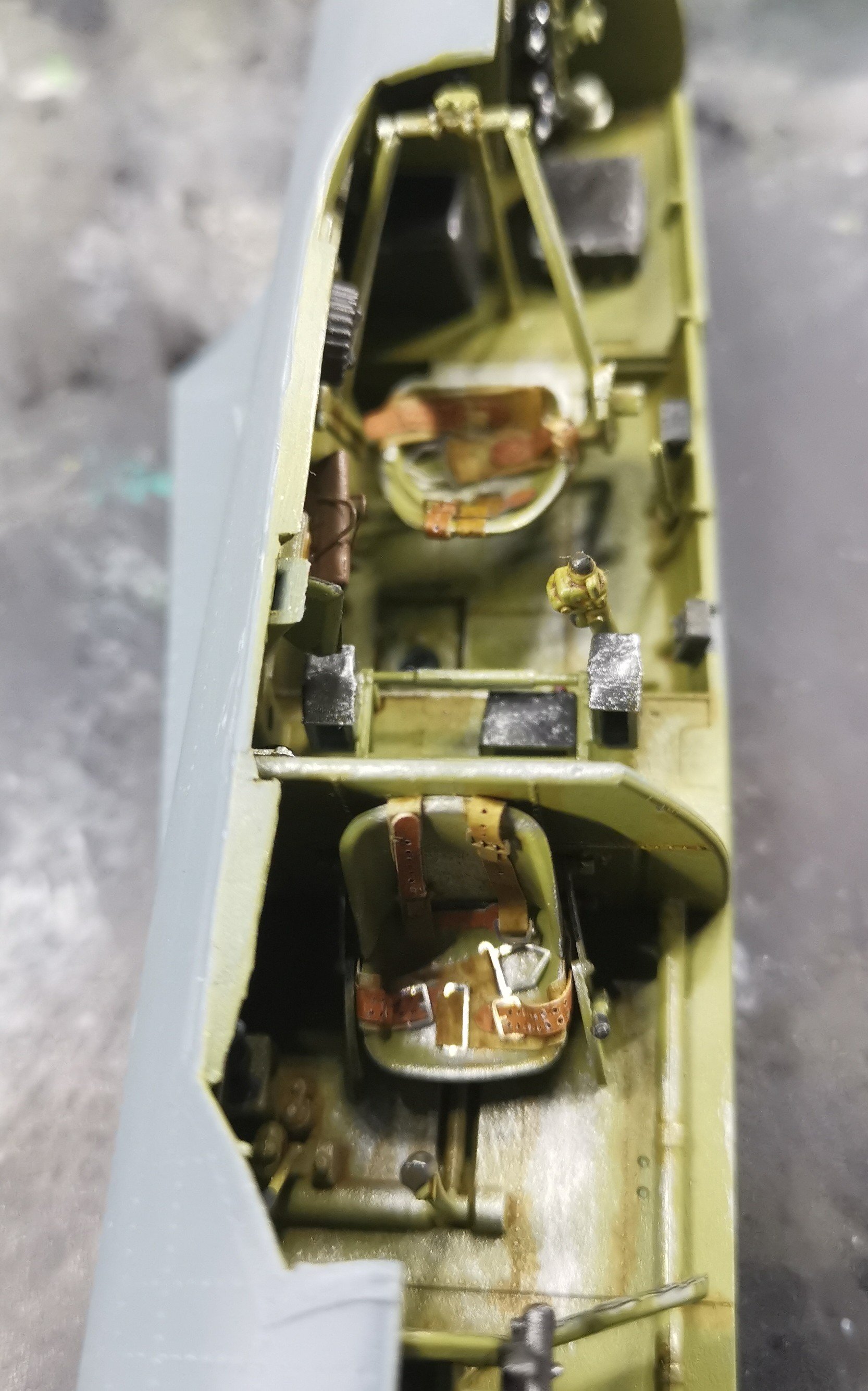

Got the detail painting and some dry brushing done on the cockpit components.
Next up is a gloss coat then some oils and a pin wash and we'll see how we're looking.
The small detail parts really become apparent after they're painted and I'm pretty happy with it all goes together so far.
  • Like 11

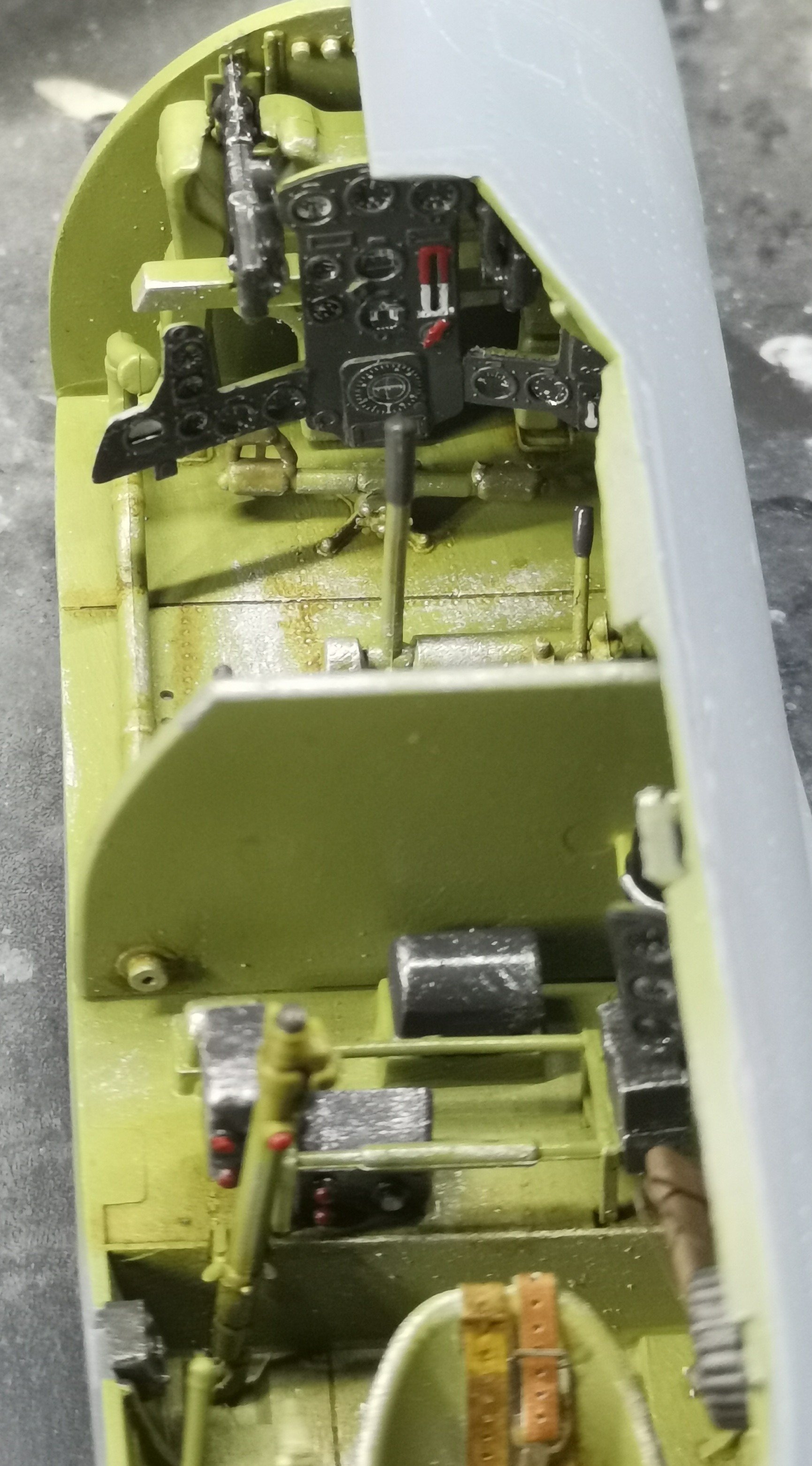

Got the instrument panels done with some detail painting and Airscale decals. Flat coat and gloss over the dials to come.
Very fine detail, Gus, I can´t wait to see how all the interior parts sum up.
I should've mentioned I used Gundam markers for the first time on the cockpit dials and switches - very impressed with most but the red is too dark and translucent for my taste.

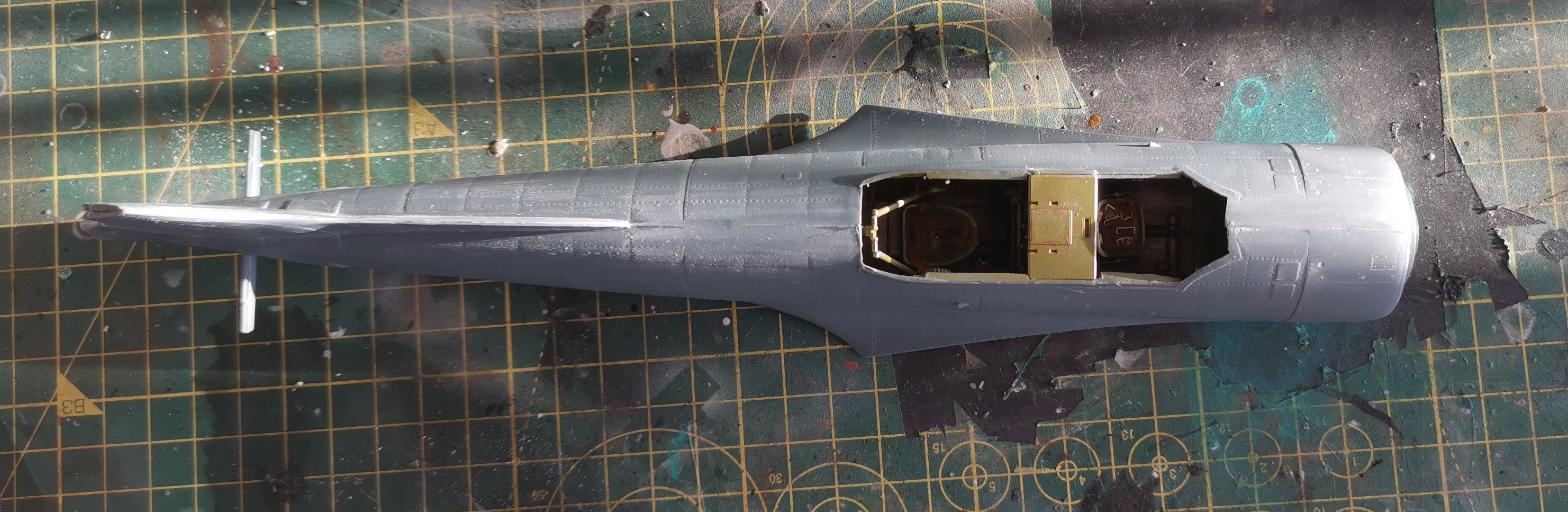

Just about ready to join the fuselage halves. Everything fits nicely so far, so hopefully the rear spar and tail wheel bay don't screw that up!
Definitely a fun build so far.
Looking good, I have the same kit and goodies in the stash so please keep up the good work.
Cheers
Dennis
Looking good, Gus, but does the IP sitting straight? It looks off on the pic, not that it later obstructs, when closing the fuselage.
Thanks Rob. Looking from above and the side, the IP does sit straight. I see what you mean in the photo though. I wonder if it's just because of the combination of straight and curved edges in that area.
I've dry fitted the fuselage and it all fits really nicely with no issues which is a pleasant surprise given how busy the sidewalls and cockpit floor are.

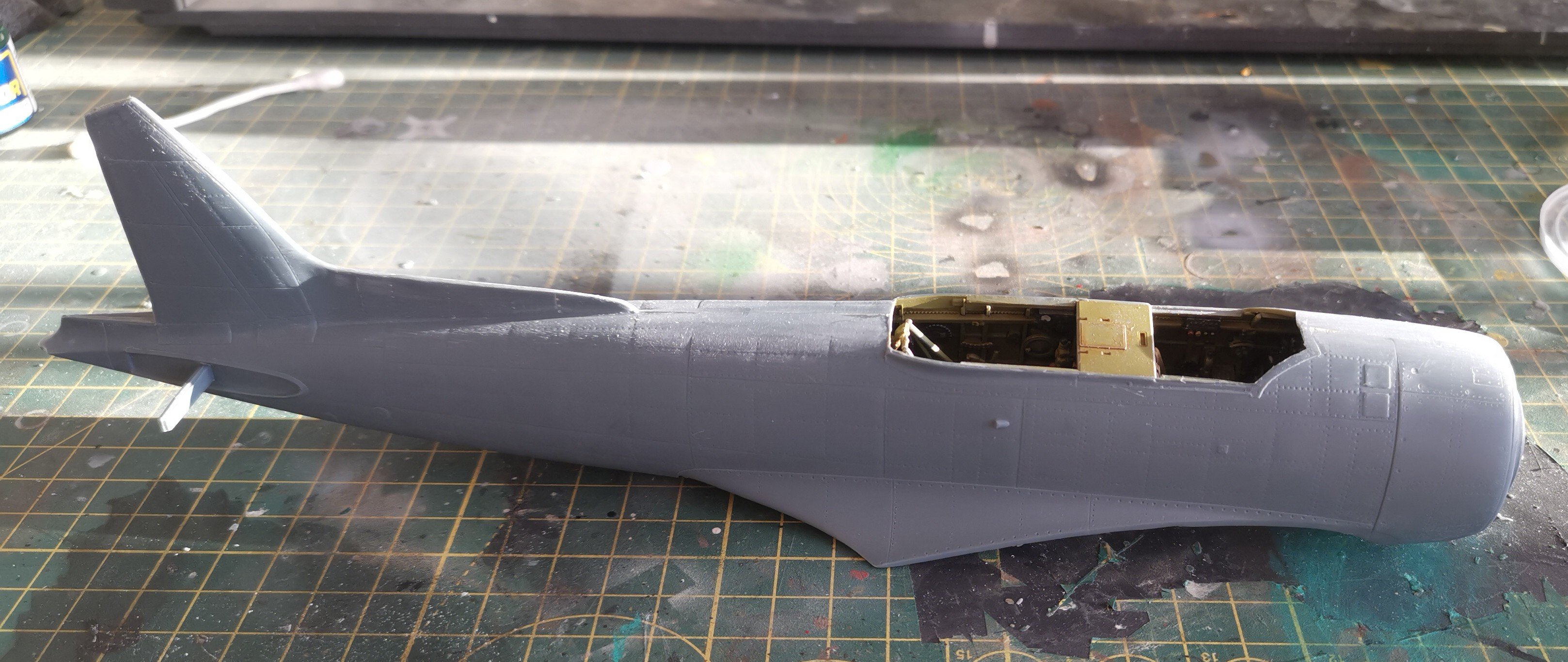

Fuselage is together now and the seam clean-up is completed. Just a tiny amount of filler and CA needed as the fit is very good - the spar for the tail fins and the firewall line everything up nicely which compensates for the lack of location pins.

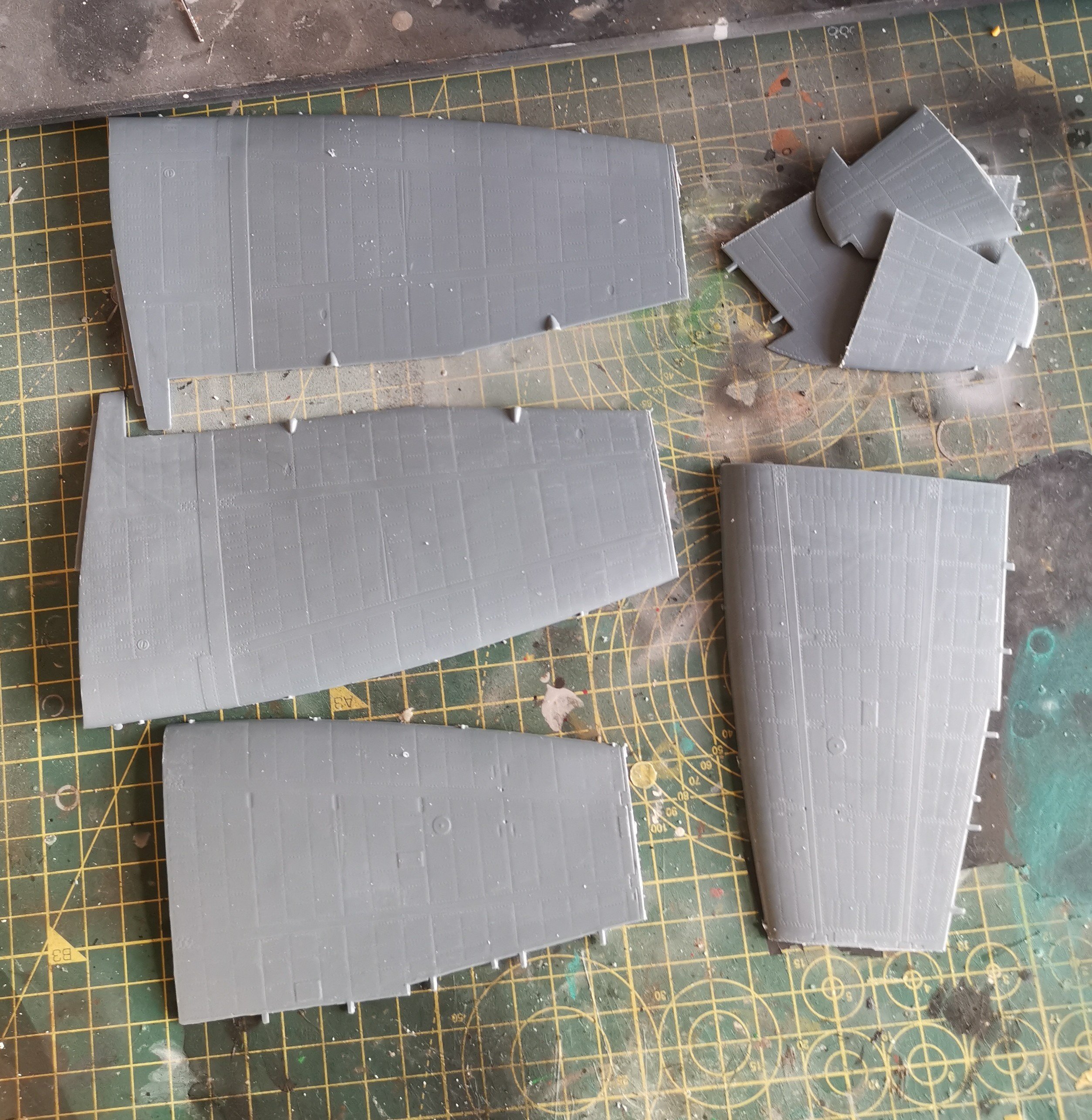

There's a fair bit of rescribing to do but that's a task that I have to be in the mood for, so it'll wait for a bit until it's time to join the wings to the fuselage. That'll be a while away as I think it's going to take a bit of time to get the wing fold mechanism all done.
No going back on the wingfolds now! 😆

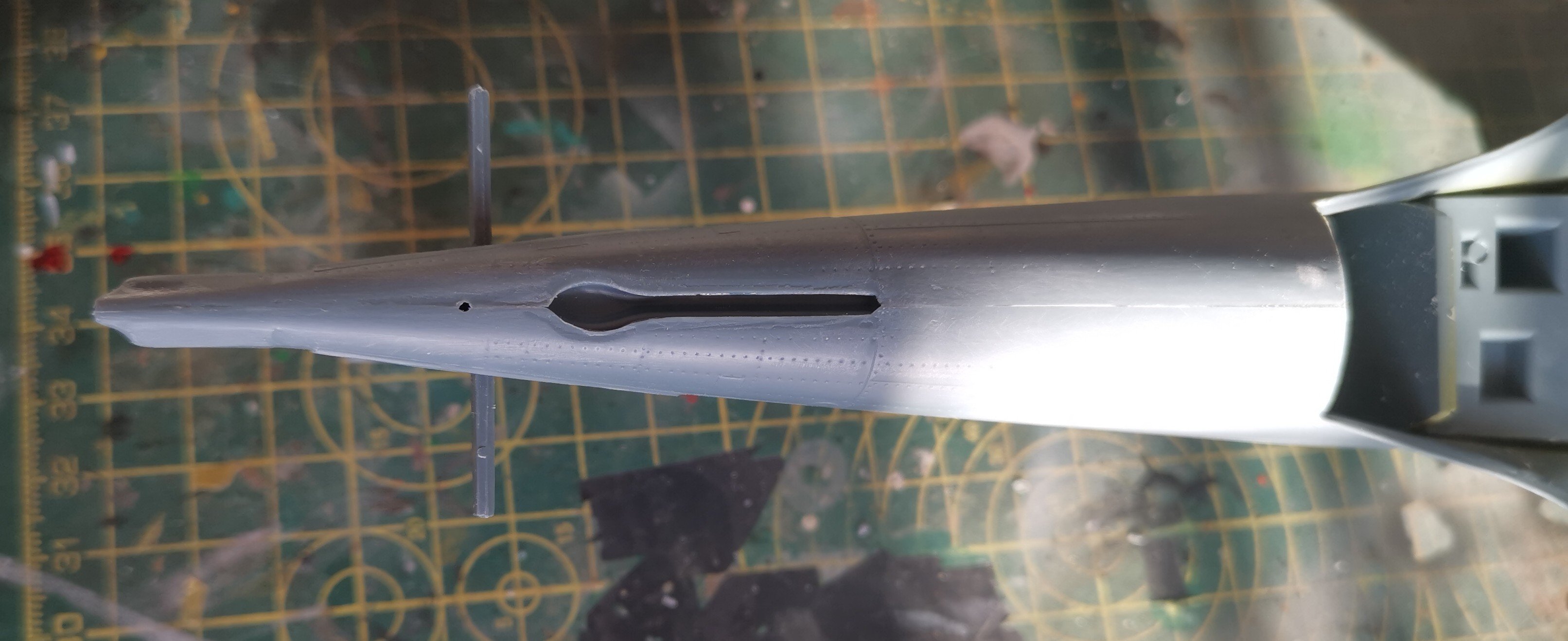

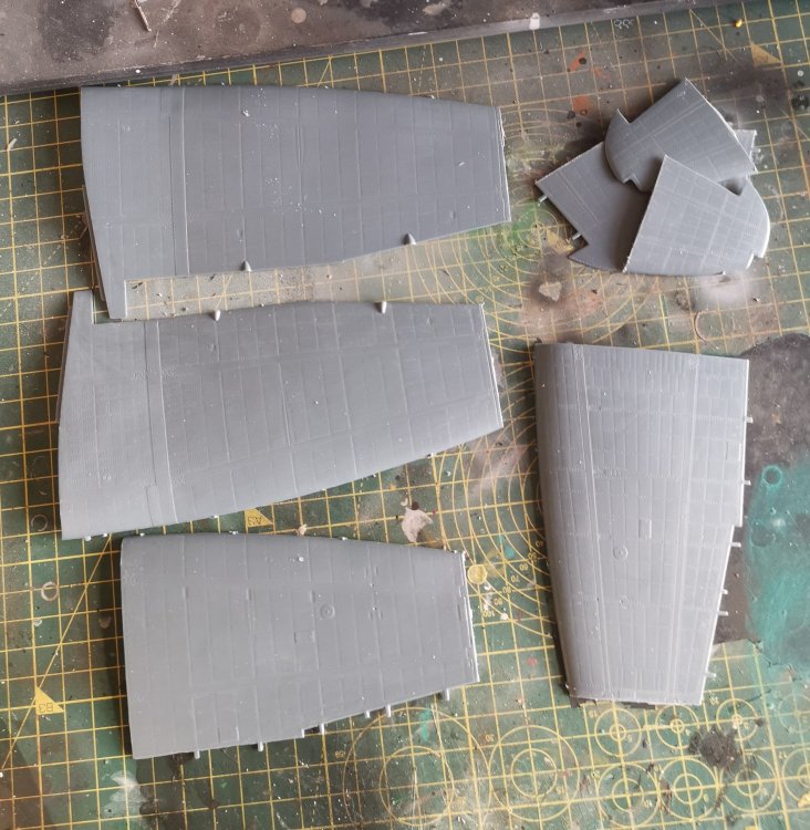

Seems wrong taking a razor saw to a kit like this but the deed is done now.
I have the set of markers from AK and find it better to use white under yellow and red.

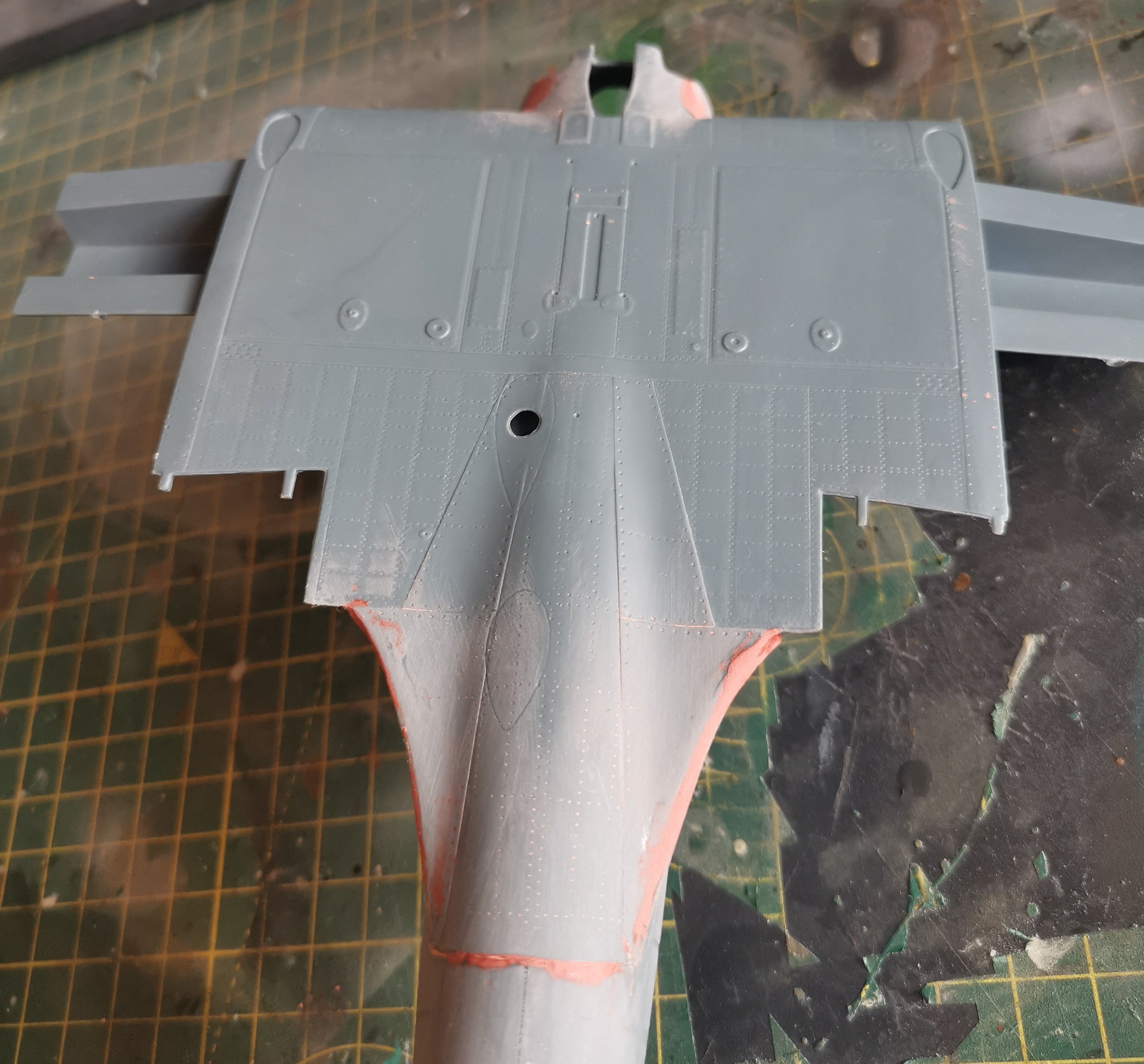

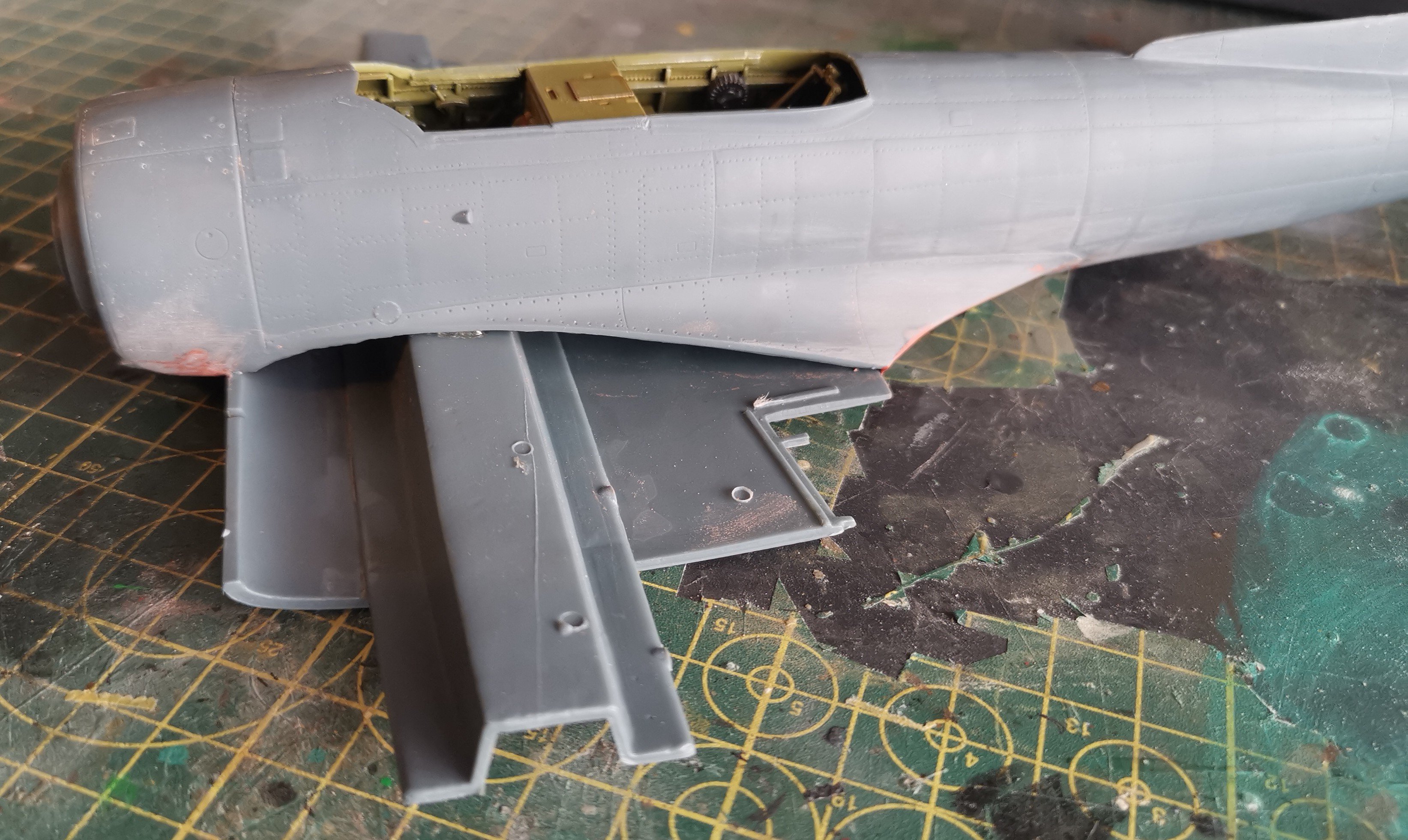

Underwing centre section is attached with the chunky spar to ensure the dihedral is correct. I wasn't convinced by the amount of gluing surface available, so this is attached with BSI 5-minute epoxy to make sure it's going nowhere.
As Ernie emphasised in his build, you've got to dry fit everything before you commit to glue - I had to thin the top of the spar on one side to stop it catching on the bottom of the cockpit floor but everything seems to be lining up correctly now.

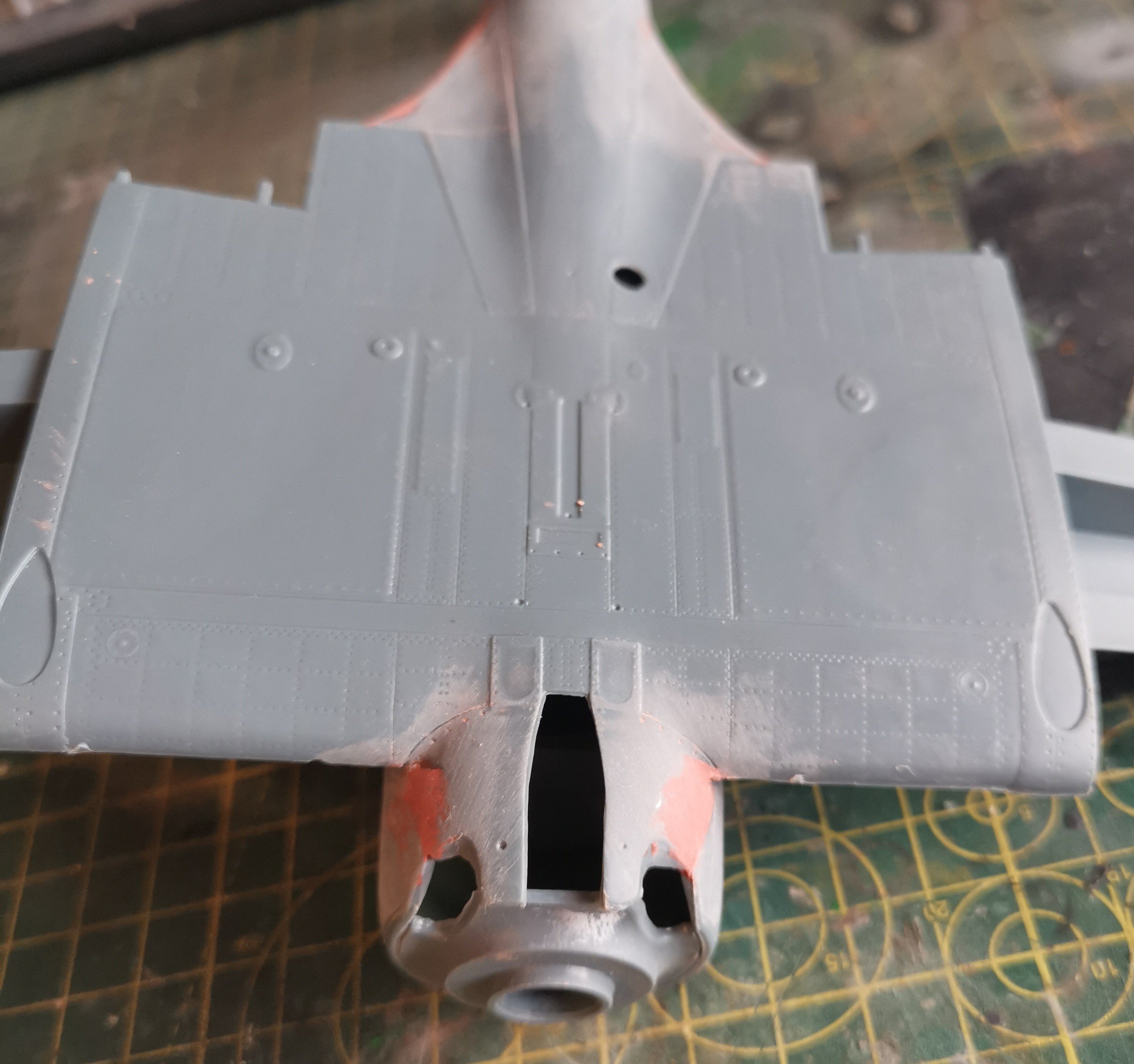

First round of filling on the gaps with some Bondo. Next is a second round with Tamiya grey filler, then a proper sanding and reinstating all the detail.

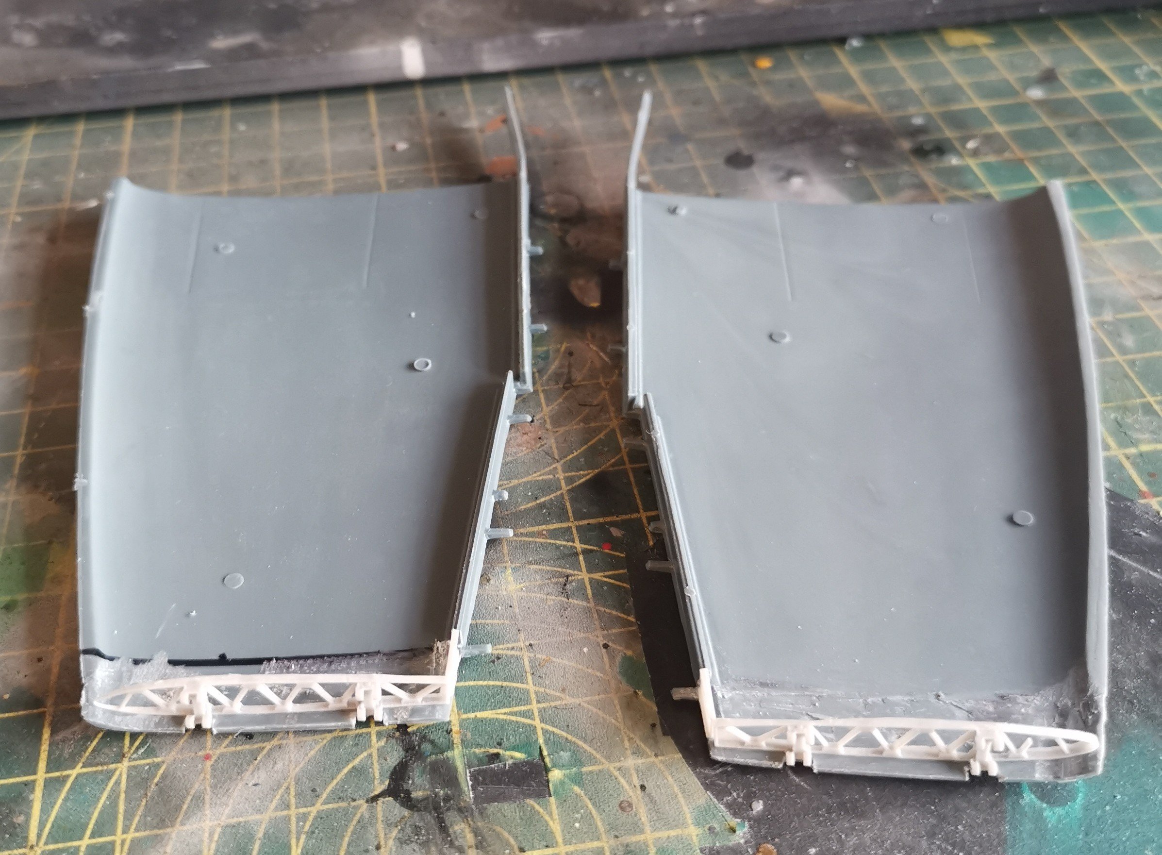

Also got the initial resin parts in place for the wing fold mechanism. Thinning the inner surfaces sufficiently was stressful and tedious - you don't want to go too thin but the tolerances are so tight that you've got to push it a bit.
If anyone has this set you'll notice that there is supposed to be an inner set of spars 1cm in from the edge (at the marked line) but these will be totally invisible and serve no structural purpose so I made an executive decision and ditched them as the thought of fiddling with tolerances twice was too much to contemplate!
