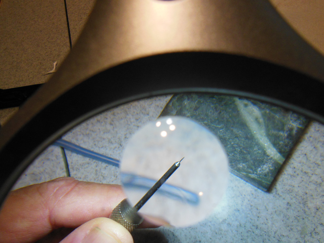

Bill_S Posted September 5, 2020 Posted September 5, 2020 16 hours ago, DocRob said: Thanks Bill, it's so easy to break these frames and on the W.12 there is a strut protruding from the frame to support the upper wing, guess what happened... . About the wiring, I thought the same way until I saw, how tiny the horns on the steering column are. I seem not to be able to drill a 0,2 mm hole into it for fixing the fishing line. How did you solve that problem? Thanks Carl, in the moment the leather padding is only painted to have it done for the inside. I think for the outside, I will use liquid mask and if there are irritations after peeling the mask, I will redo it, easy with oils. Cheers Rob Rob, years ago, they were throwing away a box of these drills at work - they were used for drilling precise fuel metering holes in carburetors. You can ones used for drilling holes in printed circuit boards in even smaller sizes (this one is about 0.25mm). I use good magnification, too! 3 1
DocRob Posted September 5, 2020 Author Posted September 5, 2020 1 hour ago, Bill_S said: Rob, years ago, they were throwing away a box of these drills at work - they were used for drilling precise fuel metering holes in carburetors. You can ones used for drilling holes in printed circuit boards in even smaller sizes (this one is about 0.25mm). I use good magnification, too! Thanks Bill, these drills look good, they are so short, they won't bend a lot. I use a 0,2mm drill in a pin vise. The drill bends a lot and it's difficult to start drilling, even pinning the hole with a needle before. If you set the drill deep enough into the vise, there is no bending anymore, but you can't see where you drill. I will look, if I can find your kind of drill somewhere. Cheers Rob 2
DocRob Posted September 5, 2020 Author Posted September 5, 2020 Today I managed to do some little things, I didn't dare yesterday. After thinking about the attachment of the control wires, I decided to give it another try with drilling the horns. If that wouldn't have worked, I would have sliced the ends of the horns to glue the wire in. I got sthem drilled somehow with my 0,2mm bit and glued the fishing line in with CA and left it to cure. The rudder pedals got tiny holes then and I drilled the return rollers in the frame part as you can see for putting around the rudder wire. Then I dirtied up the white parts of the interior with olive green and light gray oils. Cheers Rob 5
BlrwestSiR Posted September 5, 2020 Posted September 5, 2020 5 hours ago, DocRob said: Thanks Bill, these drills look good, they are so short, they won't bend a lot. I use a 0,2mm drill in a pin vise. The drill bends a lot and it's difficult to start drilling, even pinning the hole with a needle before. If you set the drill deep enough into the vise, there is no bending anymore, but you can't see where you drill. I will look, if I can find your kind of drill somewhere. Cheers Rob Rob, Tamiya makes some drill bits that might be what you're looking for. Carl 4
DocRob Posted September 5, 2020 Author Posted September 5, 2020 Thanks Carl, perfect, I will try to get those. Cheers Rob 1
