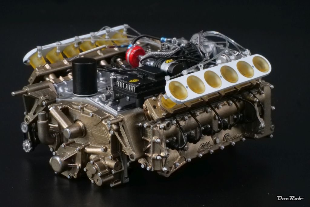

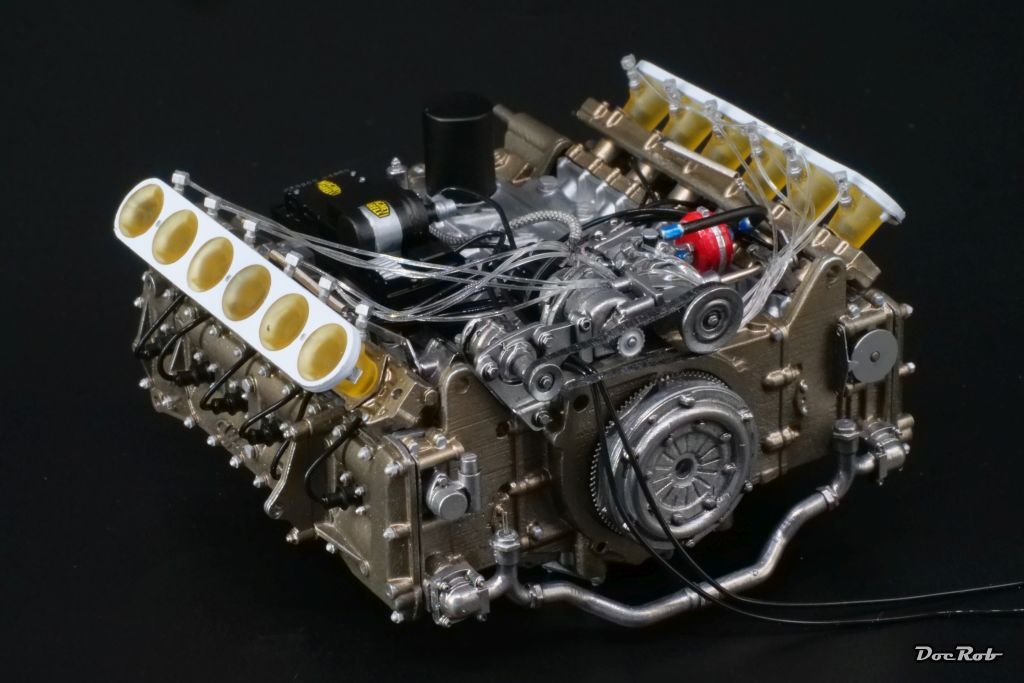

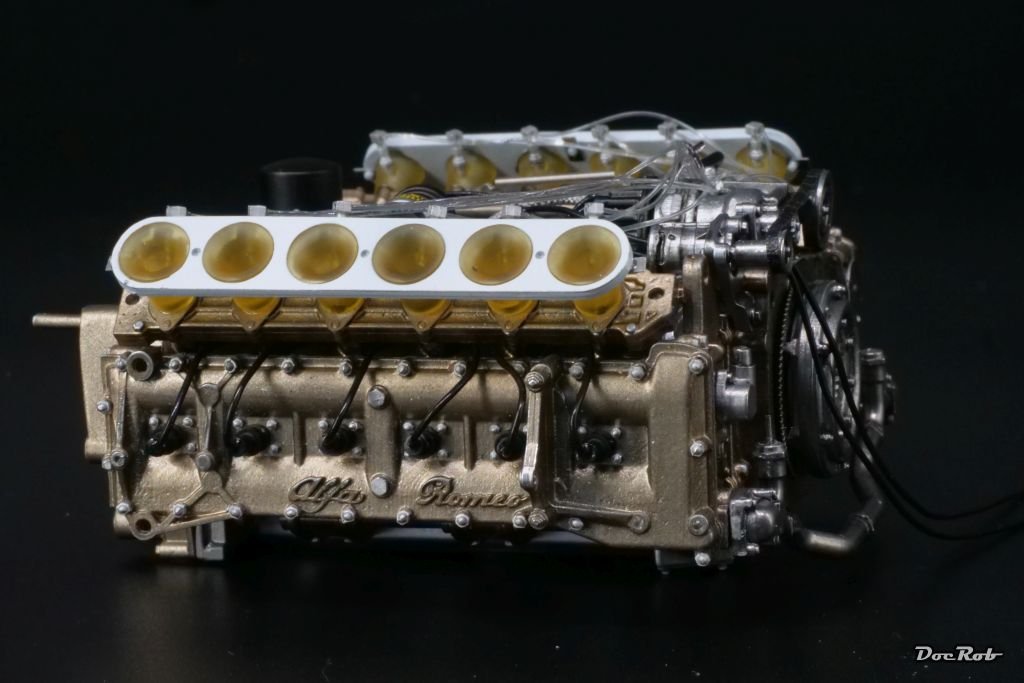

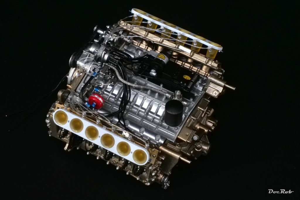

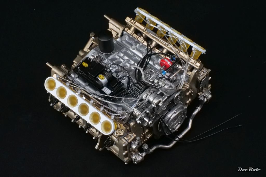

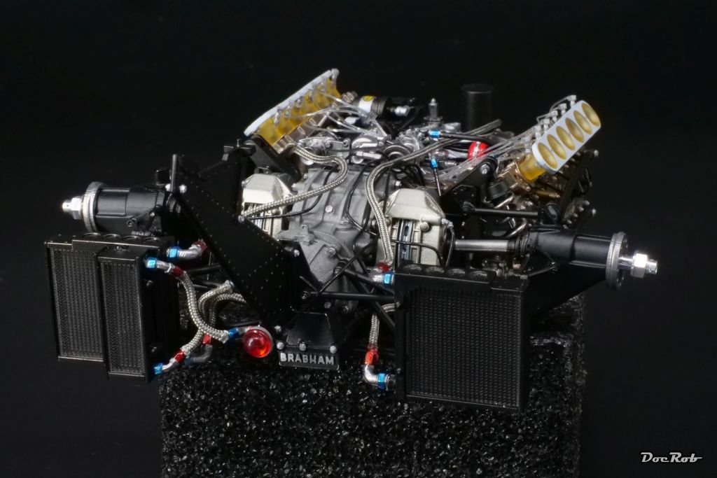

DocRob Posted May 18, 2025 Author Posted May 18, 2025 Today, I finished the engine so far. There will be some more wires and tubes added later, but this will happen after installing the gearbox and body. In comparison with the transparent fuel lines, the addition of the wiring was relatively simple. Electronics and some other parts got added on top of the engine. For the first time, I used markers for detail painting, like screwheads and bolts, in this case a silver Playmarker from AK, which covered well, even over black paint. I may add cable binders to the fuel lines and ignition wiring, but the ones, I tried failed miserably. They were 3D printed flexible decals from MFH and I managed to break four and got one installed and then gave up, so definitely no recommendation here. I think, I will use etched ones. Another thing, I don´t like about the MFH manual is that there are no wiring length given and far worse, some wires or tubes lead to nowhere in the picture of the manual, which leaves you browsing through the pages and looking for the right connection, which probably isn´t there and the wire ends hidden somewhere in the body. A bit more clearness would be appreciated. Cheers Rob 9 2

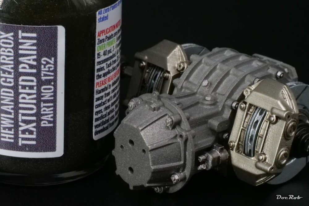

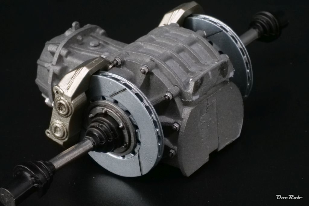

DocRob Posted May 21, 2025 Author Posted May 21, 2025 Next was the suspension, which is directly attached to the engine. The damper rods were painted with AK´s chrome marker and look really chromish, not like the to my experience really bad Molotow marker. This was followed by prep work and drilling for the gearbox section, where a lot of bolts and screws are to be added. For painting the gearbox, I used Zero Paints Hewland Gearbox Texture paint for the first time, because it is a Hewland gearbox and have to say, I like the result, at least for a 1/12 kit. I followed the recommendation of using a larger nozzle on my airbrush (0,4 mm) and raised the air pressure to almost 3 bar or 40 psi, to prevent clogging. The brake disks were sprayed with Extreme Color stainless steel, therefore the slight bluish tint and the calipers were sprayed with duralumin. Cheers Rob 7

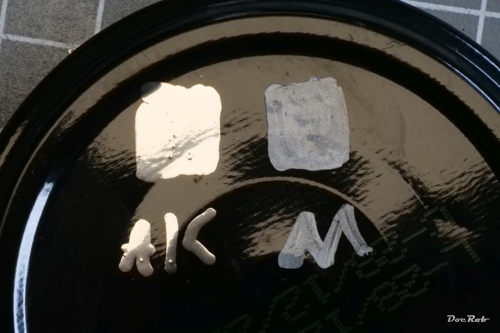

GusMac Posted May 21, 2025 Posted May 21, 2025 Looks great Rob. What issue did you have with the Molotow marker? I've only used mine a couple of times but have always found it pretty good. 3 1
DocRob Posted May 22, 2025 Author Posted May 22, 2025 11 hours ago, GusMac said: Looks great Rob. What issue did you have with the Molotow marker? I've only used mine a couple of times but have always found it pretty good. Thank you Gus, a while ago, I ordered some chrome markers and used them on different builds. I forgot, that they were of different brands and used them for headlights and oleos mostly. I always tried them out on a piece of scrap plastic and only one delivered. Then I realized, I had two brands and the Ak was looking like chrome, where the other two from Molotow looked grainy gray and were a complete fail. I made a quick pic on an unprimed piece, both markers shaken and pumped freshly, night and day. Cheers Rob 3 1
HubertB Posted May 22, 2025 Posted May 22, 2025 I have a similar experience with my Molotov chrome pens. They looked great when "fresh", but now that hey are a few years old, the "chrome is all but gone, even after some vigorous reshaking. But I can vouch for AK's Super-Chrome. WOW ! I bought a bottle to try and it's fantastic, whether you use it with an airbrush, or a brush. You' ll see the effect when I post some pics of the LG of my Cutlass. Hubert 3 3
GusMac Posted May 22, 2025 Posted May 22, 2025 Yes, that's a pretty stark difference Rob. My Molotow pen is only a few months old, so I'll need to watch and see if it goes 'off' as Hubert says. Will definitely check out the AK option. I've used their Extreme Metals and found them very good. 1

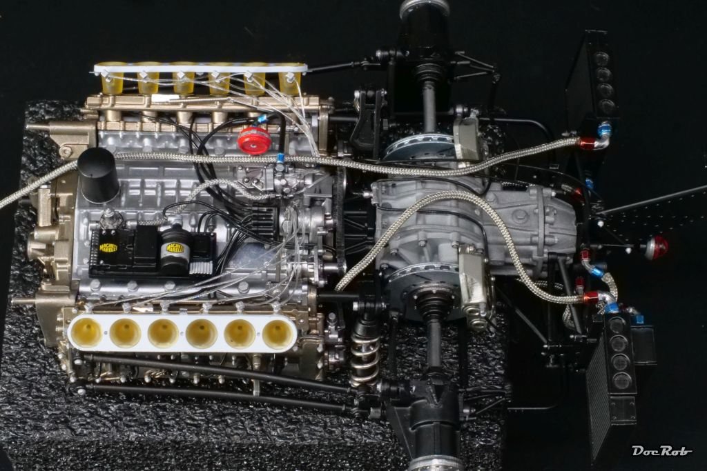

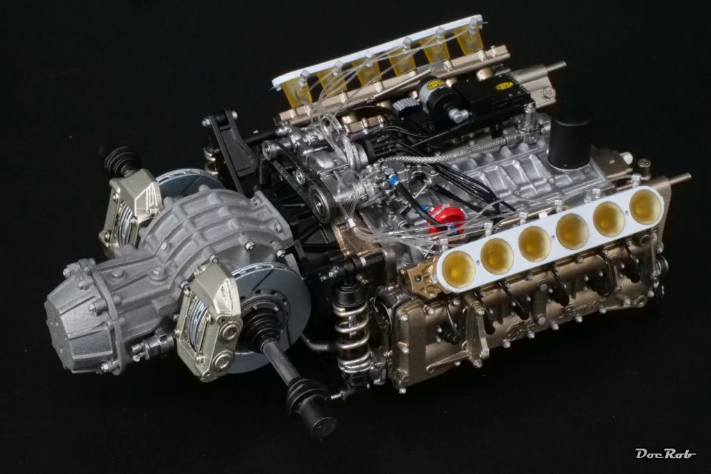

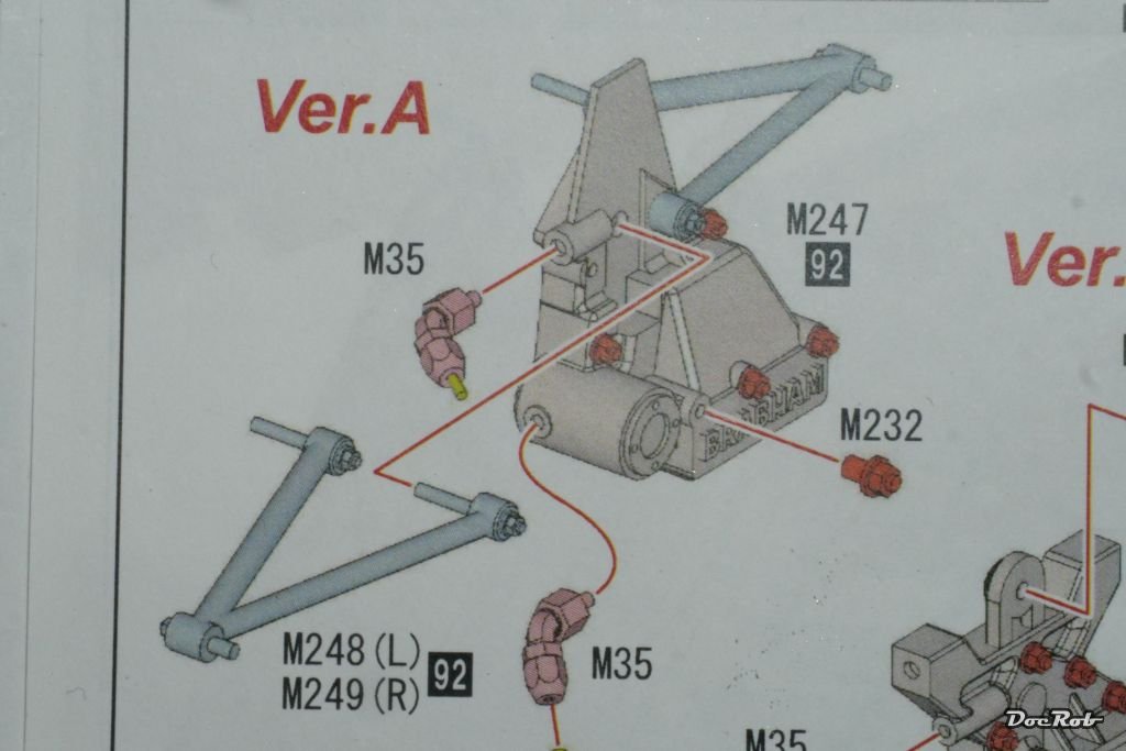

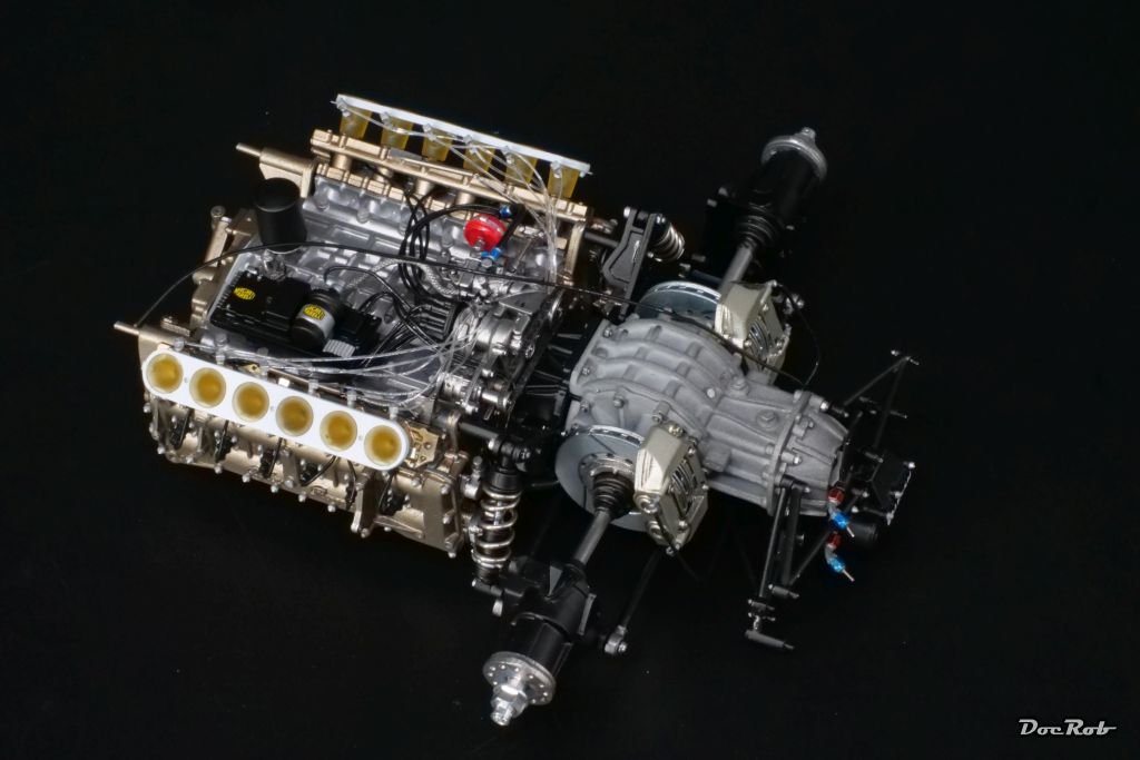

DocRob Posted May 23, 2025 Author Posted May 23, 2025 I finished the gearbox assembly step and started with the braking tubes. The fittings were badly casted by MFH, so I substituted them with resin ones. I stopped with the tubing and wiring for now, as I think, it´s easier to do it later, where it becomes more clear, which hose leads where. If there is anybody out there building the same "Press Version" of the BT45 be aware, there is a mistake in the manual, which can only be discovered, when analyzing later steps. Part 248 (9) doesn´t go into the shown hole, but in the one to the left. It took me a while to figure out, how the supports for the coolers (248 (9)) will properly sit. The shown hole accepts the rear wing support later. Cheers Rob 5

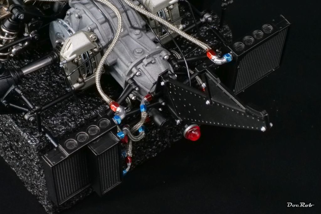

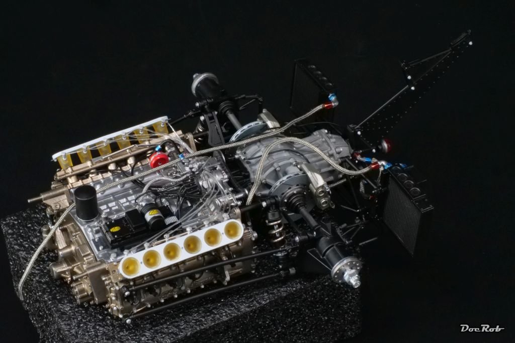

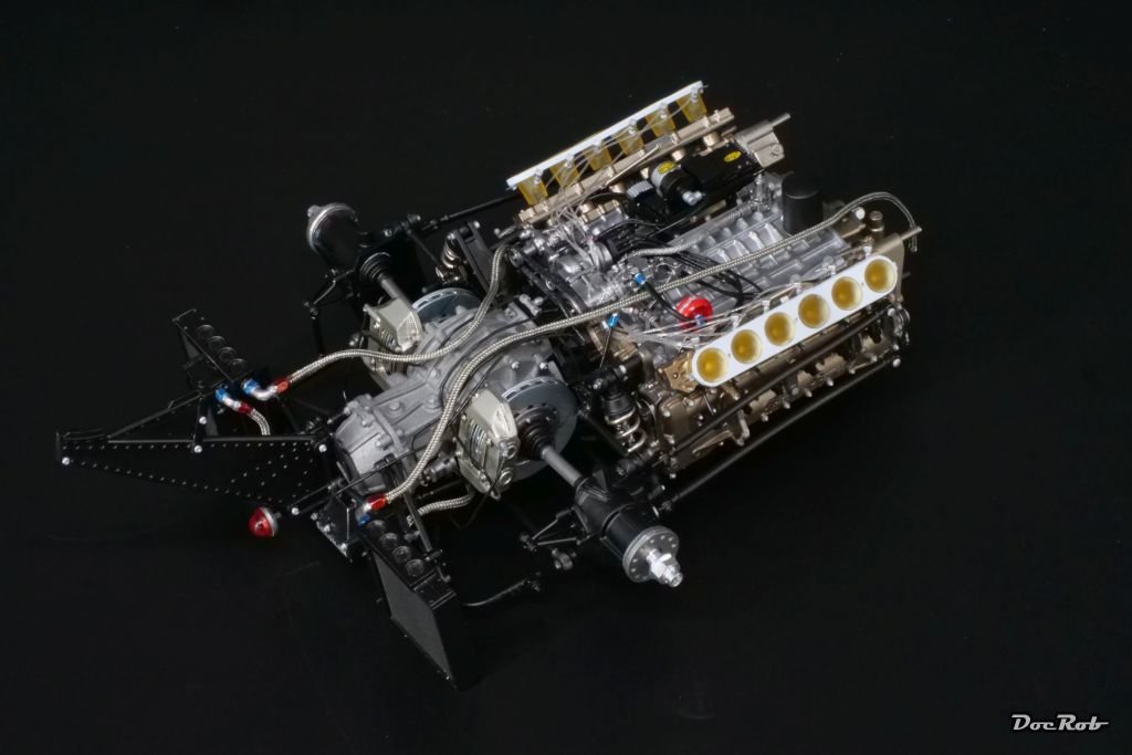

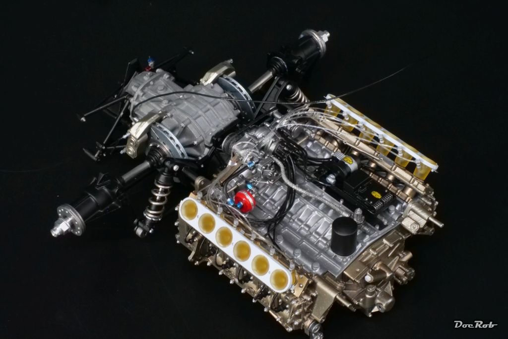

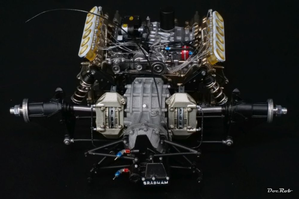

DocRob Posted May 29, 2025 Author Posted May 29, 2025 Chapter 9 of 20 in the manual is done and the rear section got finished sans the wing. Connecting the gearbox with the engine proved a little tricky due to numerous connection points, there is the suspension with adjustment bars, side rods and a shaft to connect all at the same time, trying to insert the screws for fixing everything. In the end it worked. Another annoying part were the brake lines. The angled tube fittings provided by MFH were badly cast and I used resin ones from the spare box, but two of them broke and needed to be drilled out again. I also substituted the white cast braided lines from MFH with braided textile hoses from Top Studio, which were far easier to work with. The cast ones need to be lengthened and bent, then drilled out with a 0,5 mm drill bit at the ends, to accept the fittings. Needless to say, that wiggling some of them in is nerve testing. The textile Top Studio stuff only needs to to be lengthened and then stuck on the 0,5 mm rods of the fittings with a drop of CA. Even my relatively liquid go to CA doesn´t soak and darken the braided hose. Cheers Rob 8
BlrwestSiR Posted May 29, 2025 Posted May 29, 2025 Your work looks so clean and precise there Rob. Nice choice on swapping out the braided line. 1 1
DocRob Posted May 29, 2025 Author Posted May 29, 2025 2 hours ago, BlrwestSiR said: Your work looks so clean and precise there Rob. Nice choice on swapping out the braided line. Thank you Carl, There are so many details on these engines, it´s easy to hide tiny hick ups . In fact, there is a little touch up work to do later on. Cheers Rob 4

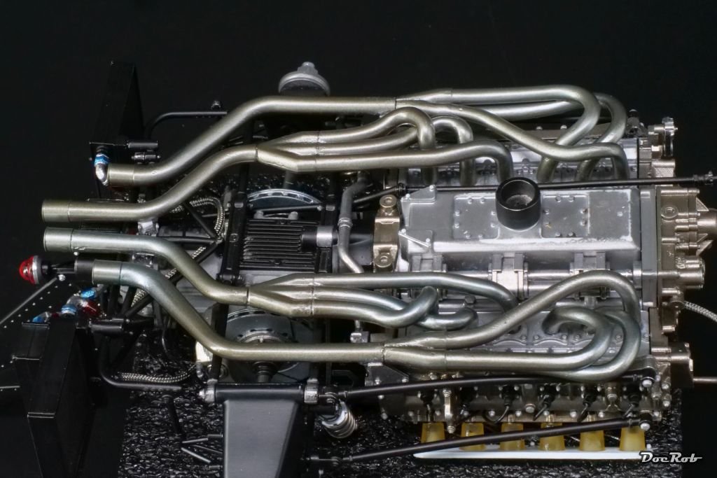

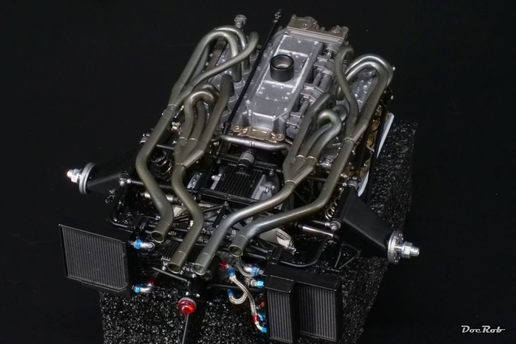

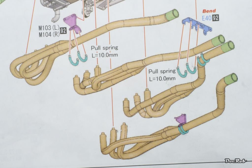

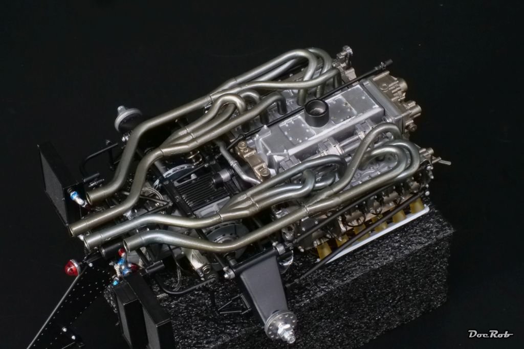

DocRob Posted June 10, 2025 Author Posted June 10, 2025 After a little pause, caused by one of my birthday presents, a week trip to the beautiful town of Valencia, I continue with the Brabham. I left the kit with the prep work for the exhausts just started and dreaded continuation, as F1 car exhausts can be a nightmare to build up. I cleaned all the parts and grouped them, followed by drilling all needed connecting holes. I then test fit the manifolds and glued the parts together with CA. MFH claims silver for the exhausts, but what I saw on pictures led me to think of brownish stainless steel. I used metal etch primer, followed by AK´s exhaust manifold and accentuated it with metallic blue for heat staining. While assembling, I tried to install the always dreaded coil springs before ore after inserting the exhaust, but failed. If I have a good idea, how to install these, I do it later or improvise somehow. As a preview, I started to prepare the monocoque parts, which need to be finished in polished aluminum. I´m unsure, If I airbrush the aluminum or if I polish it, which will be difficult due to the shape of the parts. Cheers Rob 7
Landlubber Mike Posted June 11, 2025 Posted June 11, 2025 Happy birthday Rob! And that engine looks spectacular, really well done! 1 1
DocRob Posted June 13, 2025 Author Posted June 13, 2025 On 6/11/2025 at 5:23 PM, Landlubber Mike said: Happy birthday Rob! And that engine looks spectacular, really well done! Thank you Mike, I enjoyed the Valencia trip a lot, fine weather, good food, wine, art, science and beautiful architecture in a very relaxed city. The flat 12 engine was one of the reasons, why I chose the BT45. I was very close before buying a McLaren M19 instead, but it had the same Cosworth CSV engine like my Lotus 77, my Brabham BT44b and others in 1/20, yawn. Cheers Rob 1
