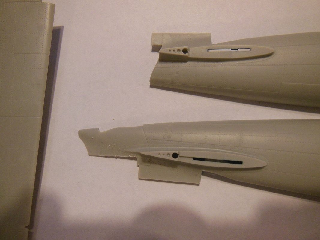

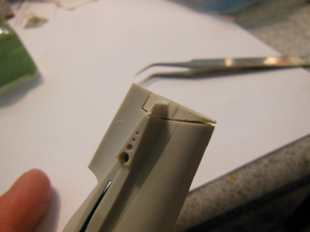

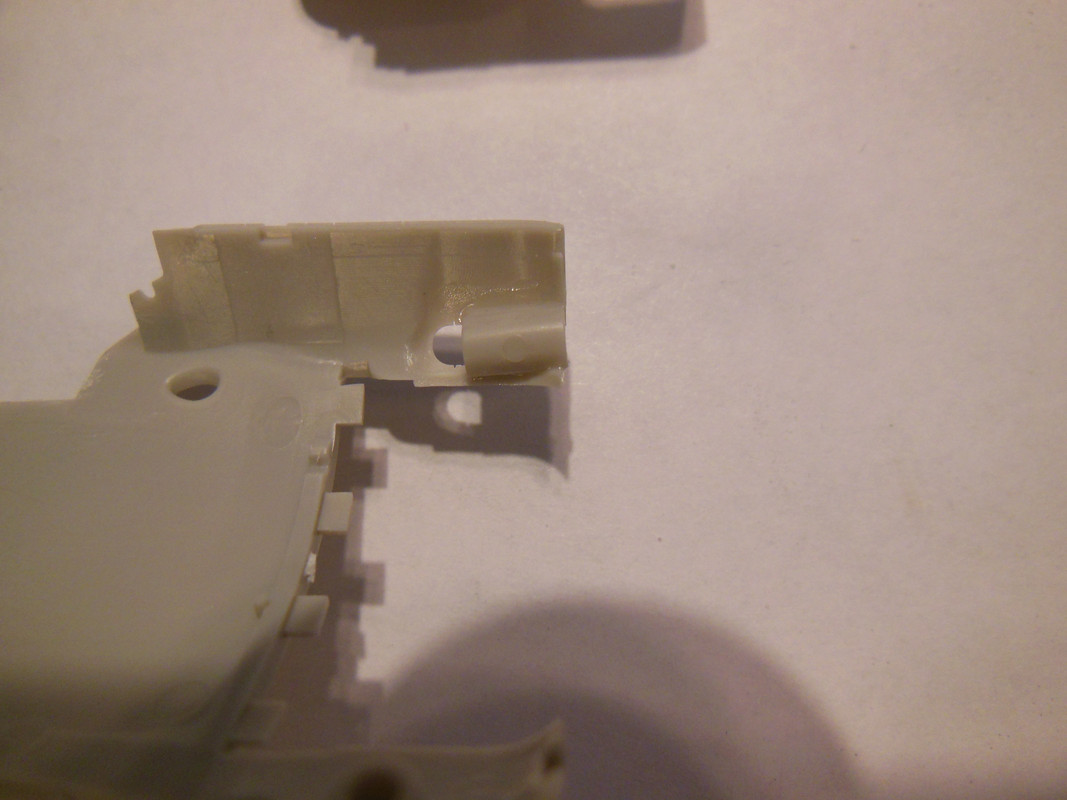

Now for the cut to remove the tail... The cut follows panel lines, and isn't the easiest thing to do.
Both sides cut and resin plug fitted. Still some tweaking, and it will take some filler, but I'm not displeased.

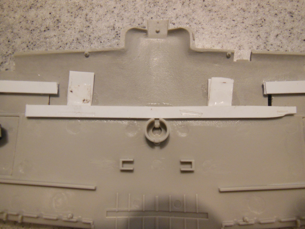

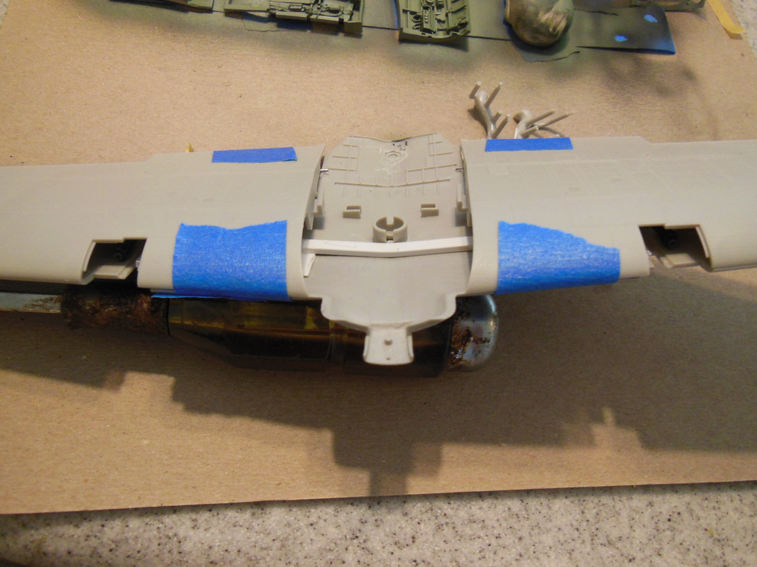

A little progress... Forward center section of the lower wing was cut out. I added some backing material, and some shims to fit the MDC insert.
Some filling, sanding, and rescribing will be in order, but it's to be expected.
Checking the fit of the upper wings. All appears good.

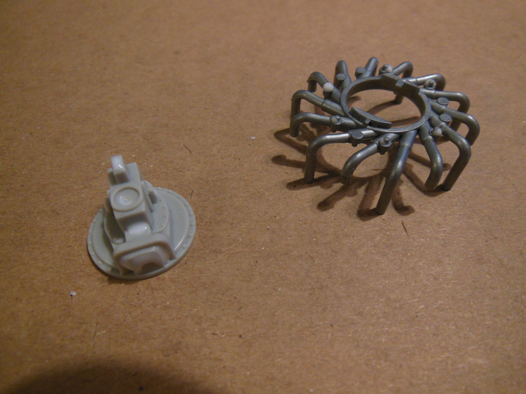

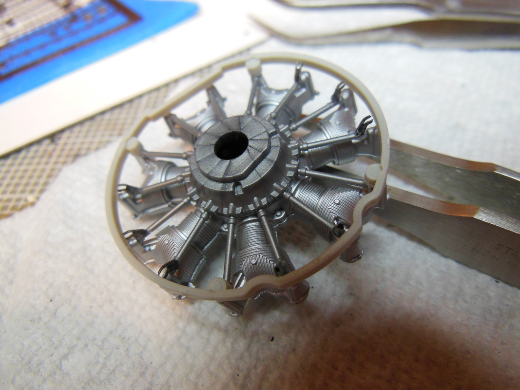

I have to be in the right frame of mind to paint the details. Until I'm ready, I've started on the engine. I used Elmer's to mask areas to be cemented.
Cylinder heads were sprayed with MM Metalizer Aluminum. I'll follow that with a black wash to show some detail. Crankcase will be a 50/50 mix of IJN Gray and RLM 65. I've added some tiny Eduard PE details from their A6M5 engine set. They're tacked with white glue. Once dry, I'll CA them in place.
Coming together greatly Whatever Elmer's is, I like the idea of masking to be cemented areas while painting, simple, but I haven't heard of before. I'm always scratching with a blade after painting with the risk of ruining something, so thanks for the idea.
Thanks, Rob! Elmer's is just cheap white school glue.
