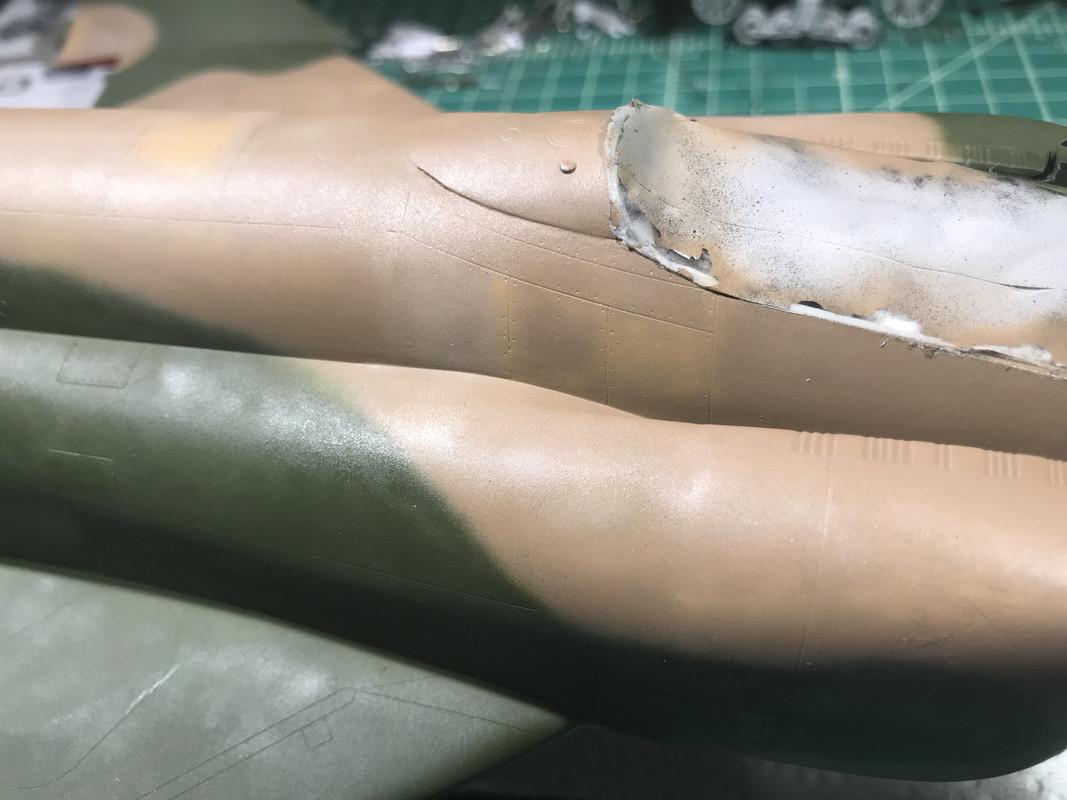

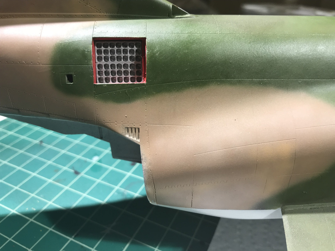

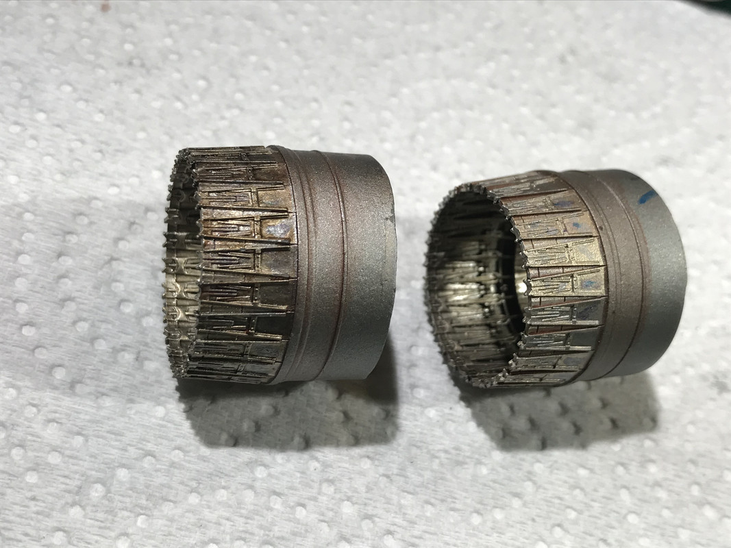

SapperSix Posted April 23, 2019 Author Posted April 23, 2019 Lots of ground covered over the last couple days. I have found myself with a bit more free time than usual and have spent some of it on the work bench. Lots of paint shading and detail on the fuselage. Many hues of of the camouflage were experimented with. In the end I am very happy and eager to see the final harmony of it all. In some areas I did get a little loose with maintenance wear and tear. More on that later. I spent some time looking at the flare dispensers for fit and finish. I noticed that after all the re scribing and riveting alterations and modifications I made on the plane, I failed to make the changes in this area. I dont think I am going to re do the work. I will at least sleep on it. I turned the paint being taken off from the tape in to chipping. And did some real chipping. . The center line tank and some experimentation. More to follow. For the tires I had to make custom masks from Parafilm. The center of the main landing gear is actually painted in the old testors rubber color and not flat black. Its going to end up with a much more rusted look and the testors rubber paint already leans that direction. A little chipping was also applied. Dry brushing and pastels to come. I will come back tomorrow and give more detail. Time for bed after a good day on the bench. Thanks for looking and all the fine advice. 6

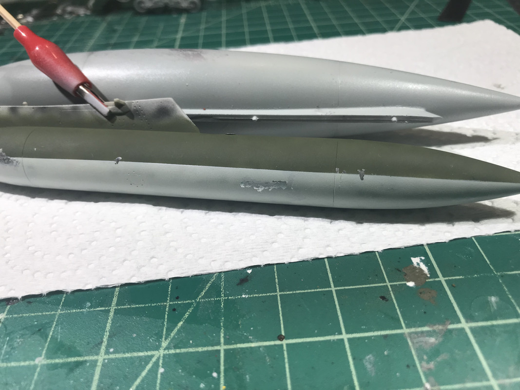

Jeff Posted April 23, 2019 Posted April 23, 2019 I need a tutorial on the chipping method....................................... when you have time............ the fuel tanks look excellent... 2
SapperSix Posted April 26, 2019 Author Posted April 26, 2019 On 4/23/2019 at 12:42 AM, GazzaS said: Frank, Glad to see you powering along. Gaz Gaz, It has been a real pleasure to focus, completely, on modeling. Its a rare thing in my life, but I predict more bench time in the coming months. On 4/23/2019 at 5:15 AM, Jeff said: I need a tutorial on the chipping method....................................... when you have time............ the fuel tanks look excellent... Google is far more knowledgeable than I. However, below is how I did it, your experience or technique will vary... 1.) Good base primer (Dry overnight) 2.) Cover primer with coat of paint to be the exposed through the chipping process. I used MM Steel, and Chrome Silver. (Dry overnight) 3.) Put a nice coat of hair spray down. I used Aussie hair spray, decanted, as that is what I was able to steal from the wife and daughter. Then mixed with a little bit of Tamiya X-20 Thinner. About 50/50 mix, although your spraying technique may require something different. Thickness of this coat seems to affect the type and depth of chipping. I am still getting familiar with this technique. (Dry overnight) (You can put down multiple coats of hair spray and chipping paint layer to create two or more layers of chipped paint) 4.) Put main camo coat down. (Dry overnight) 5.) I used a wet Q-Tip to rub on the paint until chipping began. This length of time and amount of pressure that is to be applied depends on the paint and thickness of coats. I also used a toothpick that had the sharp end dulled a little to make deeper more obvious chipping. 6.) And then I augmented using the fine paintbrush chipping method to replicate fine chipping. I have seen people say you can only do this with a acrylics or maybe enamels. I have used a mix of both and while there at are differences it always has seemed to work. I am sure there is someone that is expert on this that might expand on this. Thank you for the kind words. More detailing to come on those tanks... 5

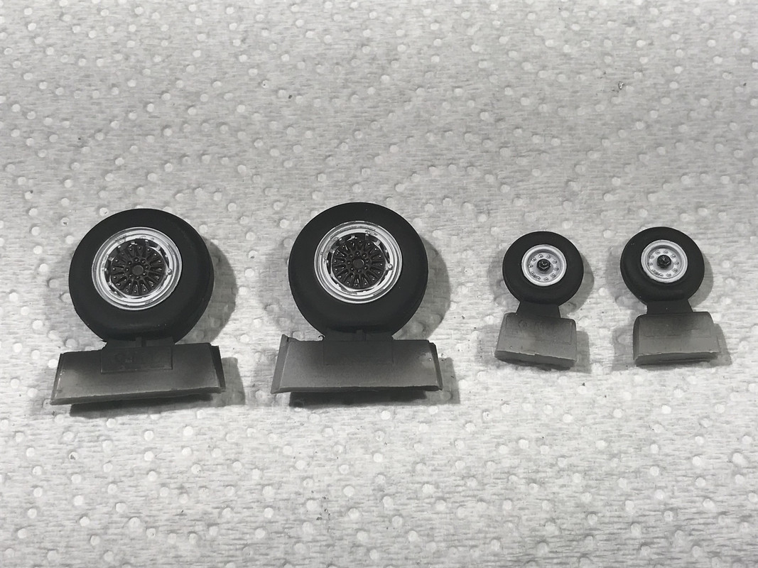

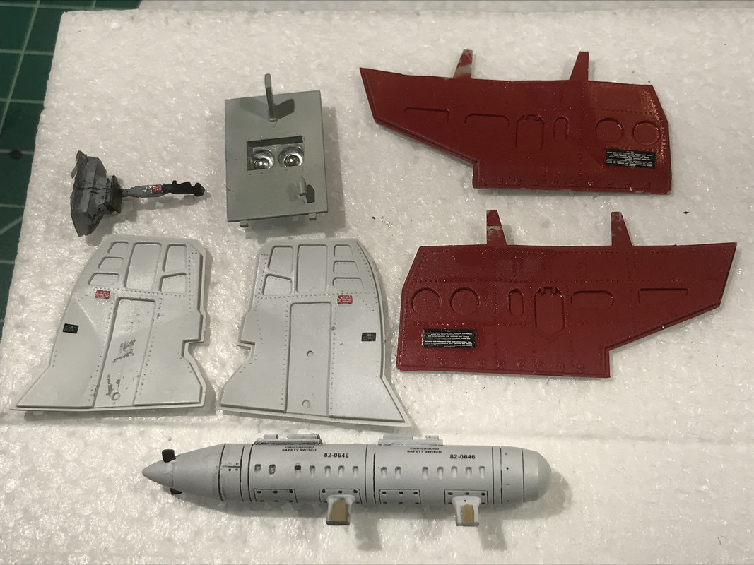

SapperSix Posted April 26, 2019 Author Posted April 26, 2019 I am amazed how deep the hole can be when one is tracking down information when striving for a painfully accurate build. I have began to understand the pain of those we call bolt counters. The below work took a good bit longer than I had expected. Just to put a few placards on I kept finding different or incomplete information. The main wheel well cover had a multitude of varying examples. By the time I said "Screw it, get it done!" about 4 hours had passed as I tracked various references and online sources. The Eduard placards had incorrect colors for the afore mentioned placard for the RF-4C. Which led to a little looking around. The speed breaks are very much straight forward. The ALQ-71 has completely false numbers and decals on it. I couldn't find many period examples. I was going to have to make some decals but instead opted to us some remainders to achieve an effect. Now I feel like I have cheated on a test....I will probably have to go back and make actual decals to assuage my mind. Still I have learned so very much. Having said that, my next build will probably OOB. 7

Jeff Posted April 27, 2019 Posted April 27, 2019 So as I am an enamel guy, I am supposing that can be used as well as you mention........ I am trying to step into the 'dark' side of acrylics, but as my past experience wasn't good ( years ago before new technology) I am hesitant to step into the deep end of the pool....... Thanks for putting it in layman's terms too..... I will most likely give that go............. 3

SapperSix Posted May 4, 2019 Author Posted May 4, 2019 On 4/27/2019 at 5:55 AM, Jeff said: So as I am an enamel guy, I am supposing that can be used as well as you mention........ I am trying to step into the 'dark' side of acrylics, but as my past experience wasn't good ( years ago before new technology) I am hesitant to step into the deep end of the pool....... Thanks for putting it in layman's terms too..... I will most likely give that go............. Give it a go. For me enamels just took more work to expose the chipping layer. I have never used enamels to perform double layered chipping and acrylics seem to come off a little easier. But again, density of coat seems to make a big difference. You are welcome, anytime. 4

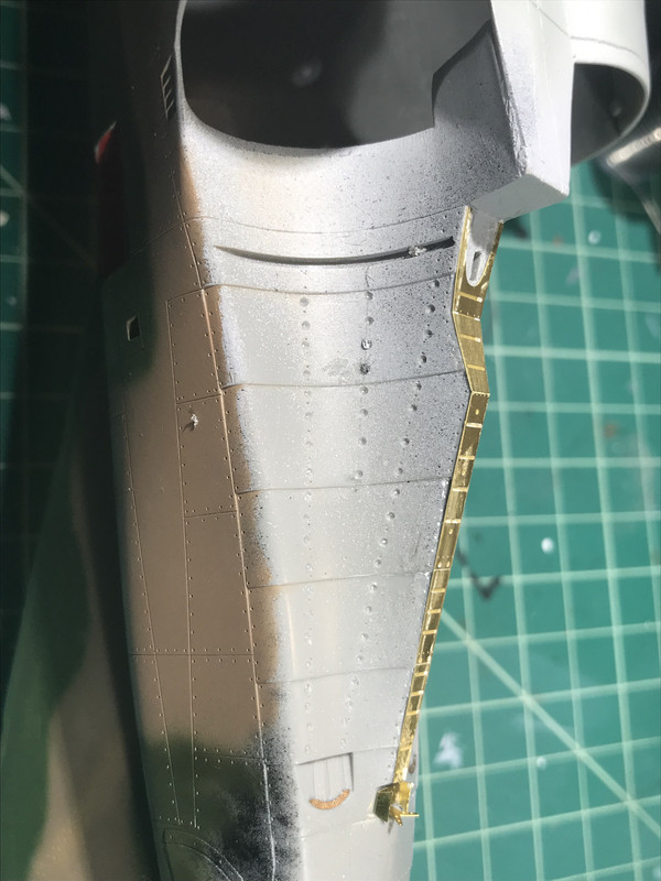

SapperSix Posted May 4, 2019 Author Posted May 4, 2019 I was getting ready to put some primer on the NMF tail of the Phantom. That's when I noticed that the rivets are all wrong, far too small. The reference picture verses what Revell did.......big difference. What to do? So looked at some other builds. The examples I found were few. Enlarging the rivets in the tail section would be a multi part process. I did choose to use the diameter of 2MM for the new rivets, not to scale, but I already had the 2MM drill and some wire or plastic round tube at the same diameter. I wasn't willing to place another order for a punch or more stuff. So I will have get rid of the small Revell rivets and replace with a large diameter washer and rivet. I am using the 2mm hand drill to get a MM deep or so. Then cutting some lead wire, putting it in the hole to be lightly sanded later to replicate the washer. I cant decide how I am going to recreate the actual rivet (If thats what it is). Making the new holes, and looking as to how I am going to plug the old small ones. All the rows of larger rivets are now drilled. Two of them with the first lead large rivet attempts. If someone else has any ideas on this I am open to learning..... 5
harv Posted May 5, 2019 Posted May 5, 2019 I have the Tamiya and its a bit different. The front ones, that you are working on were quite good. The back ones, no. It looks like they are missing from yours also. This is what I did lots of little punched disc and then sanded back. Could work for you using larger discs and small divit in the midle. Just an idea. BTW, this build rocks ~......harv 5

SapperSix Posted May 5, 2019 Author Posted May 5, 2019 6 hours ago, harv said: I have the Tamiya and its a bit different. The front ones, that you are working on were quite good. The back ones, no. It looks like they are missing from yours also. This is what I did lots of little punched disc and then sanded back. Could work for you using larger discs and small divit in the midle. Just an idea. BTW, this build rocks ~......harv Harv, you are spot on. The Revell even has the wrong rivets in the wrong place. Depending on time today I will get a picture up of all the changes, tail and rivet wise, for any modelers that might want to bring the pain upon themselves...If I had a punch set I would have zoomed through this instead of buggering through it. Such is experience. However, I learned things for other models. Never a bad build in my mind.....Nice upgrade to the Tamiya. You have created what I am going for. 1 1

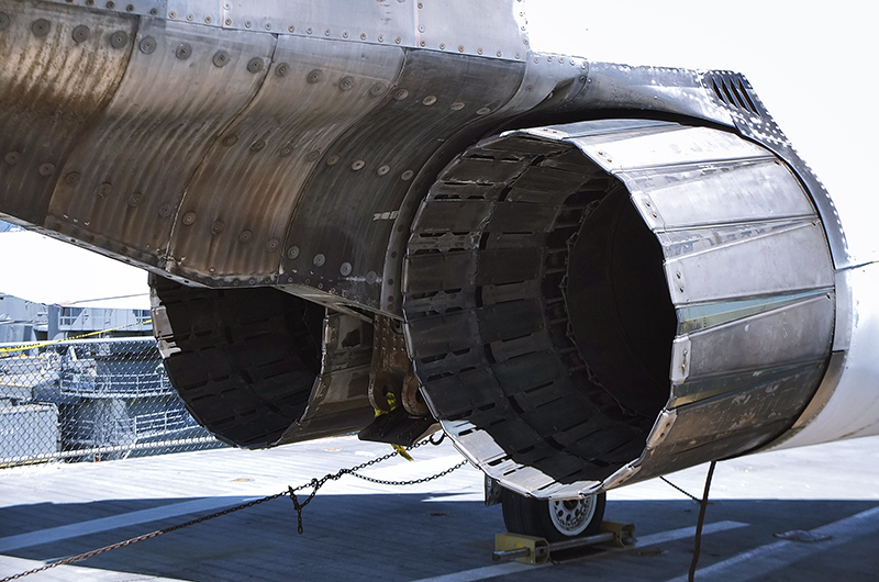

harv Posted May 13, 2019 Posted May 13, 2019 Never too much on a bird that smoked as much as a phantom ! Dirty birds. I think it looks great.....harv 2
Jeff Posted May 16, 2019 Posted May 16, 2019 On 5/13/2019 at 10:18 AM, harv said: Never too much on a bird that smoked as much as a phantom ! Dirty birds. I think it looks great.....harv weren't the notoriously dirty at the back end, I remember seeing the Thunderbirds Phantom that was the 'slot' bird and it's whole tail was black with soot..... 2
Jeff Posted May 16, 2019 Posted May 16, 2019 like this, and I think this is VERY cool, loved the 'Smoker"................... 2
