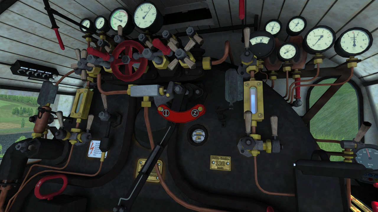

Any Train Simulator fans here? They have a BR 18 dlc where you can drive the actual locomotive!
