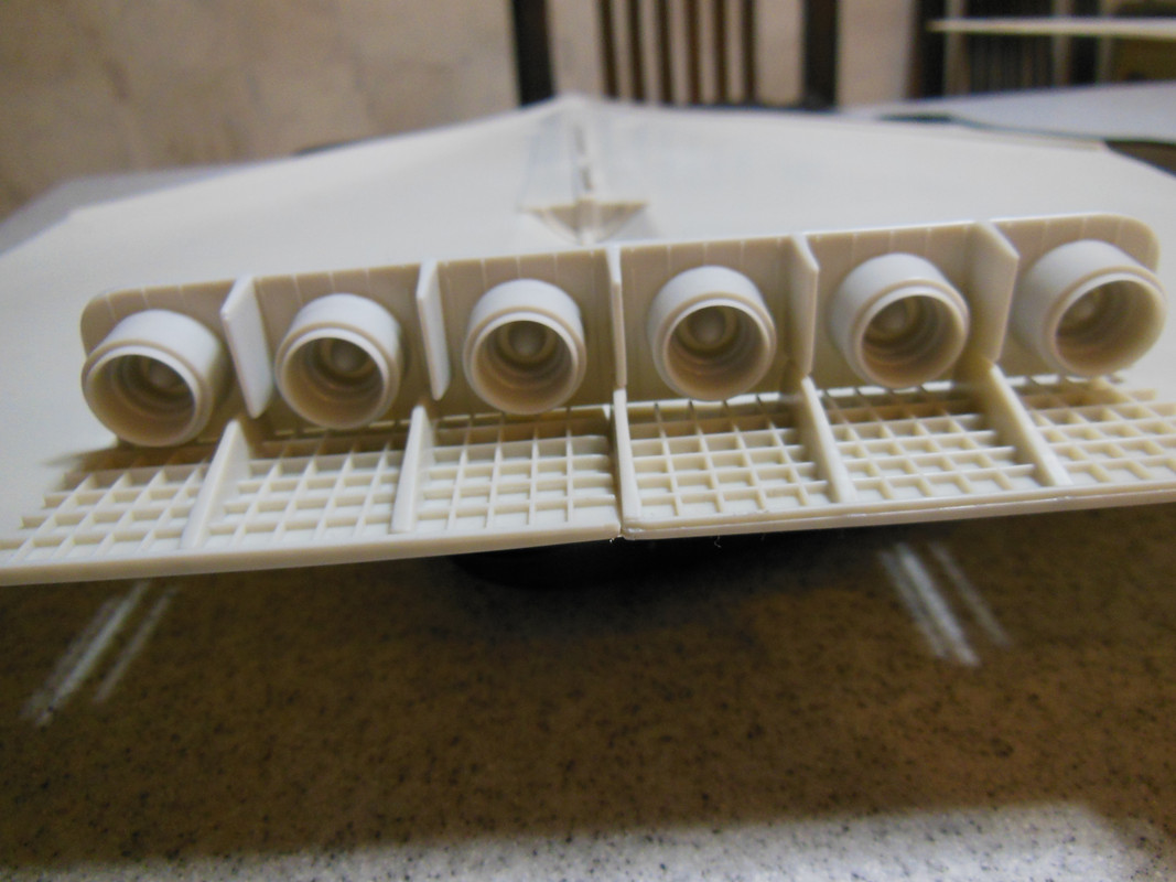

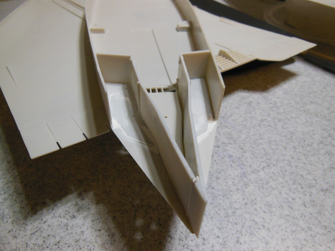

Bill_S Posted March 31, 2022 Posted March 31, 2022 I've always loved the lines of this plane. I never realized just how big it is until I saw the real one at the USAF Museum in Dayton, Ohio. The obligatory box pic... The parts count is not too high; the molding is a bit on the soft side when compared to kits of a more recent vintage. I hope to have this one enterred in my club's contest in September. I purchased a PE set from Brengun. Four frets, with some very fine parts. No cockpit enhancements were included in the frets. The PE is used on the exhaust area, landing gear, and various plates and scoops on the fuselage and wings. Assembly starts with the wings. Four parts, two upper and two lower. Upper: And lower: Exhaust nozzles fitted into the lower fuselage: Now the first problem arises. The fit is good between the nozzles and the lower fuselage, but when I fit them to the bottom wing I get this: The dividers between the individual nozzles are to be sandwiched between PE parts. Time to put on my thinking cap... Intakes with Tamiya putty... The next issue was an easy one. There was a noticeable step between fuselage parts on the starboard side. Nothing a couple of shims won't fix. I couldn't resist a mockup of the airframe. Even in 1/72 scale, this should be impressive; it's a hair under a meter long. 7 1

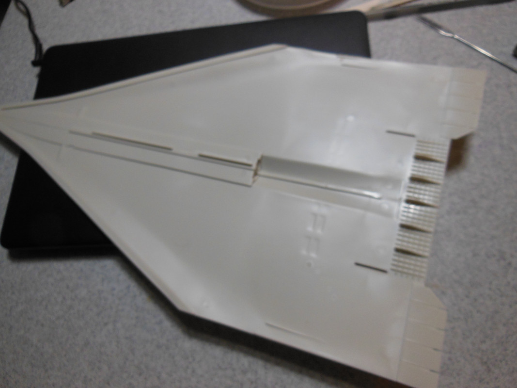

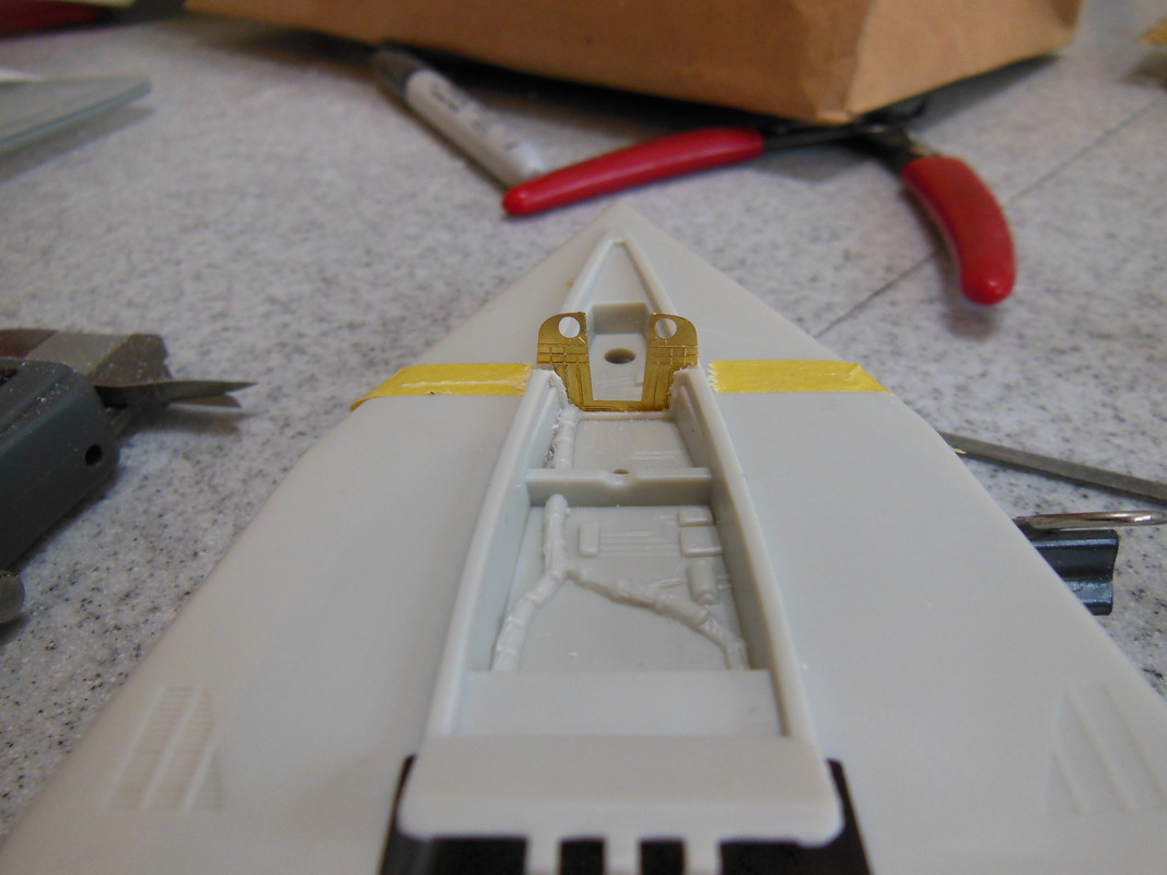

Bill_S Posted April 6, 2022 Author Posted April 6, 2022 A stiffener so I can hold the engines in the vise. Partitions milled off. Partitions removed from wing. Stock cut for new partitions. Lots of trimming to do. PE in place on the partitions. Not perfect, but it will do. Nose gear bay bulkhead in place. The damn thing sit way too high; no way the fairing will fit flush like this! I cut a slot in the roof of the gear bay to see if I could get it to sit low enough... It looks ugly, but not much of it will be seen. I had to trim the PE part anyway. I hope the rest of it fits better than this. And the fairing fits! 8 1

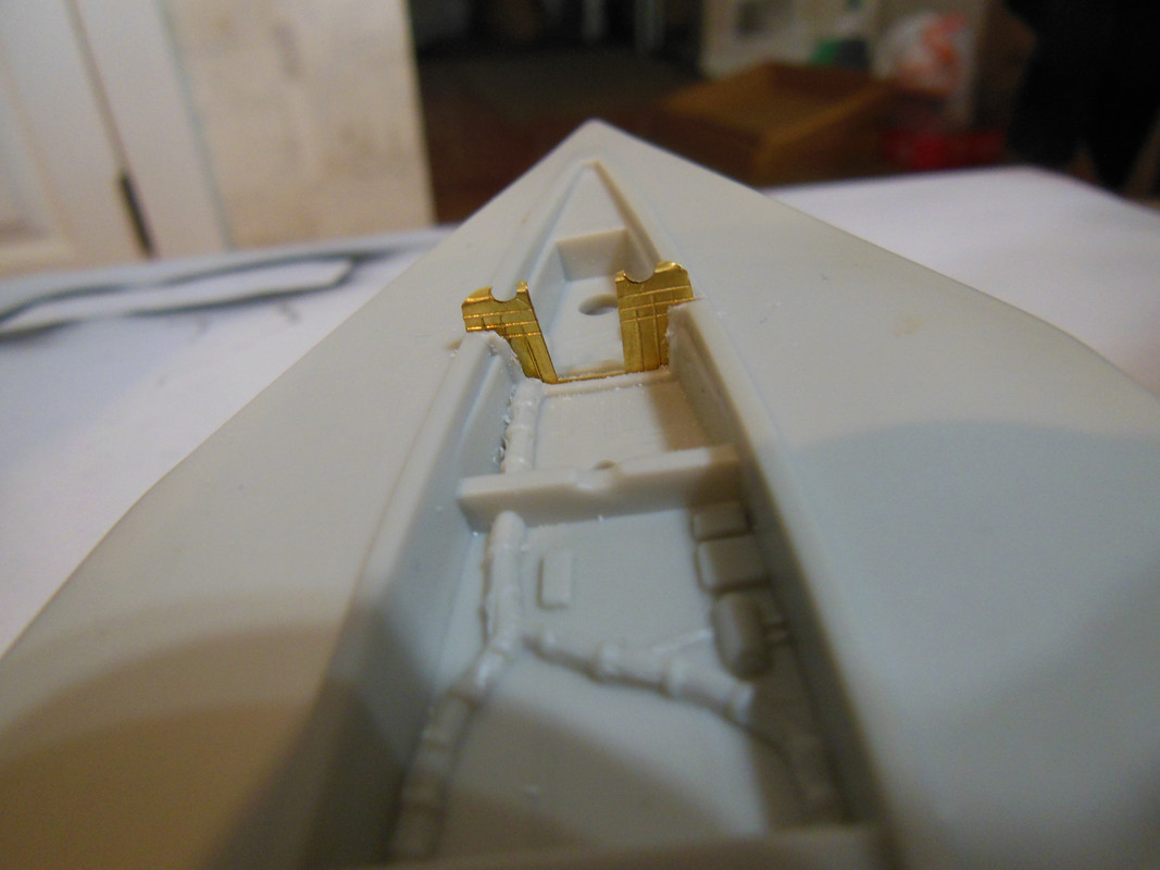

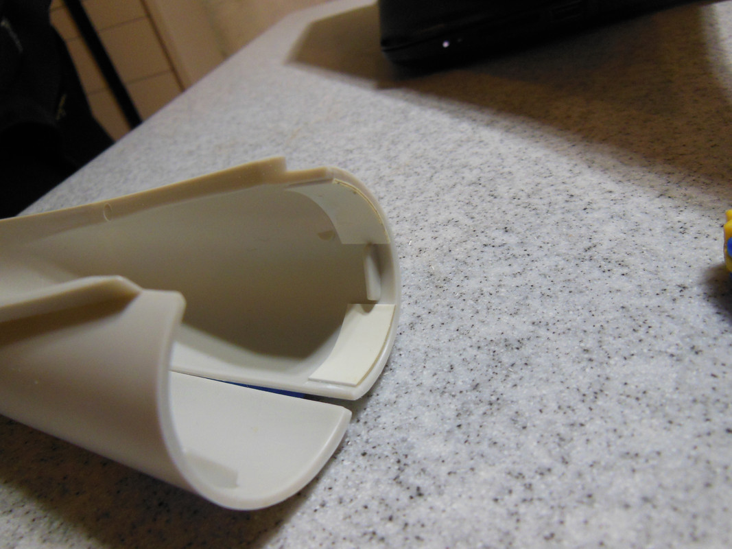

Bill_S Posted April 14, 2022 Author Posted April 14, 2022 This kit is a bit of a pig; I'm beginning to understand Nigel's rants on his youtube channel. I'm glad I didn't spend a lot of time on the cockpit. Not much will be seen, and I had to do some shaving to get the thing to fit into the forward fuselage halves. I had to clamp things very tight in order to close the fuselage. I still had a gap forward of the instrument panel. I'll fill that with styrene sheet. The spine of this section is a mess... I've begun the tedious process of rescribing, and I bought a new tube of Tamiya putty. 5 1

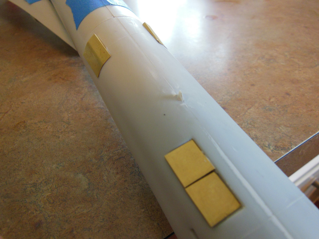

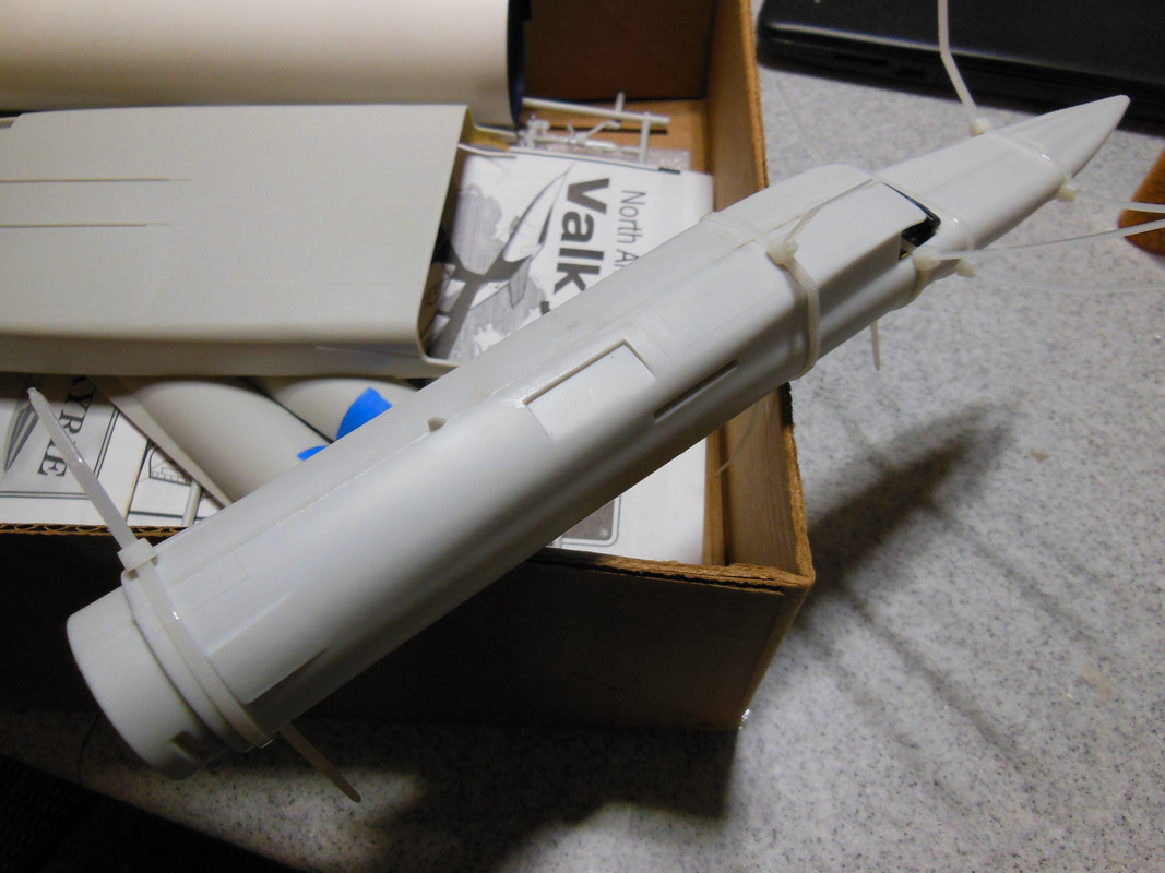

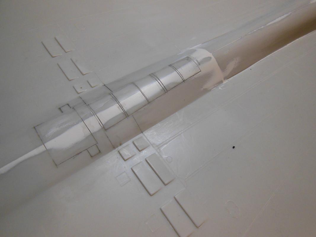

Bill_S Posted April 19, 2022 Author Posted April 19, 2022 Cut out a couple of molded on scoops on the fuselage; they'll be replaced with PE. Right now, they're held in place with PVA; lots of filling and sanding to be done before they are attached permanently. Given the size of the delta wing, I thought for sure this beast would be a tail sitter. I've got it propped up at the main gear attachment points; there is no need for any nose weight. 6 1

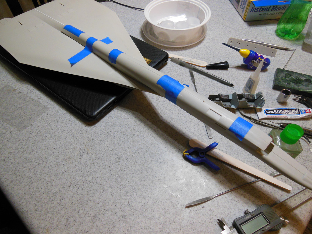

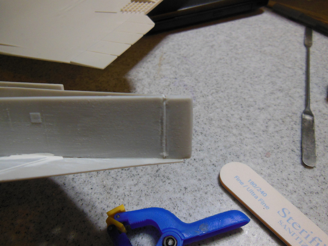

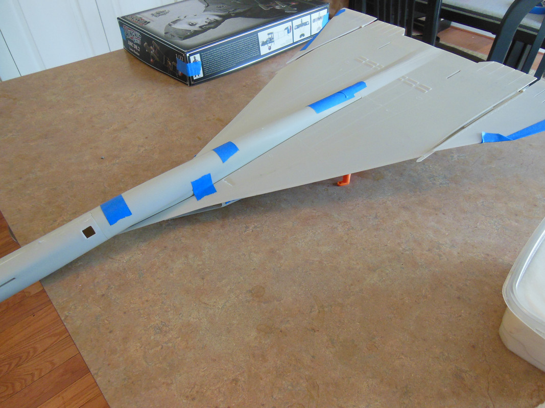

Bill_S Posted April 27, 2022 Author Posted April 27, 2022 There was a noticeable step between the upper fuselage and the clear canopy (two are provided; one subsonic and one supersonic). I cemented a piece of sheet styrene to bring the fuselage up to the level of the glass. More filler and more sanding are in order, but I'm pleased with the result thus far. I glued the fuselage to the upper wing. There is a noticeable gap at the join. I hate sanding those inside corners. I pulled out some 0.030 inch (.75 mm) diameter rod from the supply box. It fits quite nicely in the gap and (hopefully) will minimize filling and sanding. 5 1

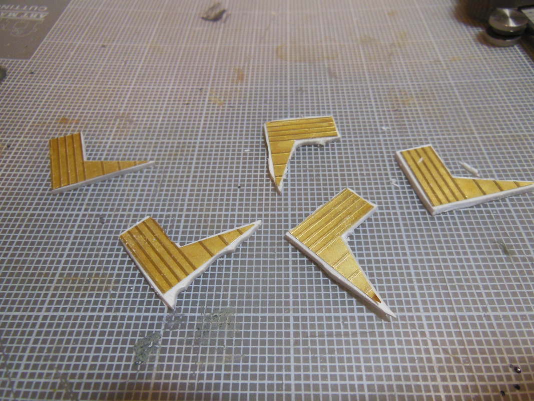

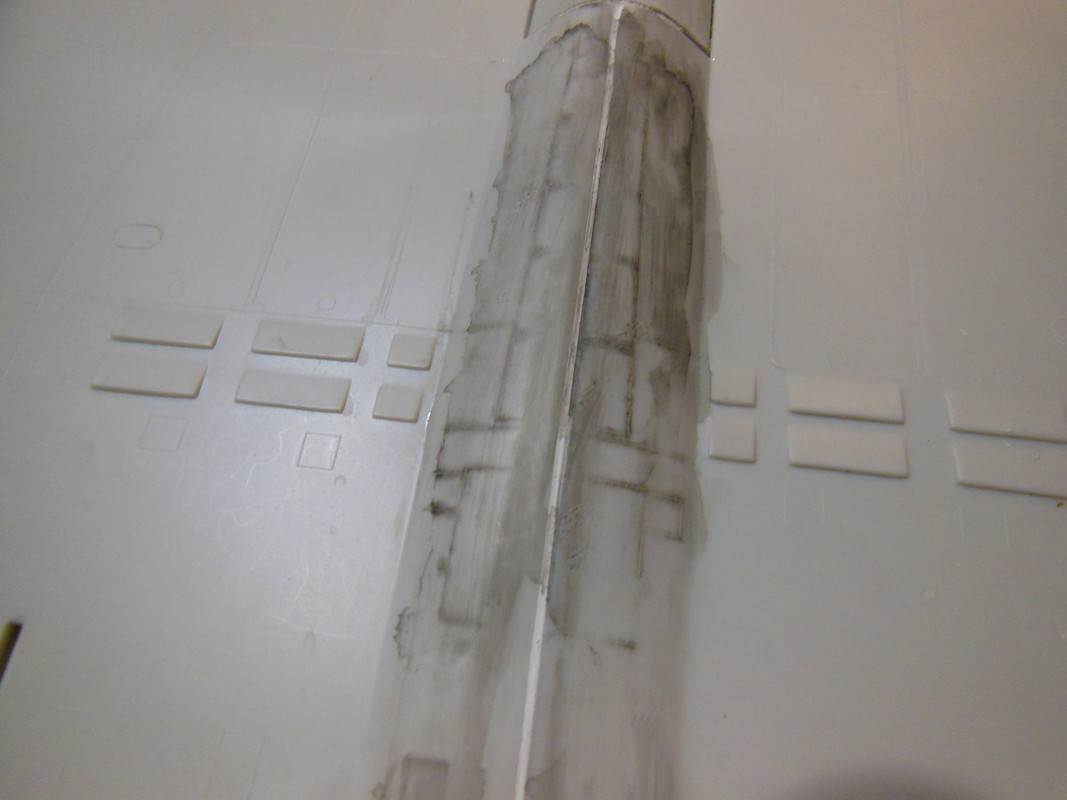

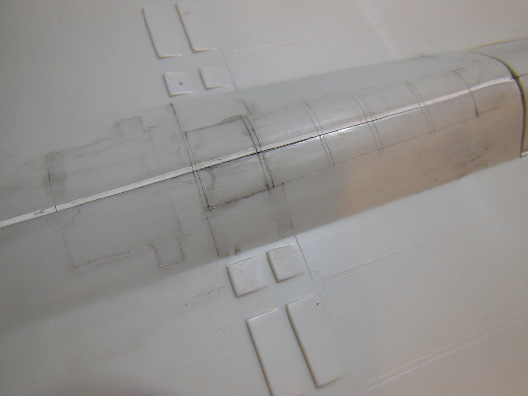

Bill_S Posted May 1, 2022 Author Posted May 1, 2022 Surface detail on the aft fuselage is faint and the white plastic makes it hard to see. I put some highly thinned Tamiya black down to highlight. I'll rescribe what's already there. A heavy layer of putty. Most of the putty is sanded off... It's going to require another application or three. In the meantime, I've started on the landing gear. Four PE parts for the mains, one for each nose wheel. 4 1

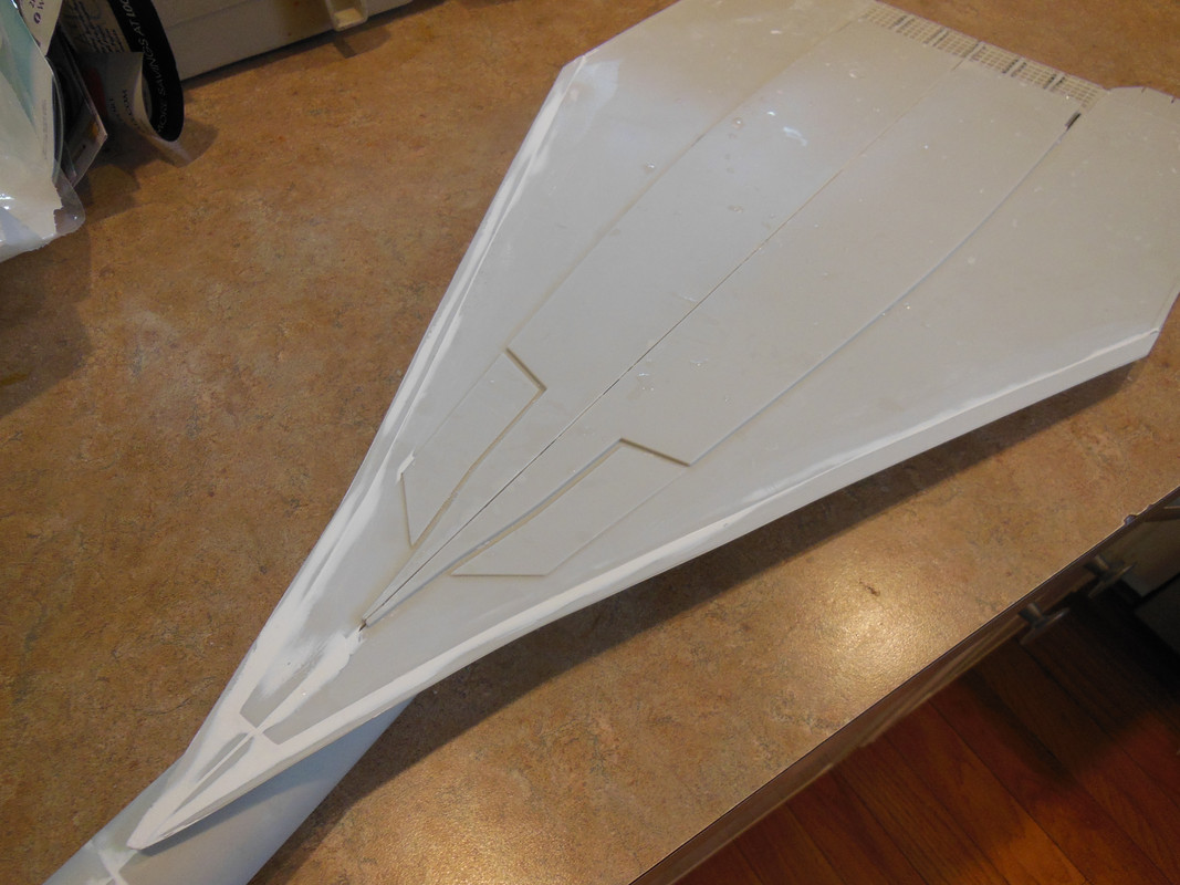

Bill_S Posted May 4, 2022 Author Posted May 4, 2022 Freshly scribed panel lines. Time to get out the putty and tackle those seams! 2

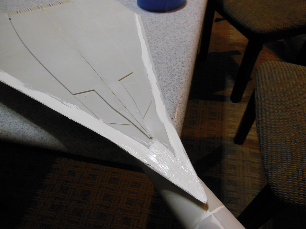

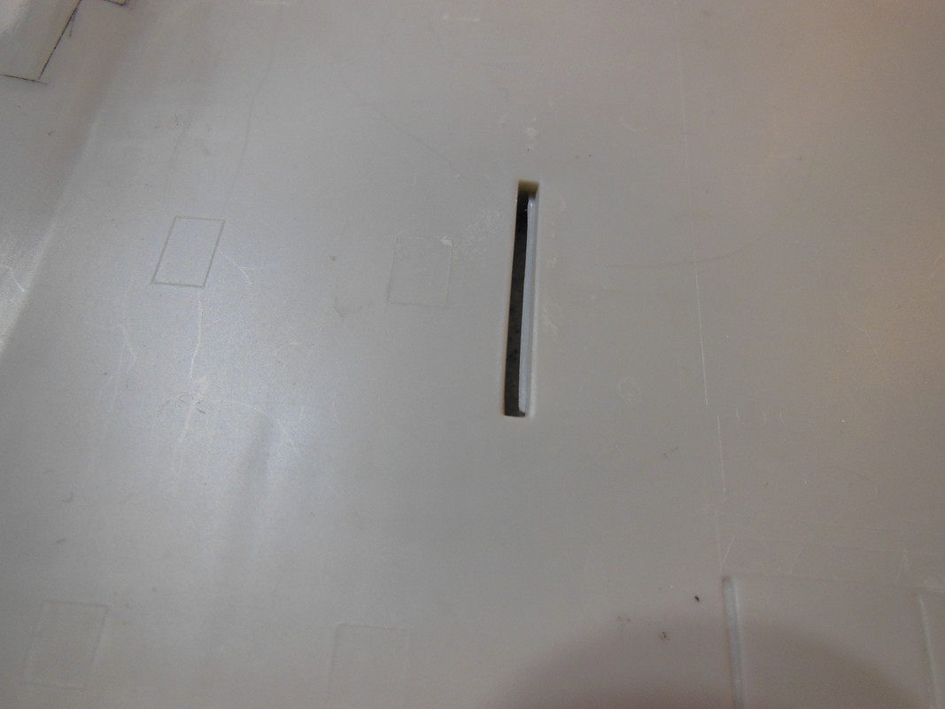

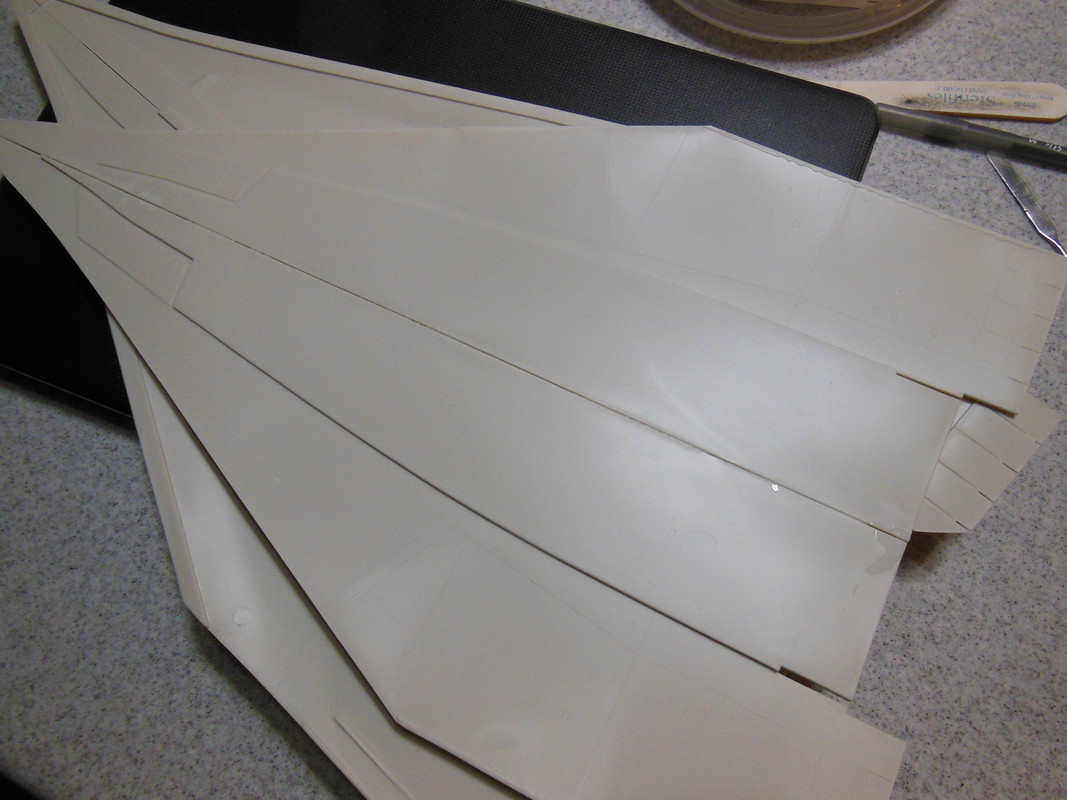

Bill_S Posted May 6, 2022 Author Posted May 6, 2022 Several applications of putty and lots of sanding... I still have lots of scribing to do, but it's all on flat surfaces, and should be relatively straightforward. Another obstacle to tackle... when I test fir the tabs on the tails into their slots, they don't fit. Looking down into one of the slots in the wing, I noticed this: Not a really big deal, but it's aggravating. I'll have to carve the tab on one of the tails to put a step into it. 3

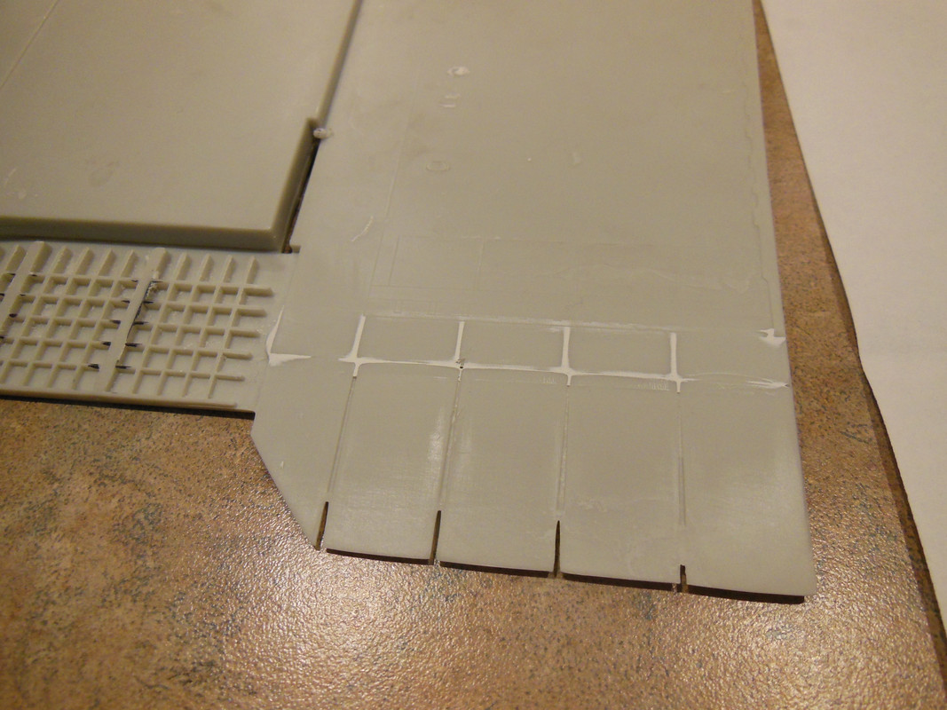

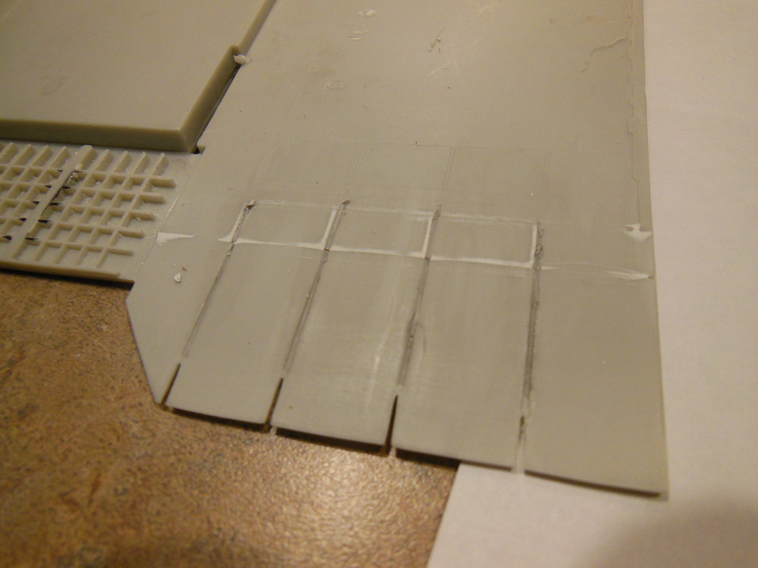

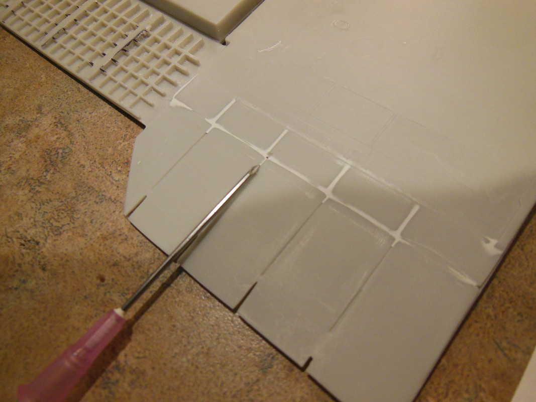

Bill_S Posted May 11, 2022 Author Posted May 11, 2022 Some noticeable misalignment between the upper and lower wing sections. I masked, filled and sanded to eliminate some of the grooves. In a moment of inspiration, I found a new 18 ga. hypodermic needle in the tool box. Sharp, beveled and the correct diameter... I laid the needle flat on the wing, applied pressure to keep it in the groove, and gave it a push. I've highlighted the end result with a wash. A little cleanup, and she's good to go. On to the next task. 5 1
