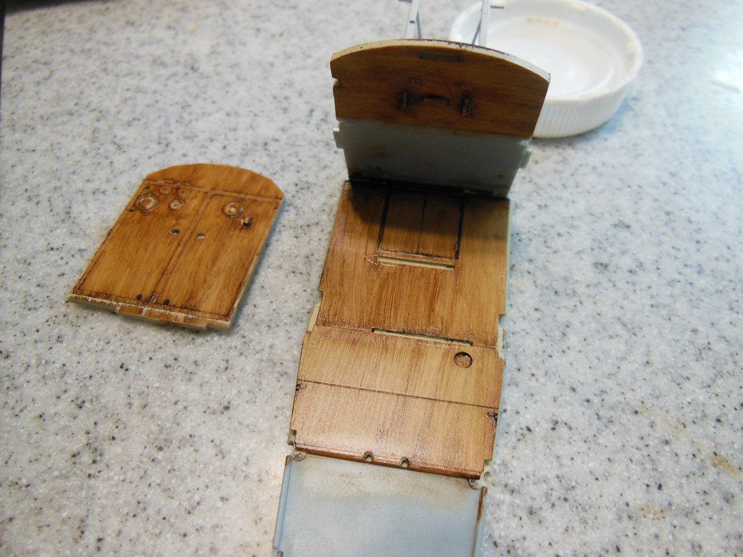

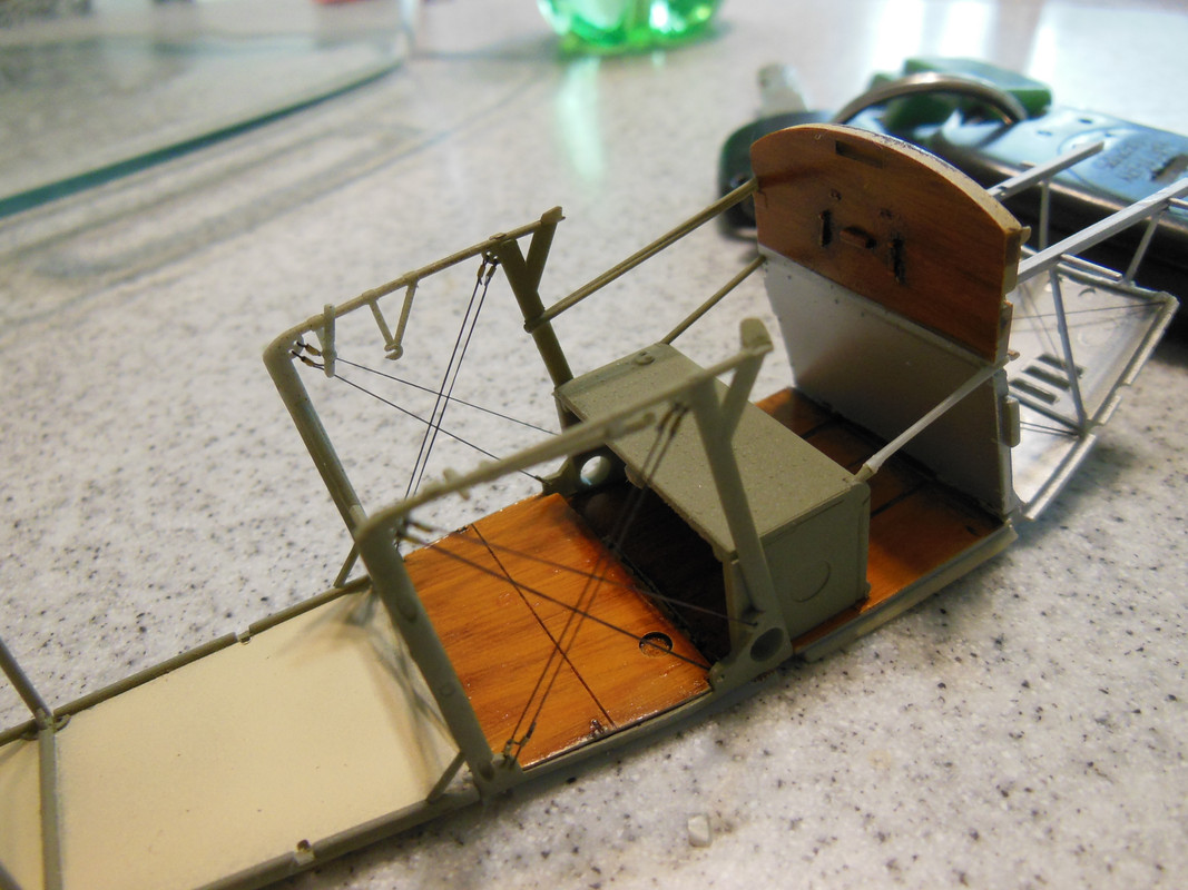

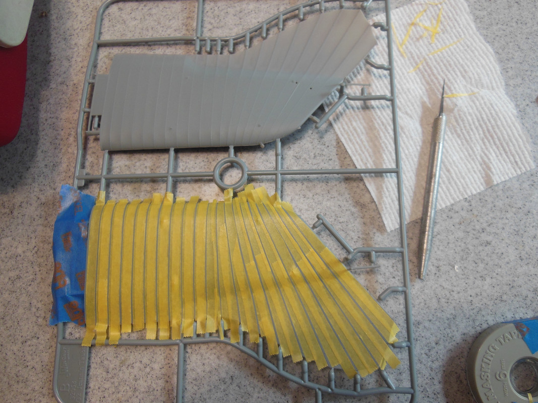

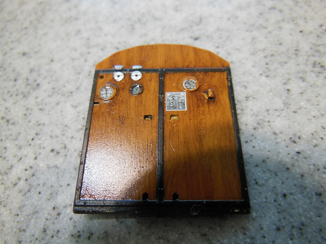

Another one that I started long ago. Thanks to Clunkmeister for getting me back on this one! Not sure yet which markings I will use...
Lots of Tamiya tape...

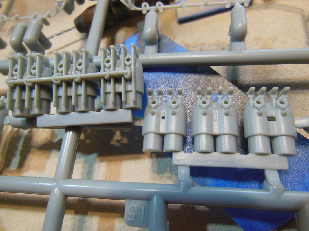

I'm not real happy with the molded-on detail of the engine...
I'm inclined to remove it all and rebuild... your thoughts?
Bill that’s a tough one, until you’ve built it and painted and weathered it you’re not going to know, could you strip it down then?...........research, find pictures ......it doesn’t look to bad moulding wise, quite sharp.......it is prominent though......
Hmmh, difficult to say, you chose the Argus engine and it dos look a little toy like on the sprue with the molded on rockers, .... To remove the plastic properly will not be so easy  in this case. Rebuilding the rockers out of Nickel Silver Tube a bit easier. The result would benefit from the extra work for sure. At least you got something resembling springs for the valves with the Argus.

I guess I should have looked not just at the instructions, but the sprues themselves. It turns out that WNW supplied cylinders on the Argus devoid of detail too!

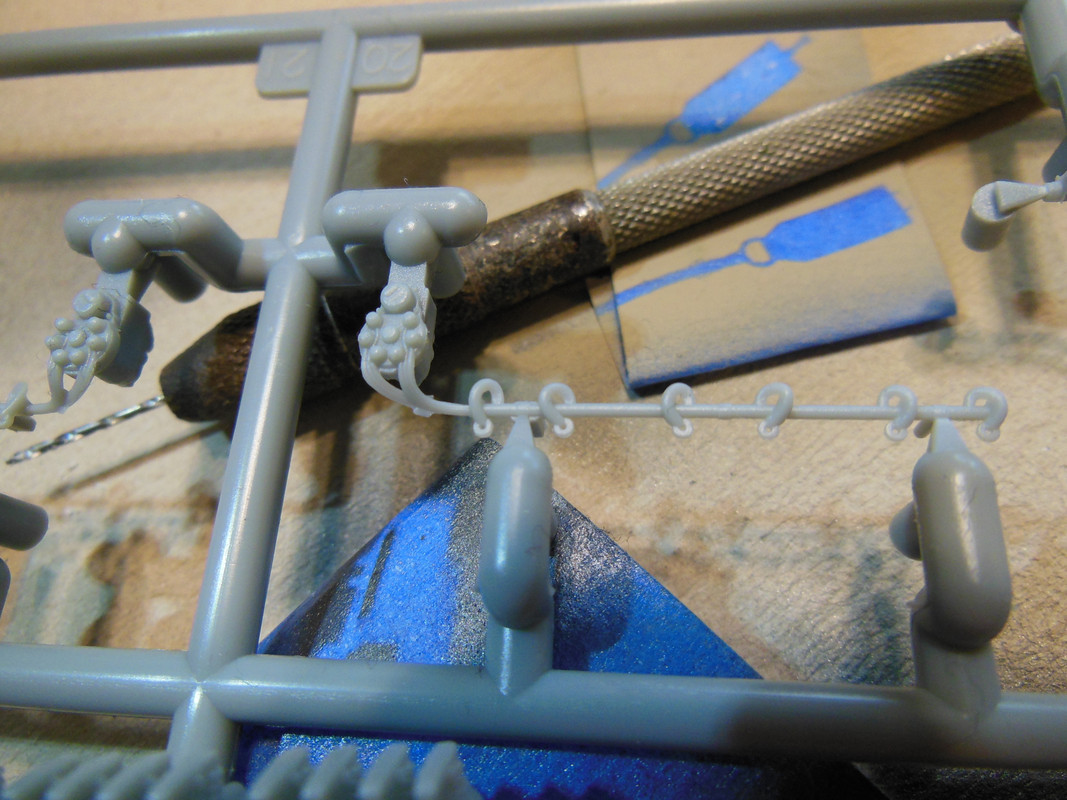

The magnetos also are molded with spark plug wire tubes. The instruction manual would have you cut off the tube...
All I really need to do is source some small diameter rod!

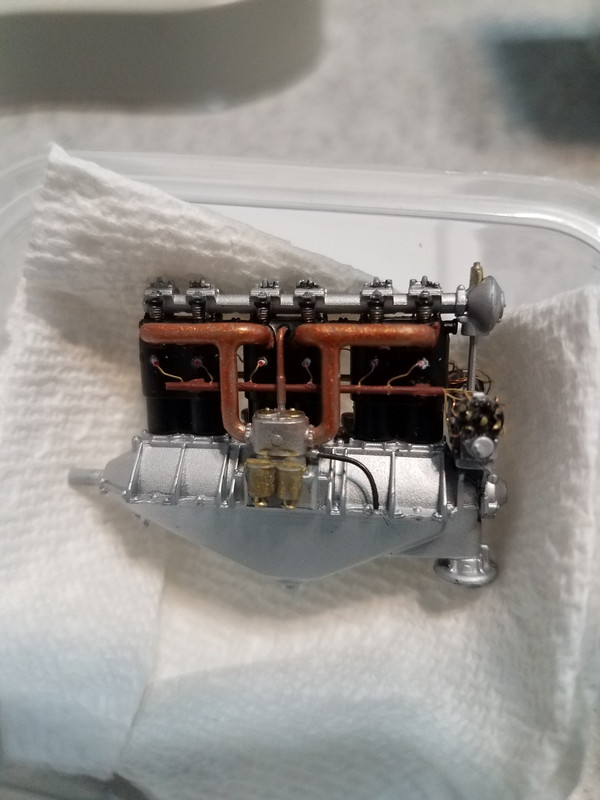

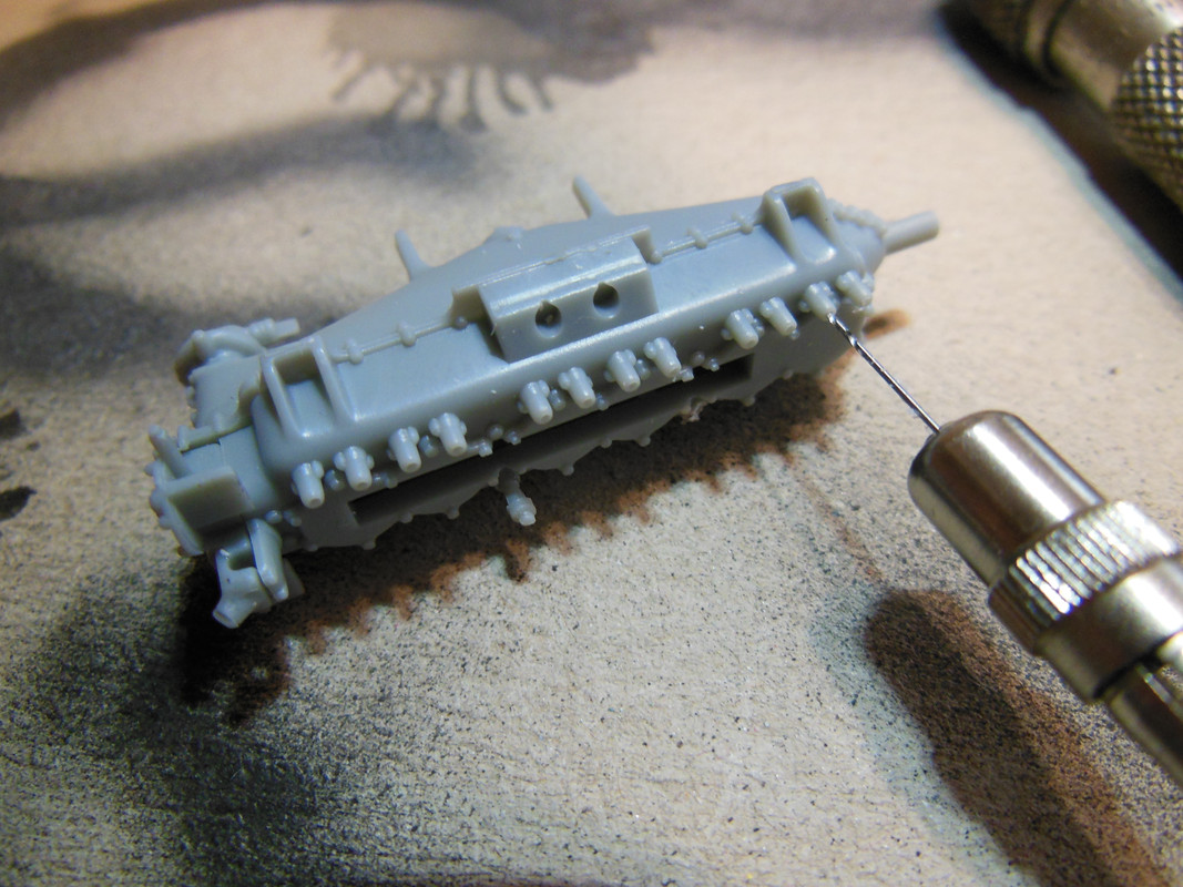

Some engine progress...
The Argus: I drilled holes for the pushrod sockets, and cut 0.020 diameter brass rod. Still some touchup to do on the rods, but I'm pleased with results thus far.

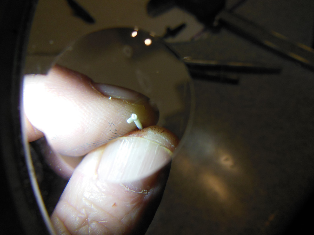

I'm disappointed; there is NO molded in spark plug detail as on the Argus engine - only locating holes. Unfortunately, Taurus has ceased production due to shipping difficulties associated with the pandemic. I managed to source some from the UK.
Tough to see in this photo, but I managed to drill a 0.020" (0.5 mm) hole in the ends of the spark plug wire conduits. Once painted, I'll stuff six wires into the ends.

It's been far too long since I updated. I've been fighting a massive headache since October,  and I'm finally over the hump. Without further ado...
Argus As.II
Daimler-Mercedes D.I
