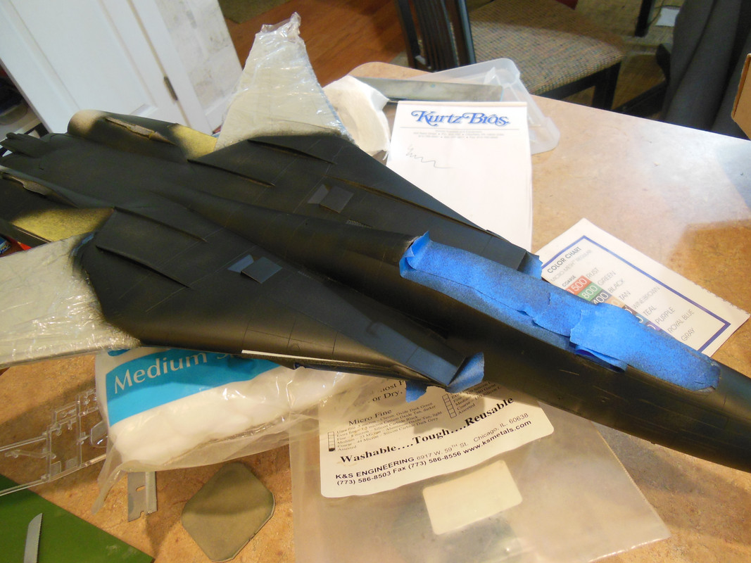

One of the last seams to be filled. I think.
I had one area that I should have sanded prior to installing the intakes. I had to fashion a sanding tool out of Evergreen strip.
There are a few small panel lines that I missed while scribing. Once I take care of those, I'll need to do some final surface prep and off to the spray booth.

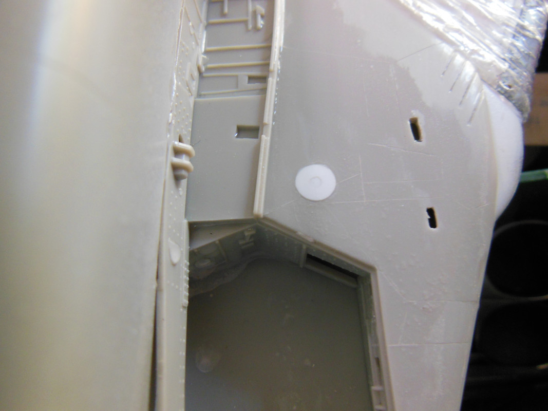

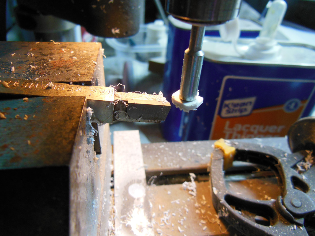

Those screw holes on the bottom of the fuselage bother me. I cut some sheet plastic, and chucked it into a dremel bit.
I don't have a lathe, so I use what I have.
Glued in place, with some 0.060' (1.5 mm) rod to fill the hole.
A little sanding, and I've got this.
Thankfully, I only had to do three of them - it was pretty time consuming.
