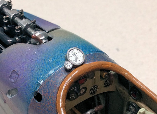

PanzerWomble Posted February 8, 2023 Posted February 8, 2023 Holy bananas thats some exquisite work Mike . I had to go check this is 1/32 not 1/8 or similar . 🙂 Those gauges , do you know what they were - engine revs maybe ? 3

sandbagger Posted February 9, 2023 Author Posted February 9, 2023 13 hours ago, PanzerWomble said: Holy bananas thats some exquisite work Mike . I had to go check this is 1/32 not 1/8 or similar . 🙂 Those gauges , do you know what they were - engine revs maybe ? The gauges are a Tachometer (engine revs) and the smaller, a Manometer (pressure), Mike 3
