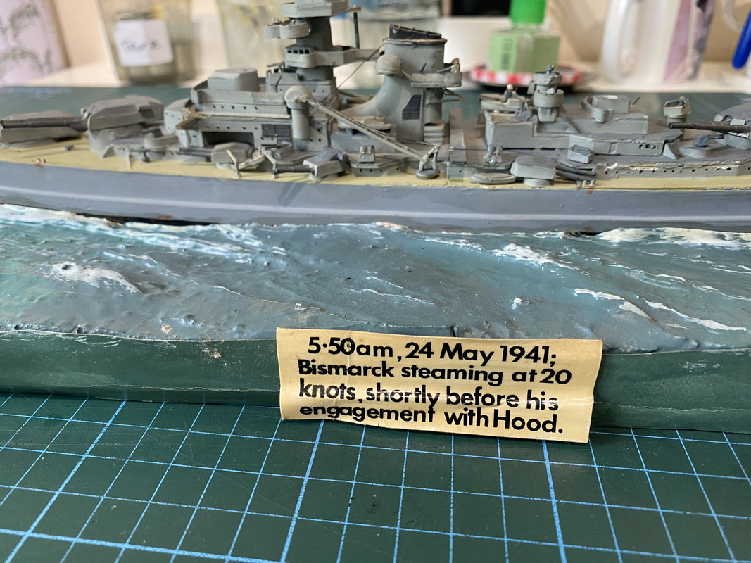

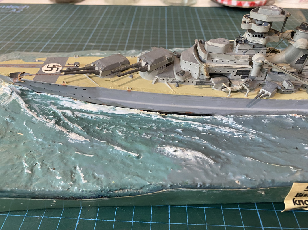

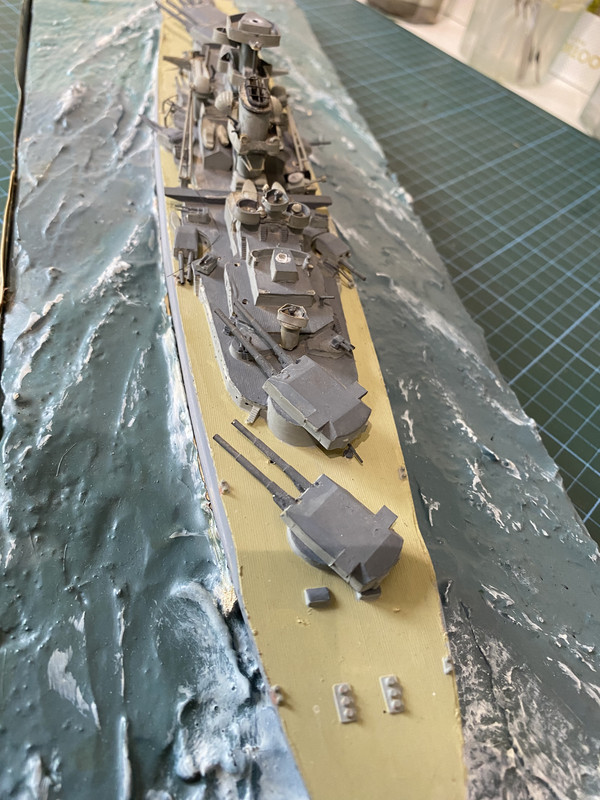

PanzerWomble Posted March 18 Share Posted March 18 Okey dokey ....this is a step in an odd direction for me. I make tanks ....and occasionally aircraft ......not ships . Last proper ship I made was Airfix's Bismark ...in 1981 ...after reading Mullingheim-Rechberg's book . it's battered remains as found in the attic whilst clearing out the family home last year . Even a name plate made with Letraset ...I thought this was top of my art aged 13 ( althought still think Scharnhorst is a prettier ship ) 7 Link to comment Share on other sites More sharing options...

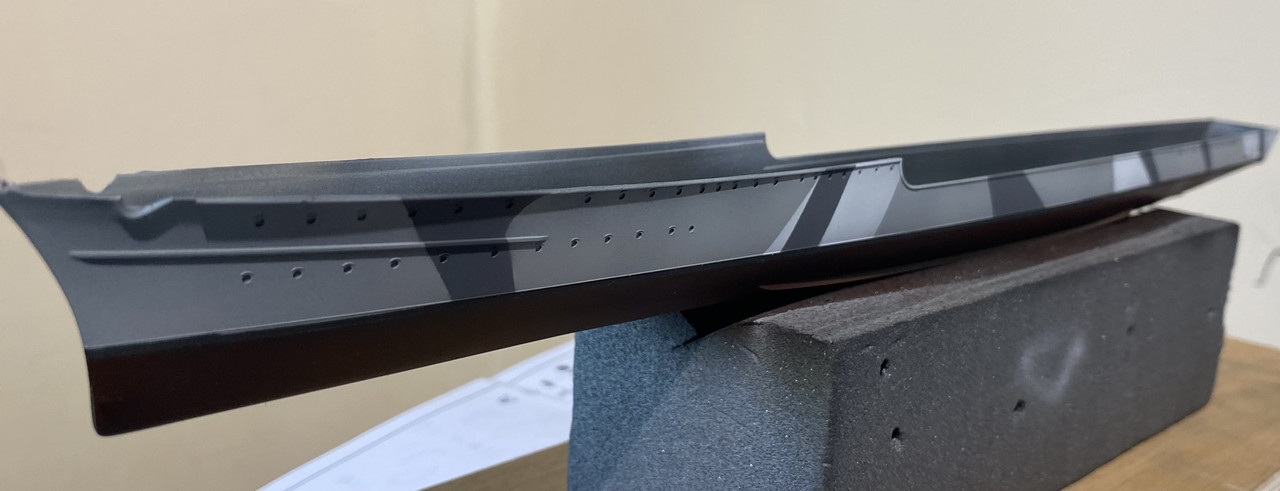

DocRob Posted March 18 Share Posted March 18 7 minutes ago, PanzerWomble said: Oh yeah ...has anyone the faintest clue as to where I start ? 🤣 Sure, get some Ion Model crew figures and then some brass for the barrels. Then it's up to you, to find the perfect part for a starter among the 470. I'd go for the stand and hull, drilling out the portholes. Cheers Rob 6 Link to comment Share on other sites More sharing options...
PanzerWomble Posted March 18 Author Share Posted March 18 10 minutes ago, DocRob said: Sure, get some Ion Model crew figures and then some brass for the barrels. Then it's up to you, to find the perfect part for a starter among the 470. I'd go for the stand and hull, drilling out the portholes. Cheers Rob Thanks Rob -a good call as there a no folk onboard , though will 90% go with seascape though as reasonable ok with making them . North Sea storm or calm Fjord ....? If I drill out the portholes what next ? Leave them as holes or back them on the inside with something black ? Made a base & hot melted it together should allow me to work on it without moving it around 7 Link to comment Share on other sites More sharing options...
DocRob Posted March 18 Share Posted March 18 33 minutes ago, PanzerWomble said: If I drill out the portholes what next ? Leave them as holes or back them on the inside with something black ? On my USS Arizona build of the same scale, I only drilled out the portholes. As the hull is closed and dark inside this was sufficient for me, You'll need your mentioned 20x magnifier and strong lighting to see more than a black hole. Cheers Rob 8 Link to comment Share on other sites More sharing options...
Landlubber Mike Posted March 18 Share Posted March 18 Agree with Rob - at a minimum, go for upgraded brass barrels. If your kit doesn't come with PE railings, I'd get some of those as well. If it were me, I'd probably also look into adding pre-cut wooden decks and maybe some additional PE aftermarket like I used in my Shimakaze build (linked in my signature) or you see on Rob's current build. PE (and now resin) aftermarket sets make a huge difference (and is almost a must for 1/700 in my opinion), but it all depends on what you want to get out of your build. The PE set for my Shimakaze build added at least double, and probably triple, the build time when you factor in adding all the details to guns, torpedo launchers, deck items, platforms, the bridge, etc. You can get comprehensive sets that have almost all of the upgraded detail you need, or you can add aftermarket a la carte as you need it. But, ship PE takes a certain level of discipline/masochism 5 Link to comment Share on other sites More sharing options...

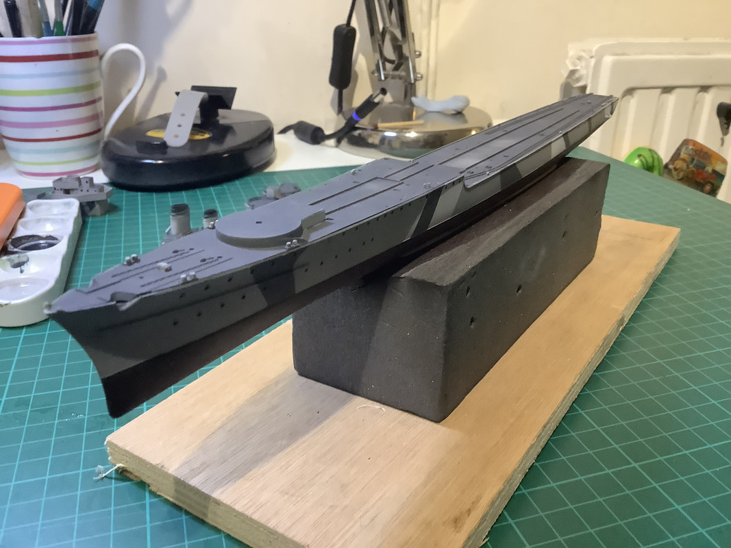

PanzerWomble Posted March 18 Author Share Posted March 18 Thanks for the useful thoughts . Pe railings are in the kit so a given, as is the radar . Doing a lot of PE replacement is not a thing that interests me with this build though , small steps , your Arizona build is not where I'm at today Being build number 1 in 1/350 , this is test to see if I can produce something I'm happy with .... it might still end up being a lawn dart. I'll build on skills with subsequent build it it floats my boat. ..see what I did there ? So mask.... paint... mask ....paint .....mask ...pain ...doesn't use up much paint though . 5 5 Link to comment Share on other sites More sharing options...

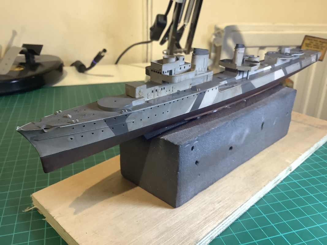

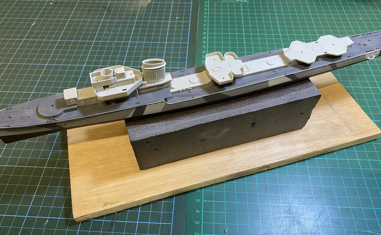

PanzerWomble Posted March 18 Author Share Posted March 18 End for tonight then . All the superstructure is loose fitted. Reckon build it up into decent sized subassemblies , paint them , add the details then fit to the hull . And then the railings???? ? oh and try to paint modulate as you go along . Argggghhhhh all so much more fiddly than tanks .🤯esp after a bottle of wine . 7 2 Link to comment Share on other sites More sharing options...
KevinM Posted March 19 Share Posted March 19 2 hours ago, PanzerWomble said: End for tonight then . All the superstructure is loose fitted. Reckon build it up into decent sized subassemblies , paint them , add the details then fit to the hull . And then the railings? Pretty much PW I paint the railings before install and the last thing I do before hitting the deck no breakie same thing on the deck rails can always touch-up afterwards.Rob has his attached before hand me I can have fat fingers or drop the POS. 5 Link to comment Share on other sites More sharing options...

GazzaS Posted March 19 Share Posted March 19 3 hours ago, PanzerWomble said: End for tonight then . All the superstructure is loose fitted. Reckon build it up into decent sized subassemblies , paint them , add the details then fit to the hull . And then the railings???? ? oh and try to paint modulate as you go along . Argggghhhhh all so much more fiddly than tanks .🤯esp after a bottle of wine . haha... you shouldn't drink during ship building. Looks good, though. 3 Link to comment Share on other sites More sharing options...

PanzerWomble Posted March 20 Author Share Posted March 20 Anyway , I am not enjoying this build that much🥺 ....most of how I approach things doesn't want to play . It's all to damned small and fiddly , like 1/72 nonsense . So here were are , built up numerous bits of superstructure . Painted them ..oh ..3 or 4 times . Painting square portholes ...who knew ? Glued it all to the hull , and then a couple of washes because nothing I make needs to be clean or pristine . So paint all the small bits , glue them on, enjoy the PE railings and we're done yeah ??? Hmmm let's see. I'm with Neitsche today .. 5 Link to comment Share on other sites More sharing options...
GazzaS Posted March 20 Share Posted March 20 Guy, she looks great so far. I find most PE just has to be endured with the final result in mind. I have also started cheating, using tacky canopy glue whenever I can to get the part in place. Then I reinforce it with a bit of CA. re: the railings…. At the model warship forum they recommend attaching them with CA and then running a bead of thinned PVA along the bottom to prevent them from detaching when there are temperature changes. 2 Link to comment Share on other sites More sharing options...
