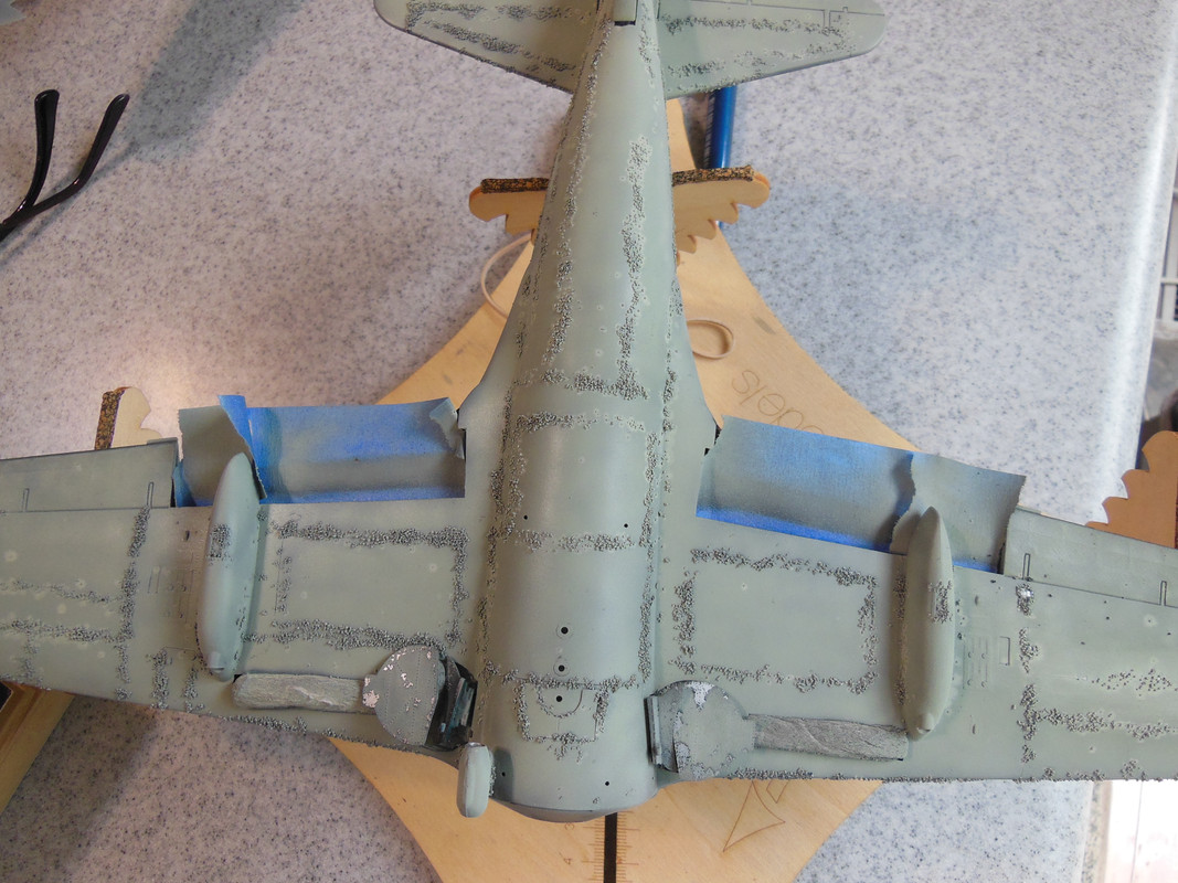

nmayhew Posted August 2, 2023 Posted August 2, 2023 Trumpeter’s 109 G-2 (1/32 of course)… a reminder of just how good Tamiya (and Kotare now) are; definitely in the ‘looks like a…to me’ category but hey ho. just starting oils topside; bottom is mostly complete apart from spatter marks. 8 3

GazzaS Posted August 2, 2023 Posted August 2, 2023 3 hours ago, nmayhew said: Trumpeter’s 109 G-2 (1/32 of course)… a reminder of just how good Tamiya (and Kotare now) are; definitely in the ‘looks like a…to me’ category but hey ho. just starting oils topside; bottom is mostly complete apart from spatter marks. That looks really great. How do you keep your colors from either looking like they were applied by brush, or disappearing? 5

nmayhew Posted August 6, 2023 Posted August 6, 2023 Hey guys thanks for the kind words I think I have done some how to’s on here in WIP for my P-40 (search ‘Neville Duke’ and I’m sure it will come up) but very quickly … firstly and most importantly there’s no voodoo - you just need to be willing to give stuff a go, and not let yourself be convinced “I prefer my models with that clean look” when really it’s because you are a bit scared - I know because I was that person for years lol primed with MFS1500 Black; all paints are MRP; I use spatter templates where surfaces are flat enough and if fiddly compound curves will airbrush lots of little mottle randomly in various colours to build up depth; check Doogs Models YouTube for Blackbasing technique if you are not familiar oils should go on full or semi matt; if on gloss you’ll just be pushing them round and it will be a mess i don’t use oil dot technique; afaik that’s just random dots of random colour; I try to think about what weathering will occur and where. I don’t use pin wash - certainly not as slather it all over in every panel line etc and wipe off excess approach; that’s a bit clumsy and just makes things look even more like a model in my view; some do like the look, but it’s not for me. Check out Mike Rinaldi on YouTube - his short technique vids, not the 3hr live streams - too much waffle on those - he is THE MASTER and originator of OPR afaik for armour, check John Spud Murphy on Facebook - lots of great guys but he has lots of simple mini bits of how to and technique anyway… oils are on cardboard but I do dive straight in; I have Sansodor in a small palette by side; you can get away with just a few brushes - a couple of smallish ones (but can be a 2), just with a nice point, and maybe a bigger filbert type oils on cardboard are kept in a tin - fridge them ideally - and they will keep for a week plus; dab some Sansodor on them to revive if they start to get too dry work light to dark colours tiny amount of thinner and dab into oil paint (here I differ from MR - follow him not me, but since people asked…), take most of paint off on paper towel; apply to model; then with clean brush with a tiny TINY amount of thinner, work the oil to where you want and blend; then with bigger fry brush continue the blend; then if you want multiple colours over same area, USE HAIR DRIER - just cheap sh*t travel one - quick blow and then good to go again for a more industrial strength protection I spray MRP clear which dries in seconds and then can go at same area with any aggression necessary for spatter I will use Mac valve and maybe brush flick - have yet to get round to that hope this is of use; happy Sunday 4 2
nmayhew Posted August 6, 2023 Posted August 6, 2023 PS if you f8ck any bit up, just wipe with Sansodor and start again; MRP paints are impervious to it; 2
