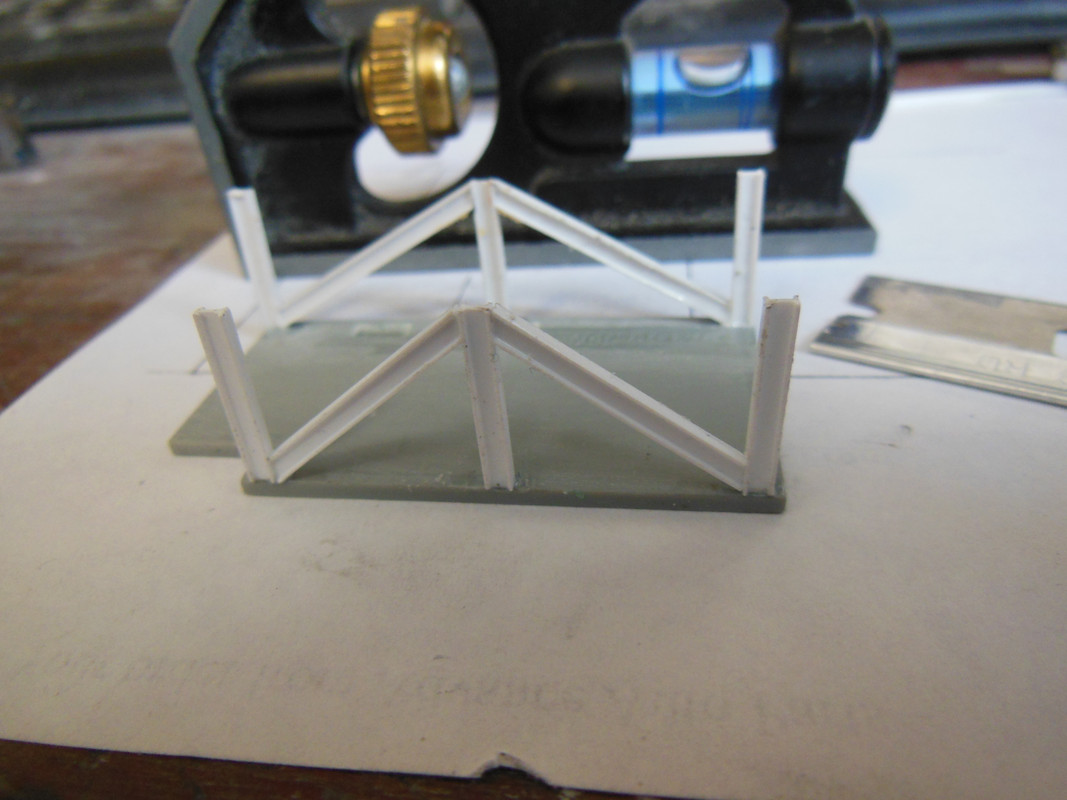

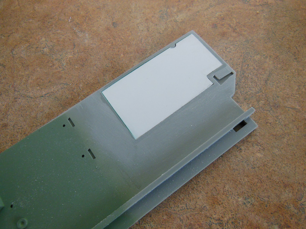

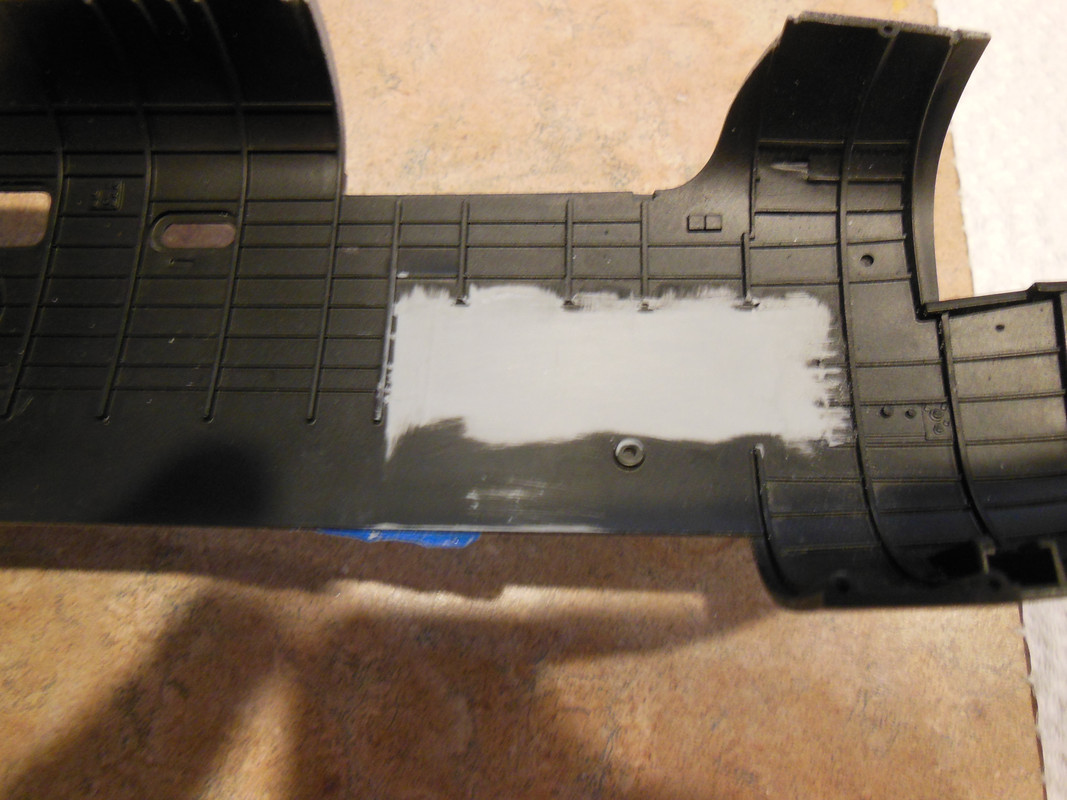

FME erk Posted March 12, 2019 Posted March 12, 2019 Neat surgery on both locations there Bill . . . . 5

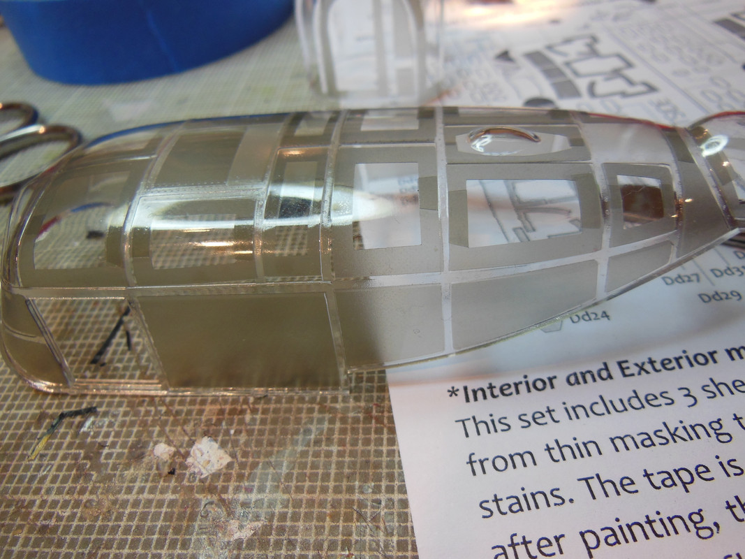

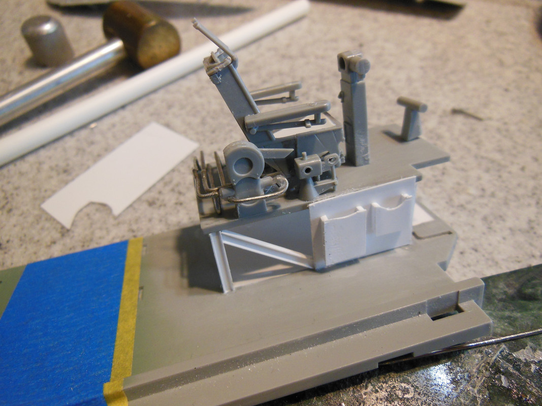

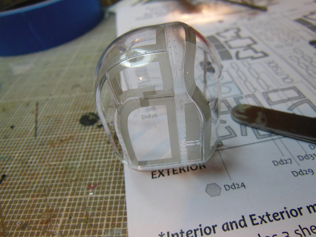

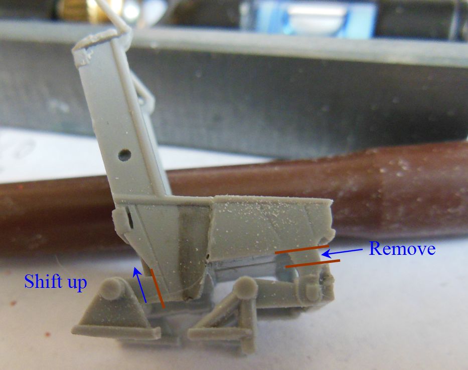

Bill_S Posted March 15, 2019 Author Posted March 15, 2019 Some minor progress - seat modifications. Rather than chop up kit pieces, I opted to cut the seat as a whole. Not sure yet if I'm gong to lower the seat further, but if I need to, here is my plan. My canopy masks finally arrived from Bulgaria. Worth every penny! Just the insides right now. Some minor trimming is required in just a couple of places. 6

Wingco57 Posted March 22, 2019 Posted March 22, 2019 Just to be sure, the horizontal frame at the rear of the canopy is on the inside, the outside is smooth and the raised lines should be scraped away. The only thing you see from the outside are the boltheads. We have mentioned this several times to Neil but to no avail. Cees 6

BlrwestSiR Posted April 4, 2019 Posted April 4, 2019 Wow, those cockpit mods look great. Bill, what size C channel did you use for the pilot floor struts? Carl 3
Bill_S Posted April 4, 2019 Author Posted April 4, 2019 5 hours ago, FME erk said: How you getting on Bill ? I too have been watching Nige vids and the amount of mods on this new kit to correct is unbelievable. I look forward to seeing how the seat sits on the renewed pilots floor . . . . I took some time off, FME - I got to spend a week in sunny Florida! Back at it now... 3 hours ago, BlrwestSiR said: Wow, those cockpit mods look great. Bill, what size C channel did you use for the pilot floor struts? Carl Thanks Carl, It's I beam, Evergreen #272 (0.08 x 0.051) 2.0mm x 1.3mm for you metric folks. 3

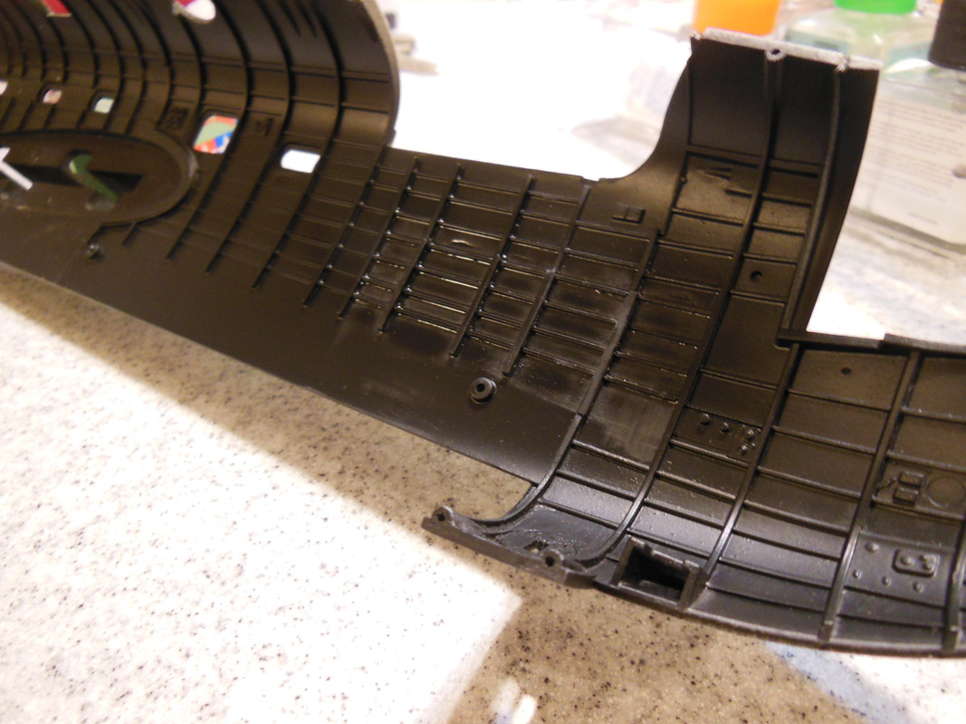

Bill_S Posted April 8, 2019 Author Posted April 8, 2019 I decided to leave the seat at its original height; my eyes are bad enough that I won't notice the difference. It's high time I got some paint on this thing! 8
FME erk Posted April 8, 2019 Posted April 8, 2019 Nothing wrong with the seat Bill. I must say I do like the 'plumbing' around the seat, would that be lead wire ?? 5
Administrators Clunkmeister Posted April 8, 2019 Administrators Posted April 8, 2019 Bill, that looks great! 4 1

Bill_S Posted April 9, 2019 Author Posted April 9, 2019 14 hours ago, FME erk said: Nothing wrong with the seat Bill. I must say I do like the 'plumbing' around the seat, would that be lead wire ?? I tried using plastic rod, but I'm not good enough. Then I tried brass rod, but had difficulty getting a small enough bend radius. I settled for solder. 4
