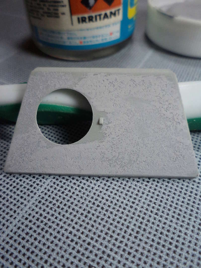

1) The application!
For example, I took the back of the turret panther g demonstration!
For the application: make successive passes, but light so as not to "wrap" and thus have extra thickness on your support!

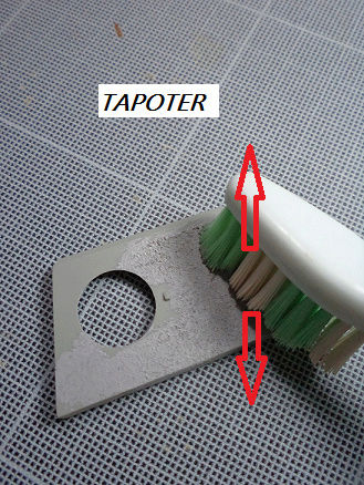

2) Then take the toothbrush and tap it until you see any flaws that form and as soon as it is good to stop!
You must have this !!

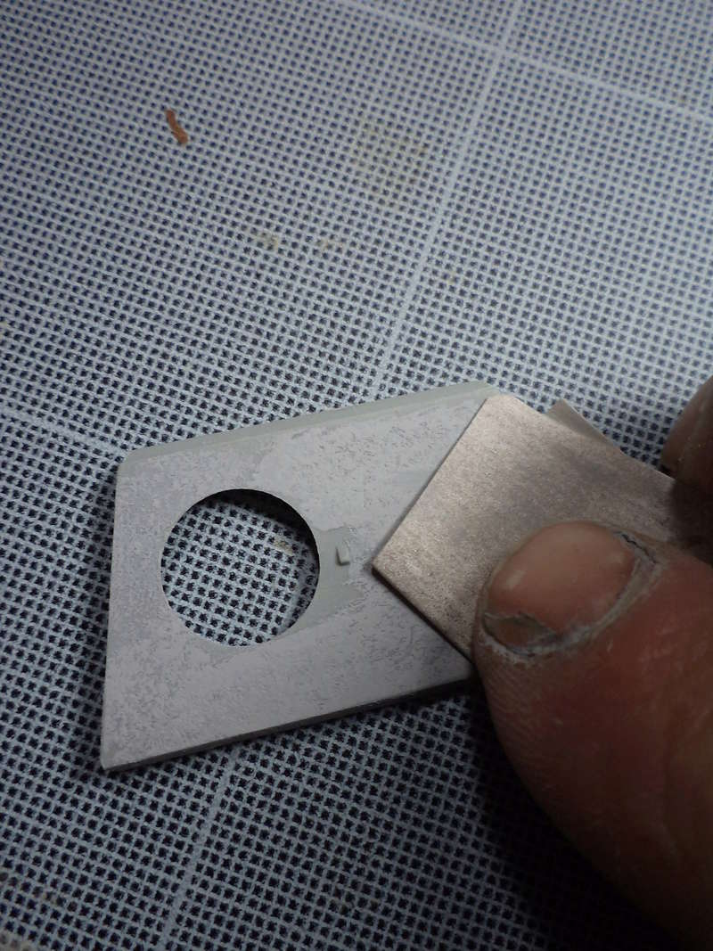

3) With 400 sandpaper, always sand with a rotating motion !!
You must get this!
4) For the continuation we will pass of Mr. Surfacer 500 by here, by there, to reinforce the aspect (but always with a light layer) and to tap immediately with the toothbrush the surfaced zones !!
Iron the toothbrush and before the product has dried (5 min) !!
Pass the sandpaper 400 with and always rotate, and sand until the result is smooth to the touch, and uniform  !!!
That's the end result after my explanations;) !!
