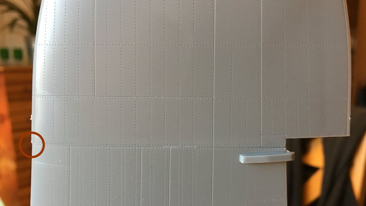

yknu Posted January 24, 2019 Posted January 24, 2019 On 1/23/2019 at 6:14 PM, NigelR32 said: I'll check mine later.. not looking good is it or is it the angle of the shot? Are you sure you've got the stb tip on stbd wing? I'm sure you have.. Expand Here are updated pics. ( k17 and g9) there will be some work to be done with the fit of the wigtip. 4

NigelR32 Posted January 24, 2019 Author Posted January 24, 2019 On 1/24/2019 at 8:23 AM, yknu said: Here are updated pics. ( k17 and g9) there will be some work to be done with the fit of the wigtip. Expand Hey yknu.. I have done the same as you, but using the starboard parts as my port wing is faulty and is being replaced. In these first two pics, we can see that the fit is not so bad as yours.. That is because i shoved a soft sanding stick inside the wing To improve the fit on the top side, I laid two strips of tamiya tape on the flange... Obviously when actually assembling you would use plastic card... Then I refitted the tip to see if it was better.. it sure was. On the underside, I think some plastic will need to be removed from the flange on the wing to allow the tip to sit flush with the surface of the wing. Personally, I would have preferred the wings to be as standard with a one piece upper and one piece lower rather than this supposedly "clever" design. Fitting the tip seamlessly will obviously take some skill to do neatly, and will more than likely entail rivetting and scribing. Add this to the fact one of my wings is faulty.. that's where my opinion stems from. 4
yknu Posted January 24, 2019 Posted January 24, 2019 Hi Nigel, thank you from you pics. I will check also the other wing. My plan is to put son filling but you cannot put much as it impact the shape. 2

Bill_S Posted January 26, 2019 Posted January 26, 2019 On 1/24/2019 at 8:23 AM, yknu said: Here are updated pics. ( k17 and g9) there will be some work to be done with the fit of the wigtip. Expand I've yet to unpack my kit, but this reminds me of something I used to spread the fuselage on my Tamiya Phantom to minimize wing to fuselage gap. I stuck a balloon inside, then inflated it until the part expanded to where I wanted it. The balloon applies even pressure over the entire area. Given that the wing tip is more rigid than the main wing, it should minimize this gap too. 4

NigelR32 Posted January 28, 2019 Author Posted January 28, 2019 On 1/26/2019 at 7:34 PM, Bill_S said: I've yet to unpack my kit, but this reminds me of something I used to spread the fuselage on my Tamiya Phantom to minimize wing to fuselage gap. I stuck a balloon inside, then inflated it until the part expanded to where I wanted it. The balloon applies even pressure over the entire area. Given that the wing tip is more rigid than the main wing, it should minimize this gap too. Expand This is a great idea, thank you, but unfortunately it will not cure the fit issues on this kit. It has issues not only with the "bulge" of the wing itself, but also the stepped flanges of the wing and tip do not match up, hence my adding the tape. 3

Bill_S Posted January 29, 2019 Posted January 29, 2019 Nige, I took my wings out of the box today to check fir of the tips. It's small, but there is a parting line present on the hidden mating area of the main wing. An enlargement of your picture shows the effect... There is no parting line internal to the wing tip. My kit has similar issues - particularly the "step", but I hit that parting line with a sanding stick and it was vastly improved. 2
NigelR32 Posted January 29, 2019 Author Posted January 29, 2019 On 1/29/2019 at 6:43 AM, Bill_S said: Nige, I took my wings out of the box today to check fir of the tips. It's small, but there is a parting line present on the hidden mating area of the main wing. An enlargement of your picture shows the effect... There is no parting line internal to the wing tip. My kit has similar issues - particularly the "step", but I hit that parting line with a sanding stick and it was vastly improved. Expand I think there is variation, part to part. I really dont know how this could be, but I can tell you I have a new port wing on the way because my kits wing is paper thin on the upper outer end?? I ca only think the core is shifting during moulding, but having been involved in mould tool design myself, I doubt this very much? I really dont get why the wings were made in this way?? 3
