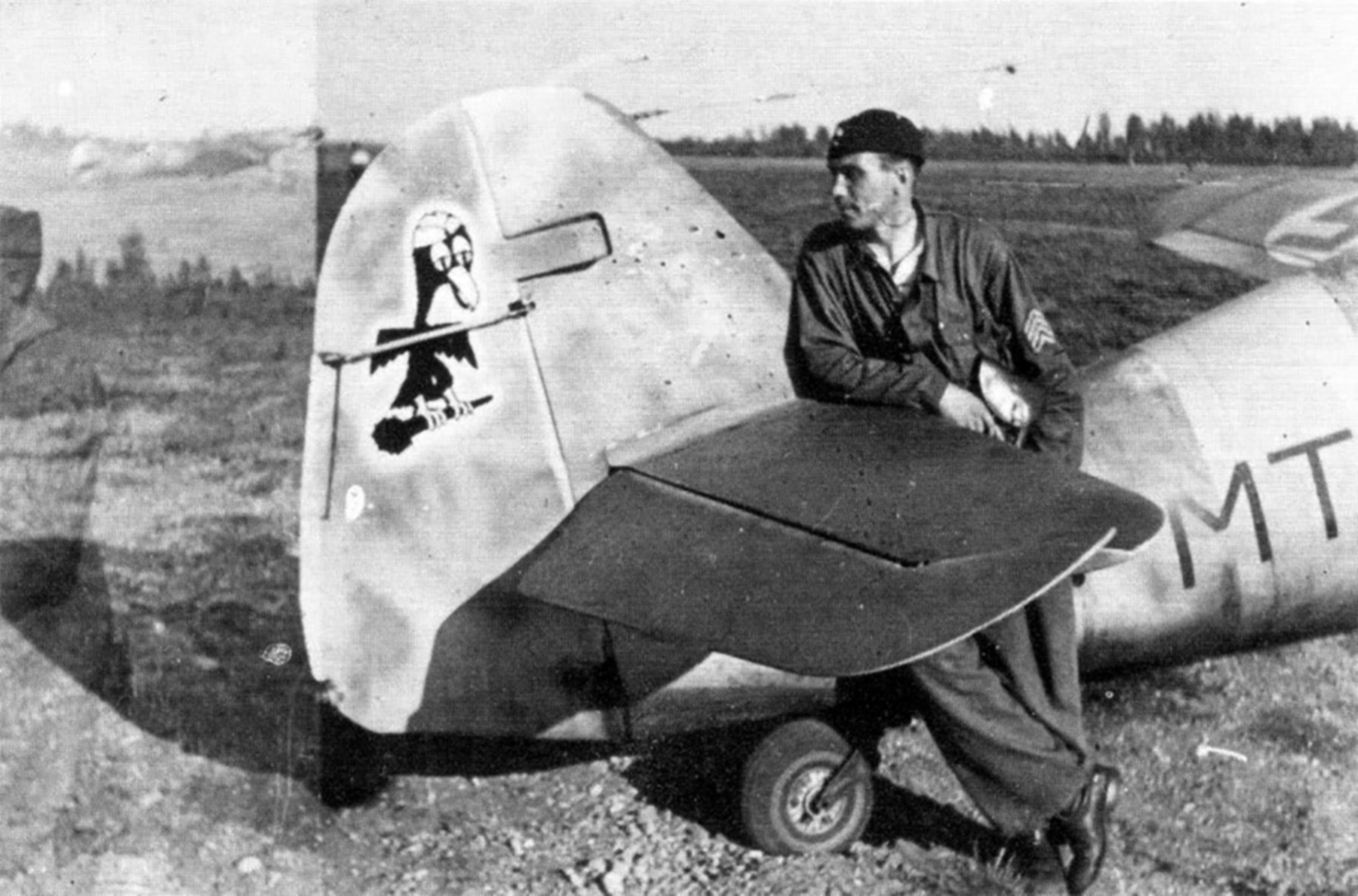

Martinnfb Posted September 30, 2022 Posted September 30, 2022 On 9/30/2022 at 7:51 PM, GazzaS said: Thanks for all of the support. The more I read at TOS written by Radu, the more I realize that the tail was an "effect" that came out clumsily. This is what they wanted you to see. But you can't do that with plastic. For the modeler to reproduce that effect, he would have to have the deft hands of a surgeon and a lot of luck. It could have been done with a 2-piece tailplane. But they went for the one-piece tailplane, making it impossible for us to trim those parts successfully. Expand This museum example is an extreme, flares are bent to oblivion. I wanted to react over on LSP and collected few pictures to support my argument, but withdrew afterwards. Radu open that post for a reason. Few pics of the in service planes. The fitment was actually so tight that on some examples you can often notice a rub marks after frequent adjustments. pay close attention to the scuff mark just to nail it in deeper, here is restored example with undamaged fairing, tight fit in't ? 4 1
GazzaS Posted September 30, 2022 Author Posted September 30, 2022 F*** me, Martin! How do you find these pics? 5

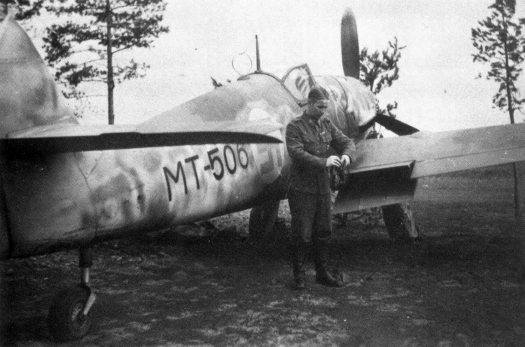

Martinnfb Posted September 30, 2022 Posted September 30, 2022 Another beautiful example. That's not a shadow, it is the original (dark) paint under the flare exposed by adjustment of the horizontal stabilizer. All of this is readily available underneath your fingertips. 🥷 EDIT: on the sidetone, check out the sliding window, that was passing for decades unnoticed. where are the experts now? 2 1
GazzaS Posted September 30, 2022 Author Posted September 30, 2022 On 9/30/2022 at 10:56 PM, Martinnfb said: Another beautiful example. That's not a shadow, it is the original (dark) paint under the flare exposed by adjustment of the horizontal stabilizer. All of this is readily available underneath your fingertips. 🥷 EDIT: on the sidetone, check out the sliding window, that was passing for decades unnoticed. where are the experts now? Expand I wonder if that was a post-factory modification. Check your PM, Martin. 3 1
Martinnfb Posted September 30, 2022 Posted September 30, 2022 That poor thing went through hell already 2 2
