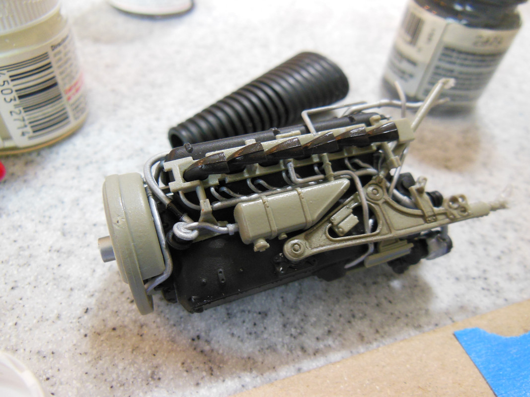

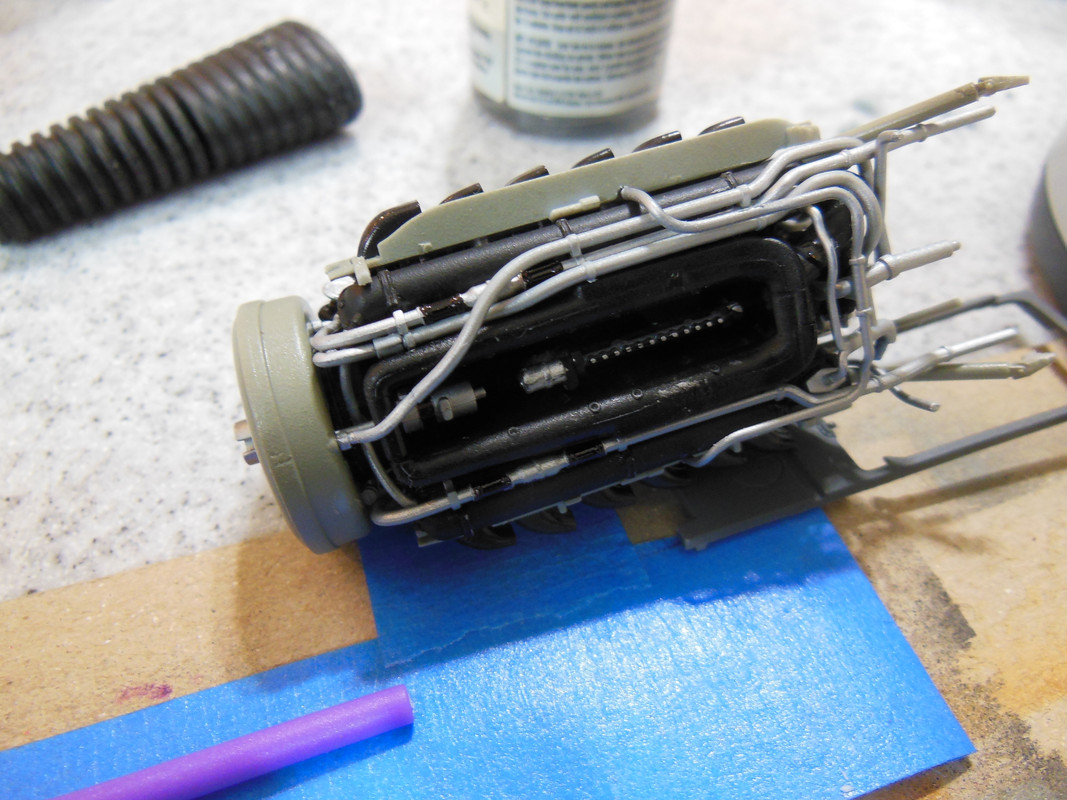

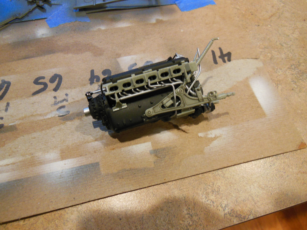

Bill_S Posted September 27, 2022 Posted September 27, 2022 Hernia surgery last week - a couple of days after my local club's show/contest. Lots of time on my hands, so I decided to start this kit. I don't build many Luftwaffe planes; this will be my first 109 since I built Revell's kit as a kid. I'm sticking with Hartmann's mount, and putting all the engine detail on in case I want to display it with engine cowls off. I think I counted 57 parts for the engine assembly. Still some plumbing to do on the engine, but everything fits great! 14 1

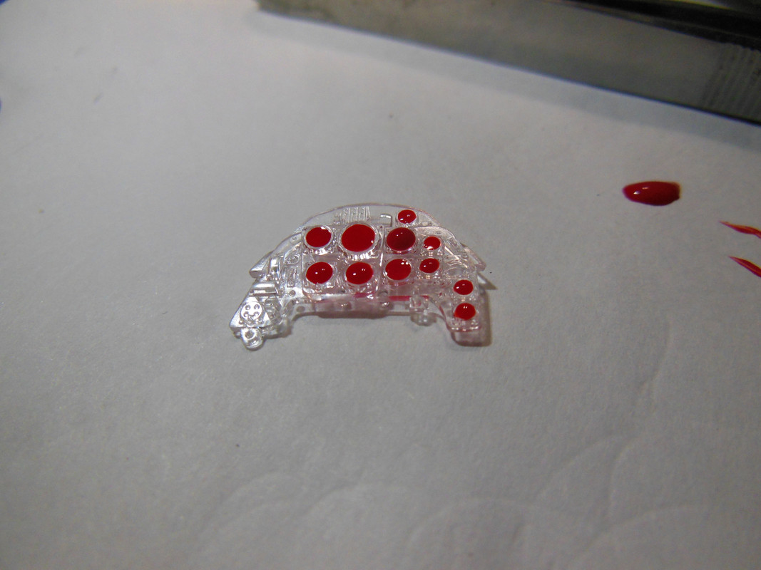

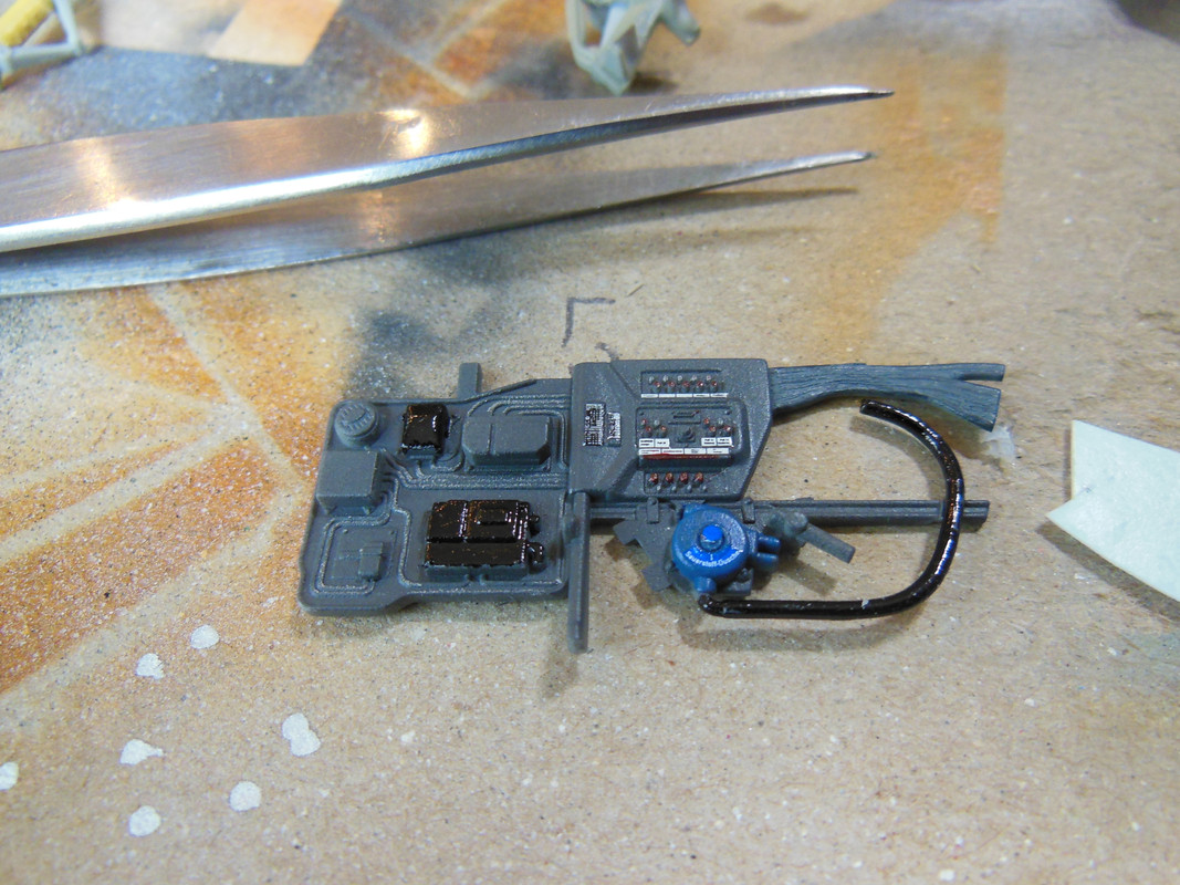

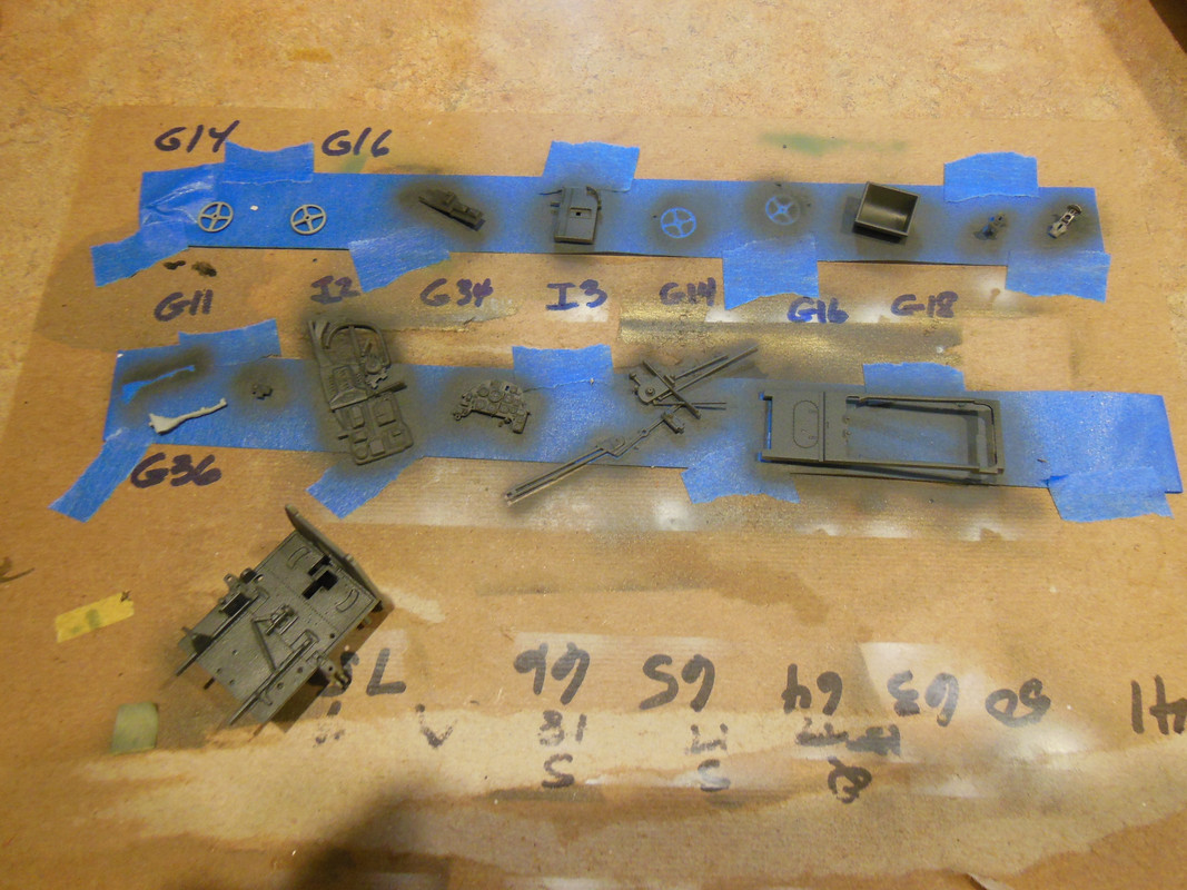

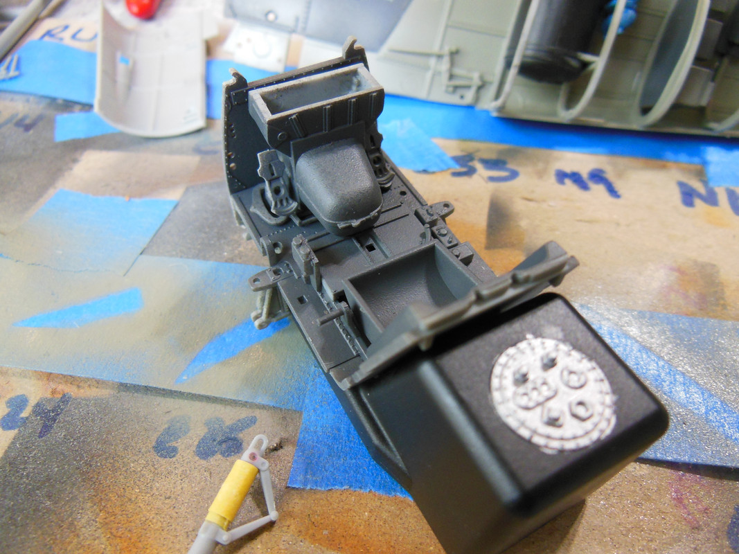

Bill_S Posted October 2, 2022 Author Posted October 2, 2022 Thanks for the kind comments. I got a little sidetracked with the issues experienced by Gazzas... I'm a little farther along than Carl at this point, but I'm certain he'll soon eclipse me. White glue thinned with a couple of drops of red food coloring. It makes a great masking fluid; the red is useful for applying it to the clear IP. The engine (minus exhaust shrouds is complete. A lot of piping; it goes together very well. I masked contact areas between the fuselage halves and the bulkheads to (hopefully) eliminate fit issues when the halve go together. I don't know if it was necessary, but the halves go together without any issues. Quite a bit of the cockpit is done as well. Zero fit issues. 13 1

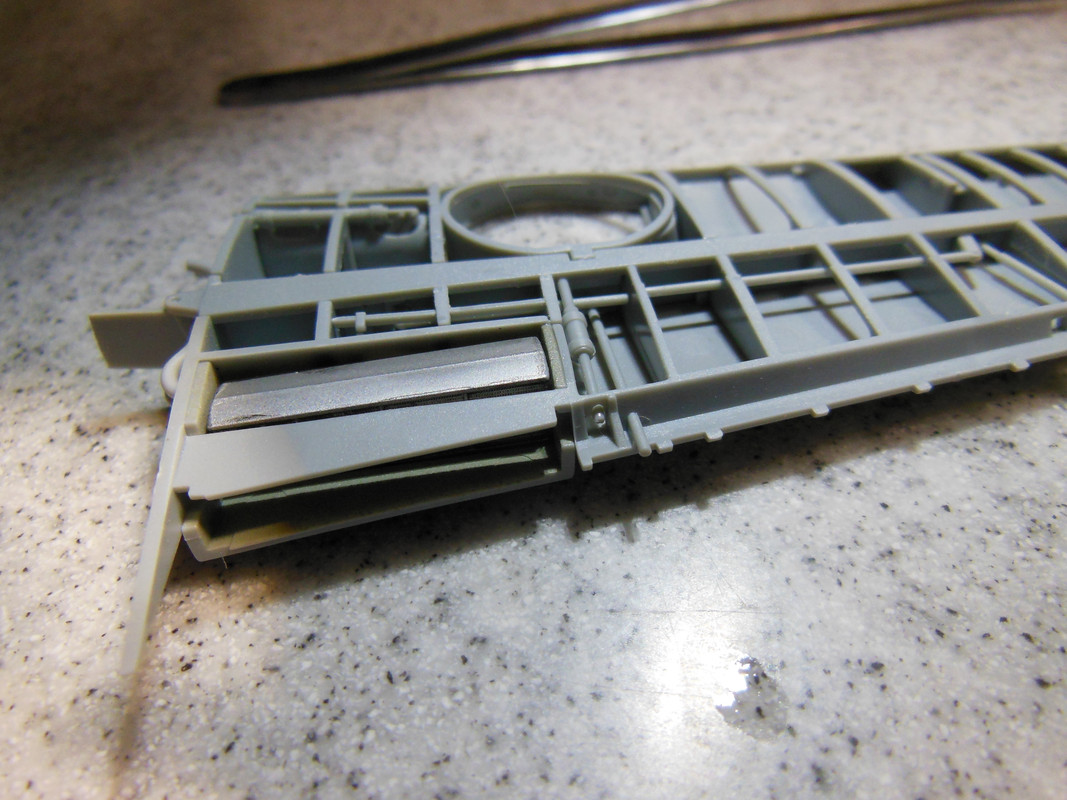

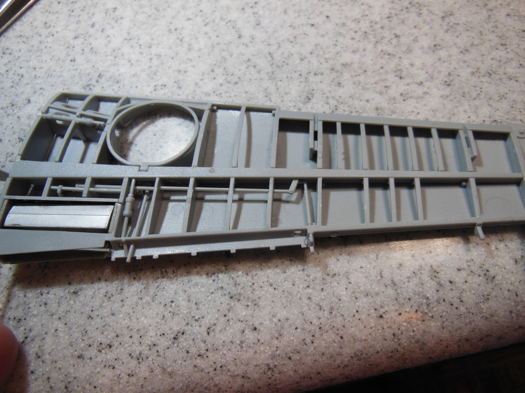

Bill_S Posted October 7, 2022 Author Posted October 7, 2022 One of these days, I'm going to tackle the IP. In the meantime, I've started on the wings. It's a pity it has to be covered. Lower wing panels fitted; no shims involved. I had a little bleed-through of Tamiya Extra Thin, but it's nothing a light sanding won't take care of. The outer rear corner of the radiator sits a little proud, leaving a noticeable gap when I test fitted the upper wing skin. Probably something I did. Five minutes with a sanding stick, and all is well now. Time for a little RLM02 on visible surfaces, and it will be hidden for eternity. 8
