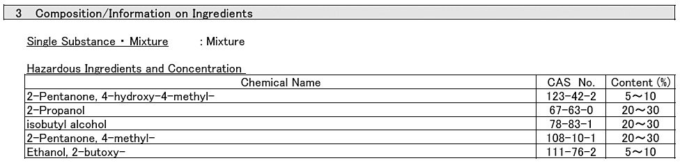

Add MEK to Acetone ( 1 litre about $7) roughly 1:1 and you get Mr Colour Laquer Thinners $40 bucks saved
So, quick question.  Did you pull the data sheet on Mr. Color for this info?  The reasons I ask is when I was a paint and bodyman in my past life, we had 4 different levels of lacquer thinner.  A low grade clean up/primer thinner and hot or fast, medium and cold or slow that you would select based on your desired drying time and weather temps.  Mr. Color is a slow dry that allows the paint to flow.
I also pulled this off line:
Lacquer thinner may include a combination of the following solvents:
  • toluene.
  • xylene.
  • methyl ethyl ketone.
  • acetone.
  • butyl acetate.
Now it obviously says “May” contain.  I’m just wondering which chemical speeds up or slows down drying times, or is it a ratio difference?
  • toluene.
  • xylene.
  • acetone.
  • butyl acetate.
  • toluene.
  • xylene.
  • acetone.
  • butyl acetate.
