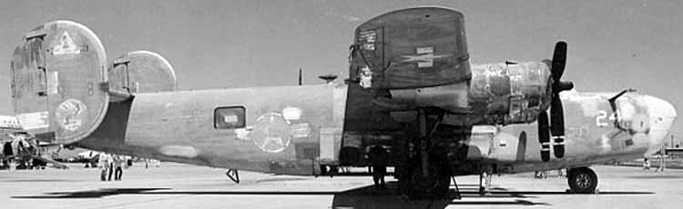

zavod44 Posted January 9, 2019 Posted January 9, 2019 How close to the wartime look? Is this pretty well restored? Can I use this as reference to build my model? Whats missing and what shouldn't be there?
Martinnfb Posted January 9, 2019 Posted January 9, 2019 As close as you can get. Exterior was naturally restored. 42-72843 was built at Consolidated San Diego as B-24D. Assigned to 512th Bomb Squadron. Flew 56 missions between 20 September 1943 and 10 June 1944. Named as "Strawberry Bitch" at Herington Air Force Base by Flight Engineer Sergeant Haberman. Nose art painted at San Pancrazio, Italy. Stored at Freeman Field, Illinois after WW2. Purchased by National Museum of the USAF in May 1959. more here before restoration 1
zavod44 Posted January 9, 2019 Posted January 9, 2019 I've seen the outside at the museum, but that reference is pretty good. I noticed a piece of plywood behind the pilot seat but it doesn't seem to be on the other side behind the co-pilot. You think that's original? Just curious
Martinnfb Posted January 9, 2019 Posted January 9, 2019 good point, I don't know. here is a war-time picture showing plating behind the pilot sear, rather metal, then wood. 1
zavod44 Posted January 9, 2019 Posted January 9, 2019 Lots of things can change between now and then...... 1
1to1scale Posted January 9, 2019 Author Posted January 9, 2019 48 minutes ago, zavod44 said: I've seen the outside at the museum, but that reference is pretty good. I noticed a piece of plywood behind the pilot seat but it doesn't seem to be on the other side behind the co-pilot. You think that's original? Just curious i beleive the D's came with a full wall, but, later planes were open on one side, plywood square on the other. 1
1to1scale Posted January 9, 2019 Author Posted January 9, 2019 32 minutes ago, Martinnfb said: good point, I don't know. here is a war-time picture showing plating behind the pilot sear, rather metal, then wood. that photo is of a very early D, it was from a Life magazine article of the 8th AF. But keep in mind, these bombers were built in 5 different places, with parts from other plants, there was reason they called them a consolidated mess. They would have been a lot of variation between planes, but I have really only seen photos of early D's with the full bulkhead. 2
