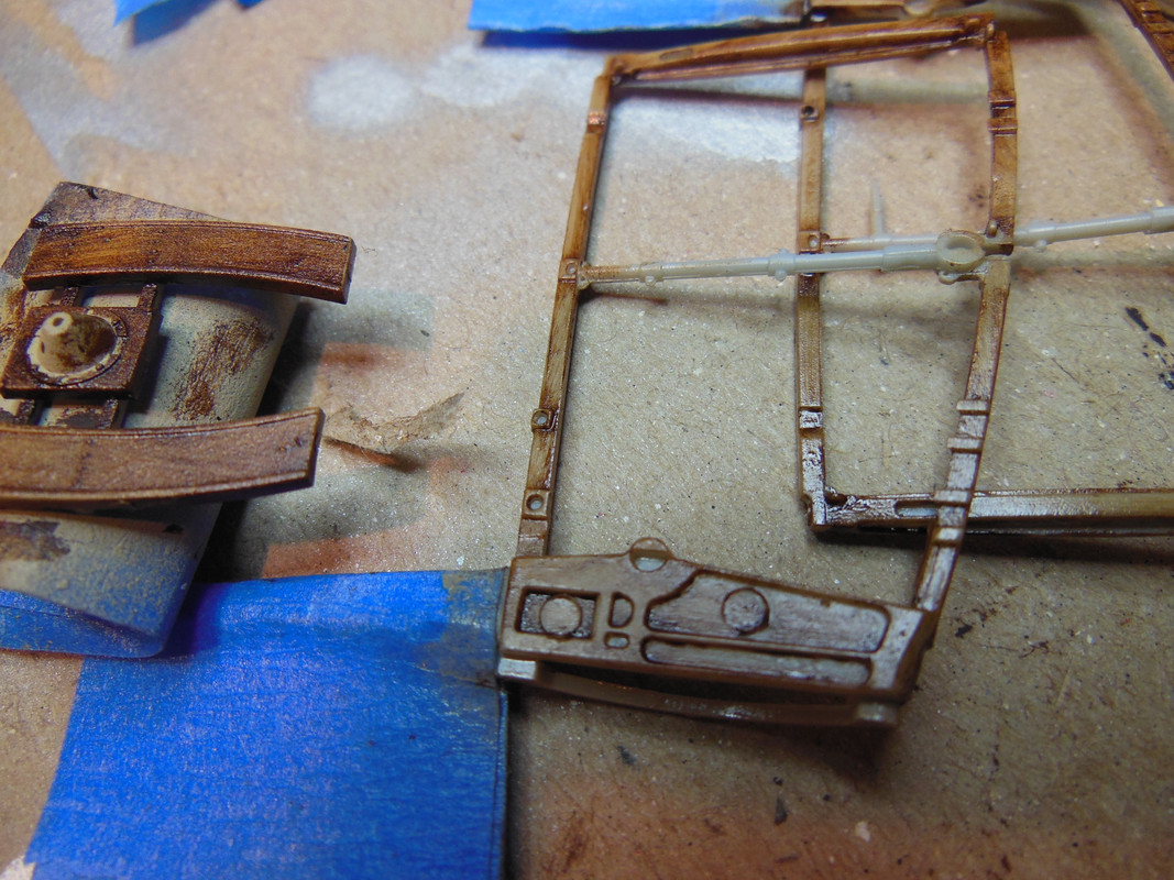

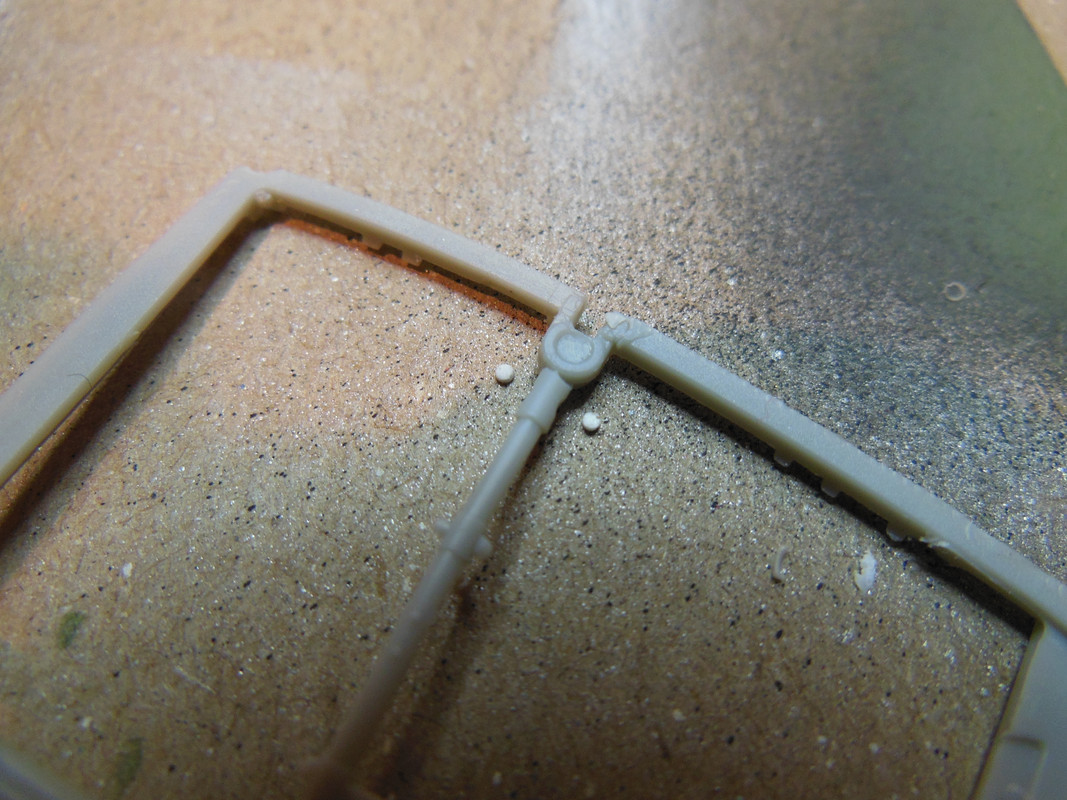

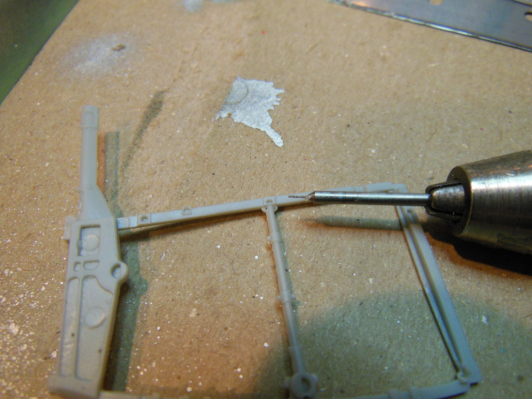

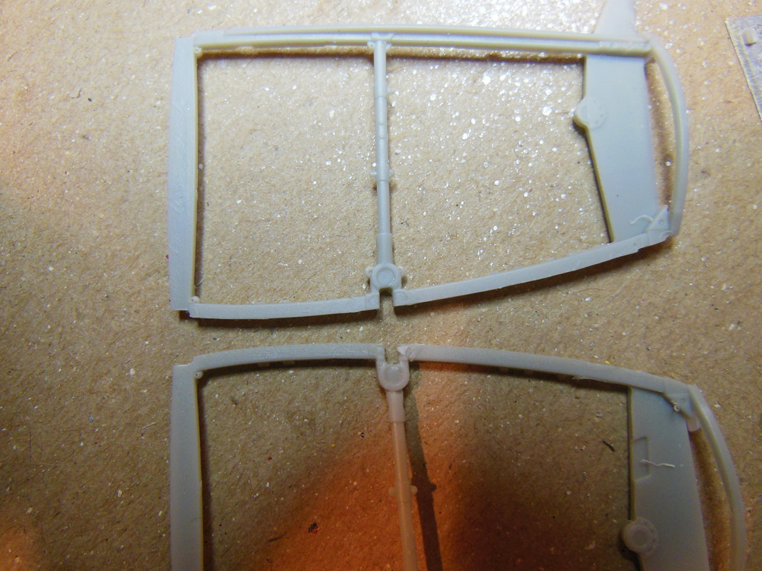

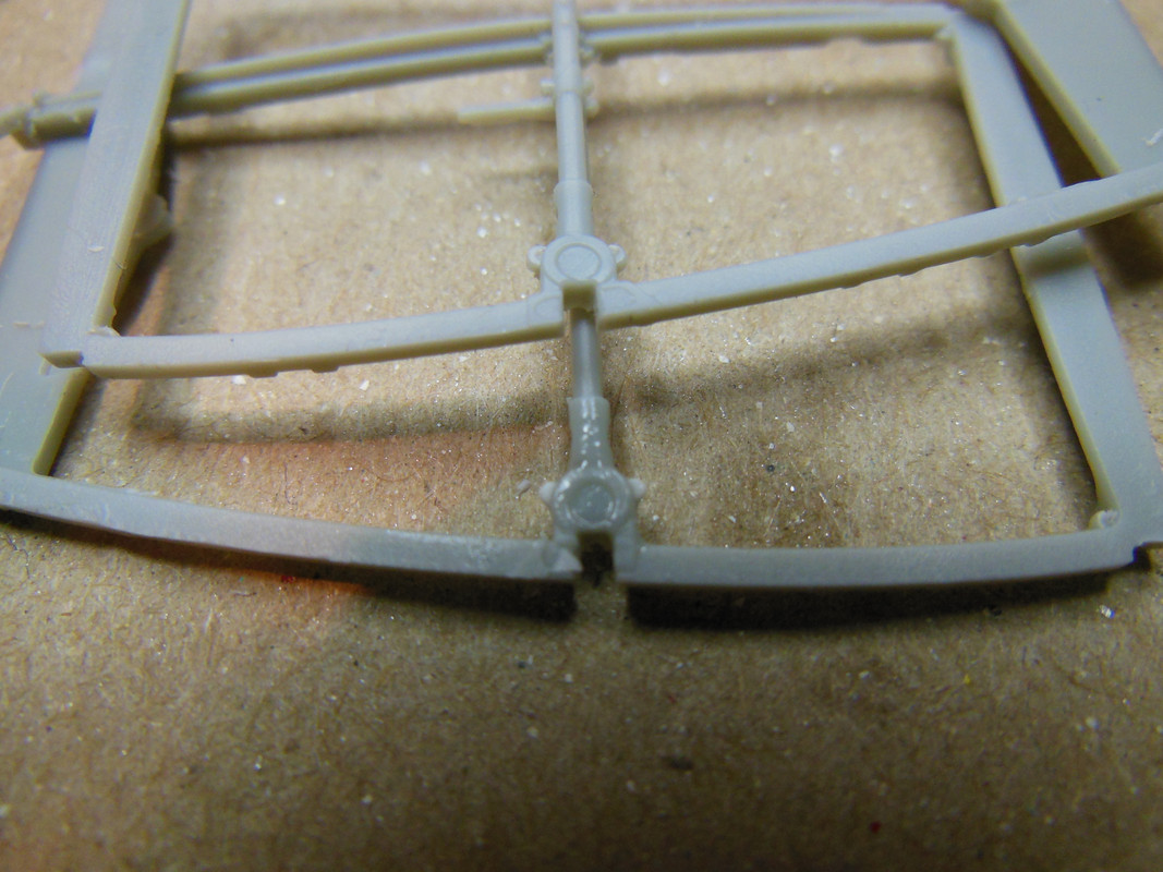

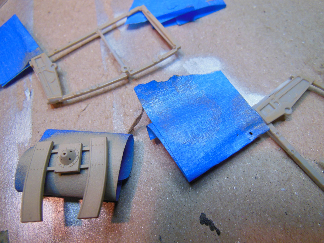

Bill_S Posted January 4, 2019 Posted January 4, 2019 I started this WIP over on LSP; it's only right that I share it with my other family... A shot of the box. My first impression: this kit is very near Wingnut Wings caliber. I do, however, find myself cleaning up a lot of parts - particularly at the parting lines. Only four sprues, but two of them are very busy. Acetate film for the windscreen (I've read that it's pre-cut) and a smal PE fret are included as well. The instruction manual is very good - if it gave other than generic paint callouts (ie. "medium blue"), I would rate it as excellent. Cockpit framing. Some very slight ejector pin marks, but they'll be fully covered. I had to drill holes for bracing wires. The first mistake I've noted: ears are missing at the base of the center vertical on one side. Out with the Waldron punch (0.028 inches) and some styrene sheet. A little trimming and some cement, and we're good to go. Various Tamiya tans as an undercoat... Then a heavy coat of Windsor & Newton burnt sienna An hour or so later, the excess is removed with a cotton bud. 12

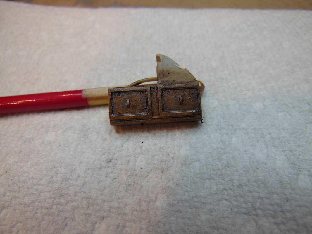

Bill_S Posted January 5, 2019 Author Posted January 5, 2019 Slowly but surely - lots of detail painting. 8

GusMac Posted January 5, 2019 Posted January 5, 2019 Nice use of the oils Bill. Gives a lovely patina and wear. 2

BlrwestSiR Posted January 6, 2019 Posted January 6, 2019 Looks great Bill. And thanks for showing your techniques for painting wood. Carl 3
GazzaS Posted January 6, 2019 Posted January 6, 2019 Nice wood effects! That's one part that befuddles me: Getting a good wood look on narrow frames. 3

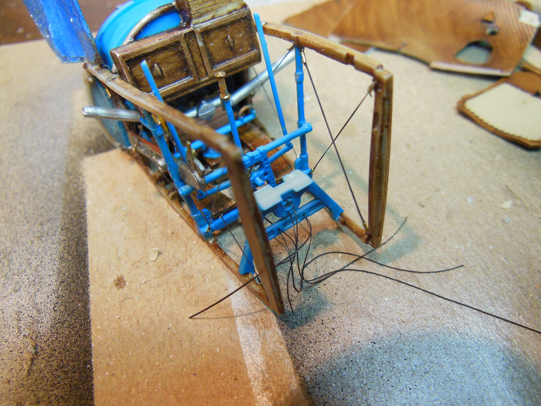

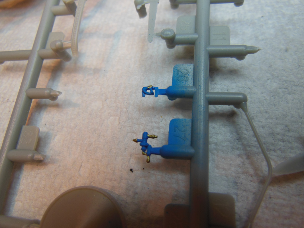

Bill_S Posted January 7, 2019 Author Posted January 7, 2019 A brief update. Finished the bracing wires on the cockpit frames; Some painting on control detail. There are a couple of parts still to add; I painted them on the sprue. I'm finally at a point where I can assemble something! Next up: Rudder pedal assembly, control stick, then the seat. Stay tuned. 6
DocRob Posted January 7, 2019 Posted January 7, 2019 Looking good, what a pleasant surprise to the eye to see these colorful cockpits, compared to a RLM 66 dull workplace. Nice work on the details and rigging. Cheers Rob 3
Bill_S Posted January 7, 2019 Author Posted January 7, 2019 DocRob, I suffer from mild color blindness - that's my take on "medium blue". It's Tamiya X-14 Sky Blue mixed 2:1 with X-21 Flat Base. 2

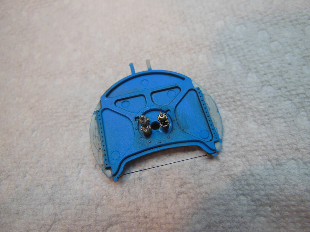

Bill_S Posted January 18, 2019 Author Posted January 18, 2019 Trying to finish up the cockpit; I'll post more pictures shortly! 2
Bill_S Posted January 18, 2019 Author Posted January 18, 2019 Some more wood effects... I still have to add some cross bracing wires once the back panel is attached, then thread the control cables through tiny holes drilled in pulleys. 3
