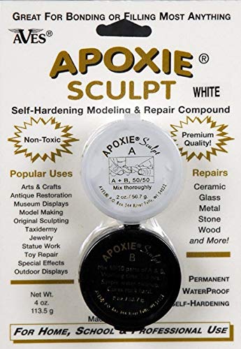

Administrators Clunkmeister Posted June 25, 2019 Author Administrators Posted June 25, 2019 OK, a slight minor two minute last ditch modification. (Translation into LSMish: a Contributor noticed something I missed.) The thingamadorfer on the portside bomb bay doubler had to go. FM104 didn’t have it, so, out with the magic #11, trim trim trim, and stuff the hole full of Apoxie. Total collateral damage is a couple chips on the aluminum overspray that’ll be covered in Voodoo grey in a couple days. Has anyone else had any issues with Apoxie Sculpt? It doesn’t seem to want to harden at all, even after a month. I mean, good grief, I’ve already used almost all of it and it’s still soft. Maybe I’ll have better luck with the second container of the stuff they give. I dunno, but it’s maddening. 5
GazzaS Posted June 25, 2019 Posted June 25, 2019 Ernie, Pardon me if I misunderstood what you wrote about Apoxie Sculpt. If I understand what you've written, you've only used half of the two-part mixture? One part will have hardener just like Bondo. Gaz 4
Anthony in NZ Posted June 26, 2019 Posted June 26, 2019 Totally loving this build Ernie!! Awesome work buddy 2
Ryan Posted June 26, 2019 Posted June 26, 2019 I haven't had this trouble with A-Sculpt Clunk, damn models...its little things like this that keep us on our toes. Is it super glue time? Ryan 1
Administrators Clunkmeister Posted June 26, 2019 Author Administrators Posted June 26, 2019 1 hour ago, Ryan said: I haven't had this trouble with A-Sculpt Clunk, damn models...its little things like this that keep us on our toes. Is it super glue time? Ryan I’ve never used it either, Ryan. Decided to try it for a change. I used the stuff in the dark color container because it better matched my chosen grey. After several days, it’s as soft as it was when I put it on! Maybe I’ll have better luck with the other container they give, the white one, I dunno. I’ll try the other container, the white one next. Maybe I missed something? I’m getting old, you know. And being in Texas an’all, sun baked bald head, wind whipped face, probably sustained damage over the years.... 1
harv Posted June 26, 2019 Posted June 26, 2019 You have to mix the two together Ern ! Its TWO part. Stuff ya goof.......harv 1
