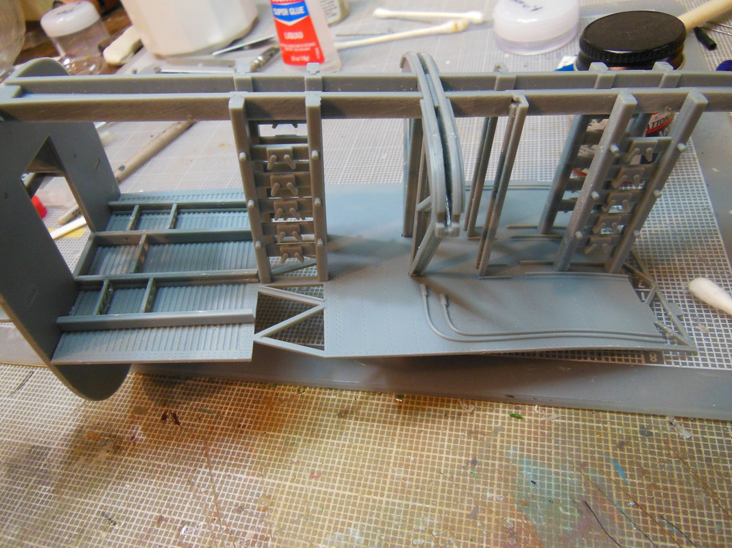

Bill_S Posted November 7, 2019 Posted November 7, 2019 When this kit was first announced, I knew I had to have one. I want to represent a plane that took part in one of the Ploesti raids. I'm unsure what markings will be on this bird, but it won't be "Wongo Wongo" - that plane was lost before it made it to the target. By the time I get to decals, my hope is that someone will release something that piques my interest... The plan: I'll be working on this plane while simultaneously trying to make a dent in my SOD, so it will take some time. As far as aftermarket, the only plans I have are an Airscale IP and HGW belts (no belts of any kind are present). I've started on the bomb bay... Fit of the parts is very good - there are a lots of pieces to trim off, though. I did a test fit in the fuselage; I'm impressed with the fit. The color callout for the bomb bay is "Neutral Gray" I'll be using MRP Ocean Gray. 5
