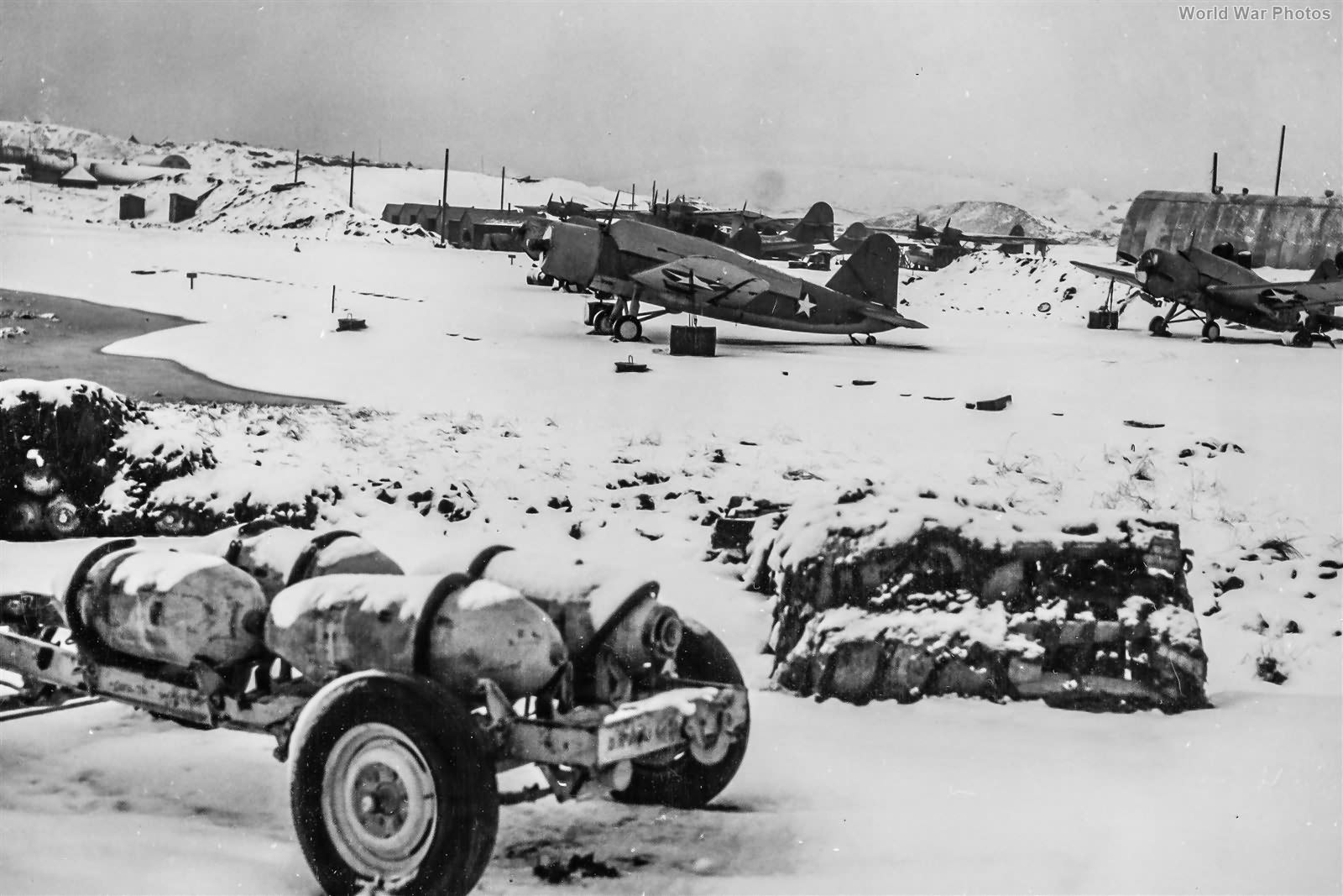

BlrwestSiR Posted February 18, 2019 Posted February 18, 2019 Ok, so my bench is littered with more kits than it should be. What's one more in that case? This has been kicking around in the back of my head ever since I saw this pic in Dana Bell's book on the Kingfisher: Note the postwar style white only star and bar on the fuselage. On the tricolour scheme, it just looks cool. Plus there's the beat up main float. Only problem is I have no idea what the wing markings are like. After conversing with Dana, he wasn't sure about them either. Thankfully there's another pic in his book of a different Kingfisher with the same incorrect insignia. This one at least shows the underwing markings and they're the standard version. I might go with this one as a result. Carl 5

CrankyCrafstman Posted February 18, 2019 Posted February 18, 2019 Those are some pretty weird landing gear I found this on Shapways 3D printed. It's a P-6n catapult as used on US battleships and cruisers. It ain't cheap around $400!!! 7

BlrwestSiR Posted February 20, 2019 Author Posted February 20, 2019 On 2/18/2019 at 10:24 AM, CrankyCrafstman said: Those are some pretty weird landing gear  That looks like the rarely seen amphibious version of the Kingfisher. 2

GazzaS Posted February 20, 2019 Posted February 20, 2019 I had no idea there was a non-amphib kingfisher. Breaking those plastic 'wires' was a blessing in disguise. Sooner or later you'd have looked at em and thought: "They aren't to scale thickness".... "but it's too late".....  "or is it??".....  See.... you saved yourself an entire mental argument with yourself!  Gaz 7

BlrwestSiR Posted February 26, 2019 Author Posted February 26, 2019 On 2/20/2019 at 12:56 AM, GazzaS said: I had no idea there was a non-amphib kingfisher. Breaking those plastic 'wires' was a blessing in disguise. Sooner or later you'd have looked at em and thought: "They aren't to scale thickness".... "but it's too late".....  "or is it??".....  See.... you saved yourself an entire mental argument with yourself!  Gaz Actually, all the Kingfishers had removable floats. They could swap out for the landing gear depending on their base of operation.  3
