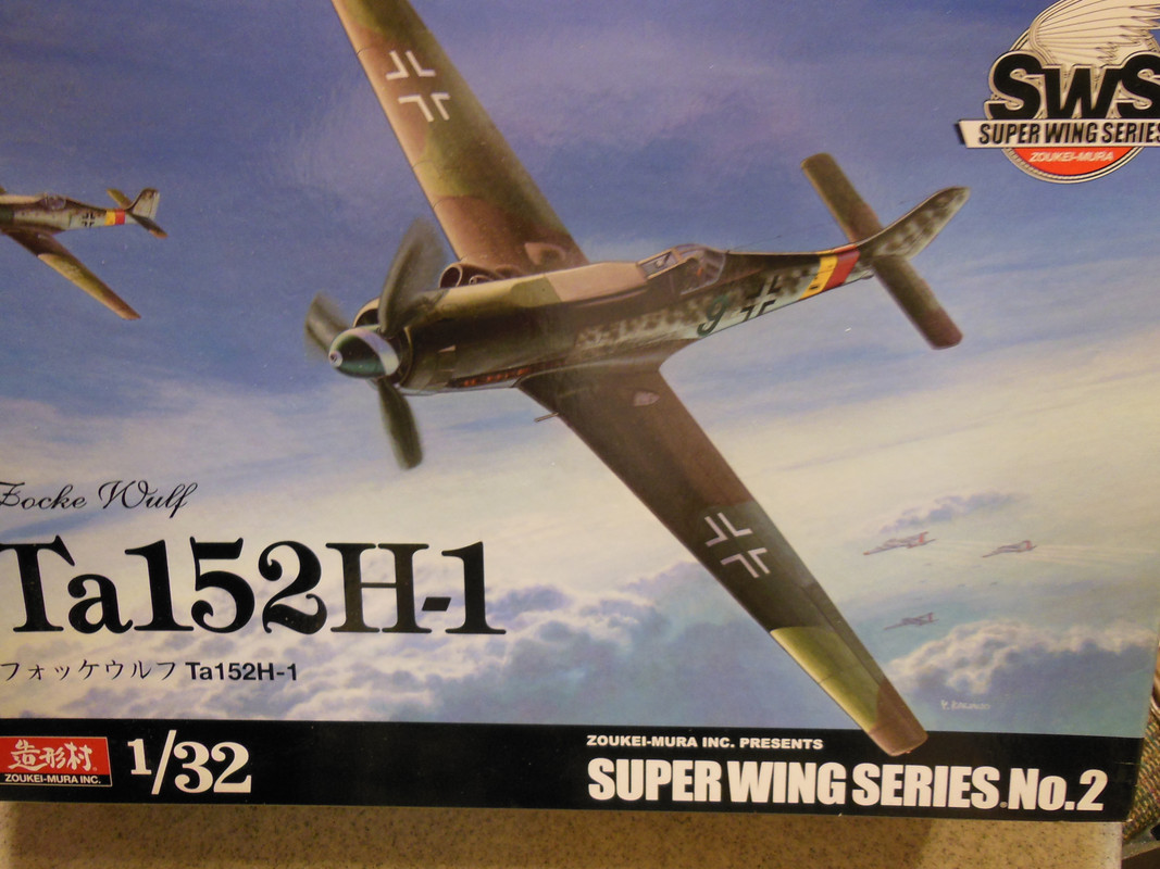

8 hours ago, Bill_S said:
Picked this up at my local contest today!
While I was at it, I snagged these, too.
Good job Bill, was that for the sea plane?
Indeed it was, Ryan. Sadly, I left a couple of planes at the venue, and I won't get them back for a couple of weeks. I'll post some photos then. It was a good show; aircraft were very well represented.
Yes, if you have the time I’d like to see more shots of that model.
The ZM H1 is a good snag since it’s OOP.
